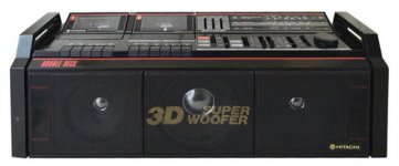

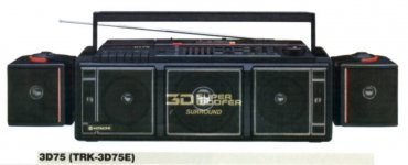

I’m currently in the process of brainstorming ideas to mod one of these:
Into one of these:
Using 2 of these (one at each end):
I haven’t got the pipes yet, so can’t calculate the space it would give, but a very rough estimate is about 5L with an internal diameter of about 100mm.
I was wondering if someone here would be able to calculate the required space for the following drivers:
