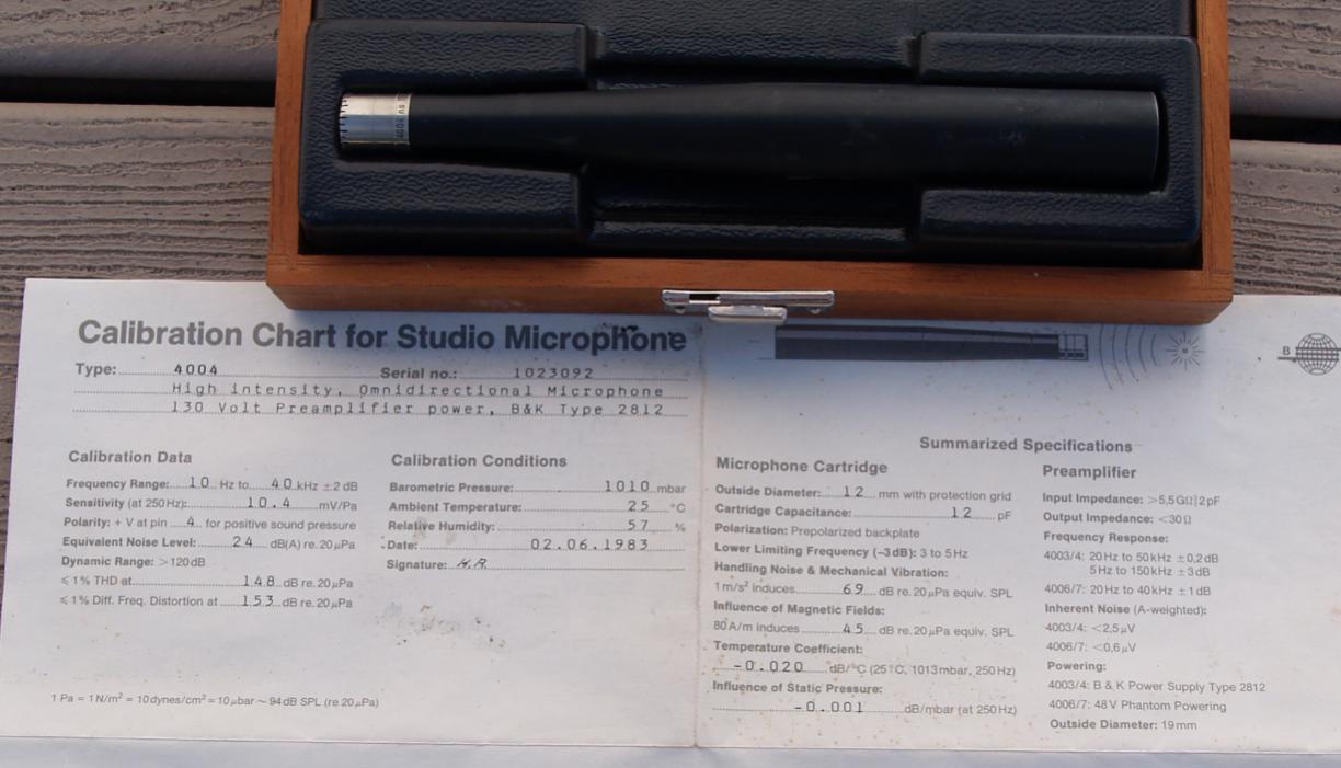

That level also happened to be just about the maximum clean SPL for the B&K 4004 test mic used.

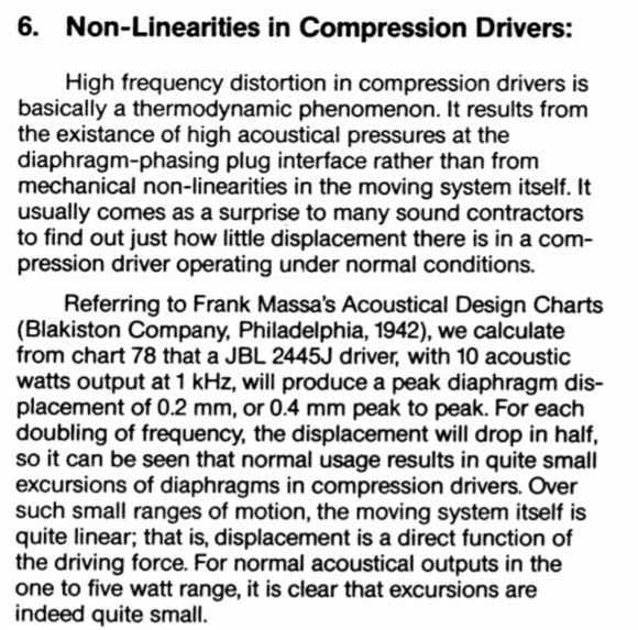

JBL tech notes Volume 1, Number 8 also references Massa's 1942 work.

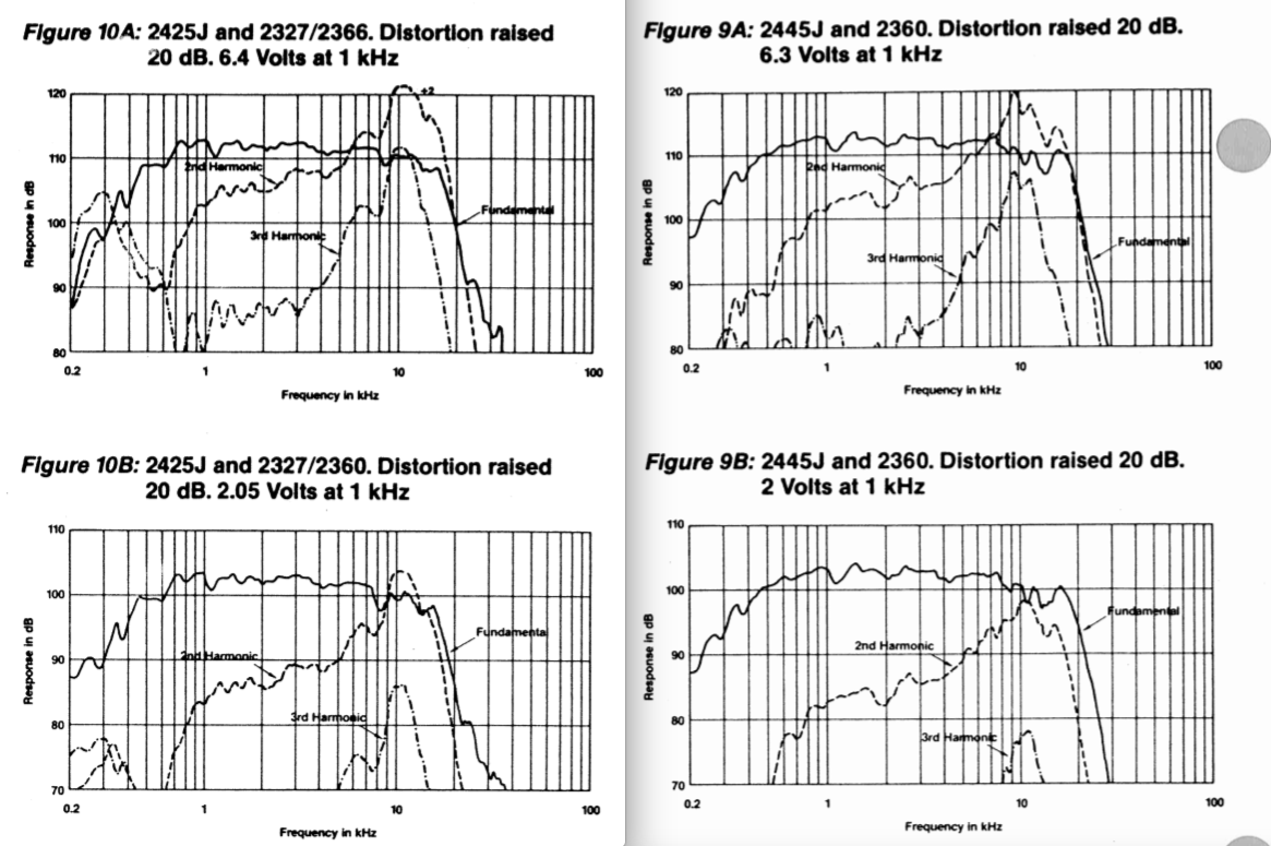

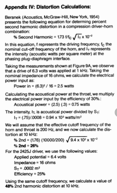

The measured distortion levels of the 1.75"(2425) and 4" (2445) drivers at relatively low drive levels is in agreement with Beranek's calculations.

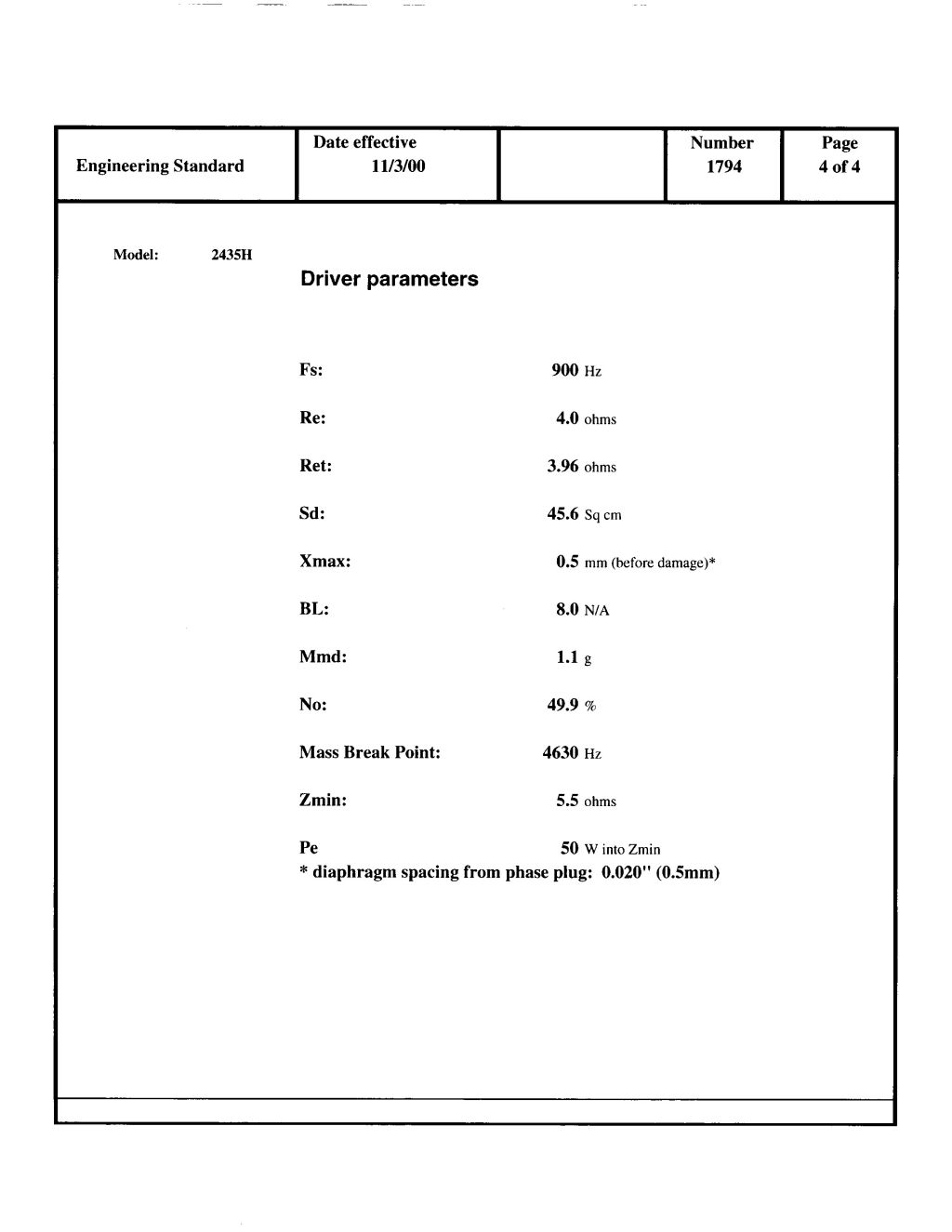

The modern JBL drivers have a .020 mil .5 mm spacing between the phase plug and the diaphragm. Not accounting for the Dome will seriously underestimate area and don't forget about the area of the surround which can be tuned to a secondary resonance.

Hello Art
They call x max .5 mm and spacing is .020 from phase plug this is from the 2431/35 spec sheet. The 476Be also calls out a .5mm xmax. but doesn't specifically say what the spacing is. Could be different between the 3" vs. 4" drivers
Rob:)

I think 18 Sound made an error in that guide. A different version shows .5 -.6mm for the smaller diaphragms. Up to .75mm if necessary.
0.9-1.0mm for the 4". Up to 1.2mm if necessary.
