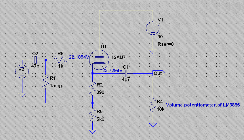

OK. Let's talk about ECC88 then. What would be resistors values for it? Load impedance 980 Ohm, source signal CD or iPod. 90V anode supply. Same schematics:
You need to specify what your aim is i.e. how much distortion on signal peaks? If your aim is 'as little distortion as possible' then you wouldn't be using a tube buffer into such a low impedance. Knowing how much distortion you want, you can then choose a load line which will provide it.gooduser said:OK. Let's talk about ECC88 then. What would be resistors values for it? Load impedance 980 Ohm, source signal CD or iPod. 90V anode supply. Same schematics:
Rough guide: a well-biased ECC88 CF will have an output impedance of about 80-100 ohms. With a load around 1k you need to design a grounded cathode stage with about ten times the distortion you want from your cathode follower. For an ECC82/12AU7 the figures would be around 500 ohms and about three times the distortion you want from the CF.
What about 0.1% distortion? 😕
And increasing Z load to 4k?
ideally Rk like a plate load resistor, should equal 2Xrp at the operating point - that's an awfully low Z but not a lot of voltage to swing
Mmmmmm, not sure if I understand..... What do you refer to by Rk and 2Xrp?

The 22uF electrolytic is connected backwards.
Many possibilities, can you post a schematic of the supply, and post a few pix of the layout?
A 0.1uF in front of the CF would be sufficient as well. !!C2 is shown connected backward!!
Not sure why you went for an inverting input configuration, driving a 3.3K load is a pretty big deal for your 12AU7A, I am not certain it can provide the required current. A non-inverting configuration makes more sense and would probably result in less output offset. For minimum offset R6 should be in the vicinity of 24K, which will result in significantly more noise than necessary.
