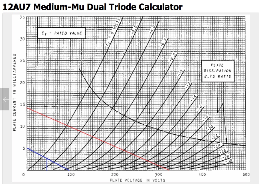

Need help calculating resistors for cathode follower. Here is schematics:
Power supply will be 90V.
My estimate values:
RL = 3 kOhm
RB = 200 Ohm
RG = 100 kOhm
Cin = 2uF
Cout = 2uF

For close to 45V on cathode, Rb=390r and Rl=18k
From:
Ignore the red line, I just "borrowed" this graph from another page.

Essential design information missing. Maximum signal level and load impedance.
45V is half of your 90V B+. Generally the best place to start. Blue line.
Load impedance 980 Ohm, max input level - CD or iPod
Hope you like distortion.
ideally Rk like a plate load resistor, should equal 2Xrp at the operating point - that's an awfully low Z but not a lot of voltage to swing
I'm assuming I should either increase voltage or load resistance? What would those be for operating without "distortion"? Thank you.

The signal level is low and can be handled with a cathode follower having 90 V supply voltage, but the impedance is not suitable.
So whai is the device after the cathode follower ?

Then, I would use the non-inverting input of LM3886. So you can get suitable load impedance to the cathode follower.

If there is no solution for inverting schematics, I will go with noninverting. But I kind of want inverting variant. I studied lm3886 application note and also lm4780, which is two lm3886 in one chip, pg 23 has the inverting schematics.
Just noticwd that with noninverting variant Cout for cathode follower can be much smaller than with inverting. Kind of tempting to use it... 🙂
Now I consider Cout as 20uF (for inverting 980 Ohms load)
