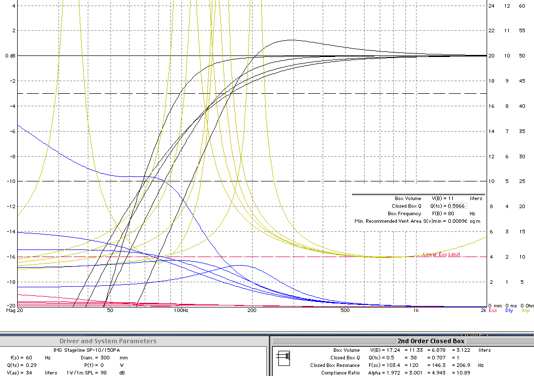

I am building a cabinet for these but am a little surprised that the calculated volume I get after I have run the numbers through several different calculators is so low (11-12l). Some give me dimensions that won't even encompass the length of the port that it needs. Am I missing something?

This is intended for midrange. Look at the xMax. Low Vas , Qt sacrifices bass extention for efficiency.
I’d put it in sealed 6 litres (damped) and XO at or above 150 Hz. 300 Hz would be better.
