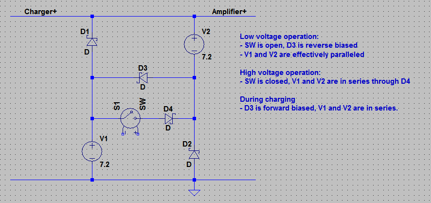

Idle consumption is typically very important. TPA3118 is quite good in this respect compared to similar amps (~50W 2ohm), but if you use it at 8 ohm, 8W, then the ratio of output power/idle loss becomes worse. You can decrease idle loss significantly by halving supply voltage (according to datasheet it operates from 4.5V), and at the same time you can get the same output power at 2 ohms load. By using only 3 diodes and a switch you can arrange 2 battery packs in a way that they can give for example 7.2V 4Ah in one state and 14.4V 2Ah in other state of the switch. This way you can choose any time between long time running and high power, as the loudness demand dictates. Additionally in this arrangement balancing between the two packs happens automatically when operating at low voltage, and still you can charge them whenever you want with a 17V stabilized, current limited charger. And at lower setting the amplifier will shut down before serious overdischarge may damage cells.

I'm intrigued by the dual battery pack idea. I've been pretty intimidated by the Li-Ion batteries and their need for balanced charging and over/under charge protection. My NiMH packs just needed a circuit to detect voltage slope to prevent overcharge and that was it. Well, i actually put a thermister on a few of them as a back-up stop in case the voltage slope was missed. Anyway, can you explain more about how the 2 battery packs arranged like you describe will balance each other?

Balancing means making voltages equal (theoretically the charges should've been equal, but this can not be achieved directly). In low voltage mode a pack thats voltage is somewhat higher will provide higher part of the load current, as long as the voltages don't become equal again.
Within a pack the 2 cells are not balanced yet, but there are many matched pairs available that don't require further balancing...
SW can also be a voltage controlled switch, fed from output through a peak rectifier, this way it can switch automatically to high voltage mode when needed by high music peak voltage.
