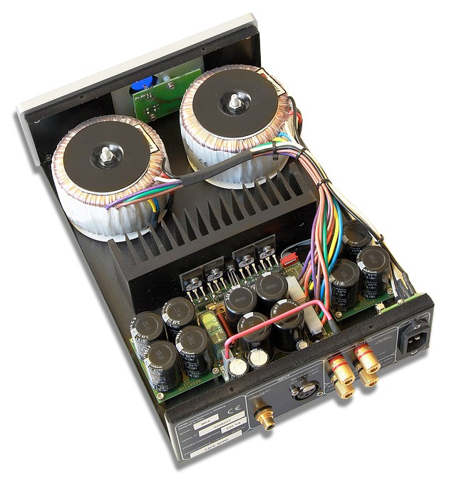

it's my first post here on diyaudio forum, so hello for everyone!
@RM could You please send service manual for Cairn Mea (North Face version on my e-mail address charles.enak@gmail.com?
Mea utilizes same fets as 4808A. Unfortunately i had to replace them with new version IRFP150/9140N (burned out), because IRFP150/9140 are no longer available. It,s working, but now I'm not sure about quiescent current.
Thanks in advance!

I see... Thats pity.I don’t have service manuals. They never made any. I have only schematics. But no NF.
Maybe You want to sell those original fets You mentioned?
If they are matched, then I may be interested 🙂
I matched my IRFP150/9140N(PbF) fets using Mr. Pass method described in this article: https://www.firstwatt.com/pdf/art_matching.pdf
Everything is working pretty good with quiescent current adjusted to ~150mA (~71mV around emitter 0R47 resistors), but I'm not sure if that was exactly factory setting of bias.
Heatsink runs about 56 Celsius degrees, fets runs about 61 Celsius degrees, and 150mA is pretty stable for normal and louder listening.
Mea utilizes two pairs of IRFP150/9140 - maybe there were similar builts, integrated amps maybe, and maybe quiescent current be the same for those amps?

What do you mean by re-design the present circuit? I was talking about Mea Monoblocks, not K5 amp, and not Classe A construction but the NF ones, and IMO they are a very good construction:The only way to get a good reliability is a complete re-design of the present circuit - the retention of the original condition does not lead to a permanent operation in the right manner.
With the existing heatsink size, it is not possible to operate with the intended supply-voltage.
As i said above - 56C on heatsink with 150mA quiescent current. IRFP150/9140N (5-th generation) got a little bit different specs as IRFP150/9140 (3-th generation). Probably 3-th are better for audio use (lower RDSon), but they are no longer available on stock (mouser , digikey etc.), so i used the N version, and with success I think. But still I'm not sure that 150mA.
