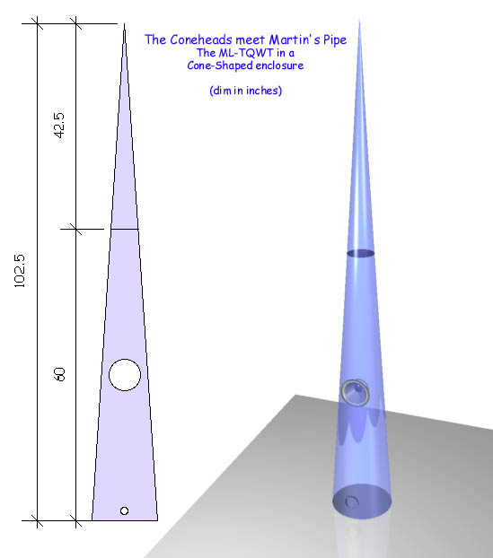

TQWP with Circular Section ?
Just wonder if any one (Mr. Cain?) has tried a tapered pipe with circular cross section, in which case the area would change quadratically (rather than linearly) with pipe length.
Any advantages / disadvantages ?
Thanks in advance,
Patrick
Re: TQWP with Circular Section ?
Why would the taper not be linear?
Andy got the Conehead using translam before he set the project aside (forever he says but you never know)
dave
Re: Re: TQWP with Circular Section ?
The taper (increase in diameter with length) would be linear, but the cross-sectional area A=(pi)*r^2 would be quadratic with length. (Seems weird to me too, but the math don't lie.)
Should be able to sim it in MJK's sections worksheet, approximating a quadratic profile by using many different linear sections?

In most cases, when you're changing the cross-sectional area of a speaker, only one dimension is changing. Say, rectangular baffle and triagonal side. Let h be the distance from the top of the "pipe", with a cross-sectional area (CSA) of zero at the top, then
x = constant (the baffle is the same width throughout)
y = c * h (the width of the side is linear with the distance from the top)
CSA = x * y = c * x * h linear with distance from the top
For a cylindrical pipe where the radius is linear with the distance from the top,
r = c * h
Then,
CSA = pi * (c * h)^2 = pi * c^2 *h^2 quadratic with distance from the top
You could get the same thing by building a square pyramid...
In any case, I think you could use MJK's sections program, and enter a number of sections with linear increase in CSA but increasing "taper" to approximate a quadratic increase in CSA.

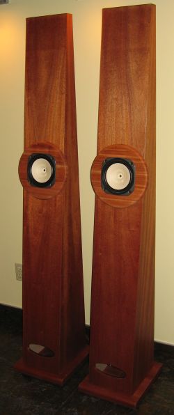

Hello,
I finally finished my Clabby. See the attached picture. They sound great! I may have a chance to compare them with the real Abby at the Hi-Fi Montreal Festival in april. Usually there is a room with the Abby and I always spend a lot of time in it.
I decided to ignore a bit all the calculation I did with MJK sheets and also take into accound the dimensions of the real Abby. It is a compromise between both design.
Just for fun, I tried to use a BSC and it completely destroyed the mid-range. Basically I was using a very similar version of the BSC used by MJK for his FE164 project.
I am now using them with a pair of ASL wave-8. Honessly I prefer this match over my Pass Zen V4. I will probably build the first version of the Zen (apprently better for full-range speaker?) or maybe the Zen Lite is better?
Anyway, I will have to do some experiementation.
Nothing special in these speakers: FE167E, silver-plated copper wire with teflon insulation, high quality binding post (but not the cardas), 5/8'' MDF, African Mahogany veneer finished with danish oil.
