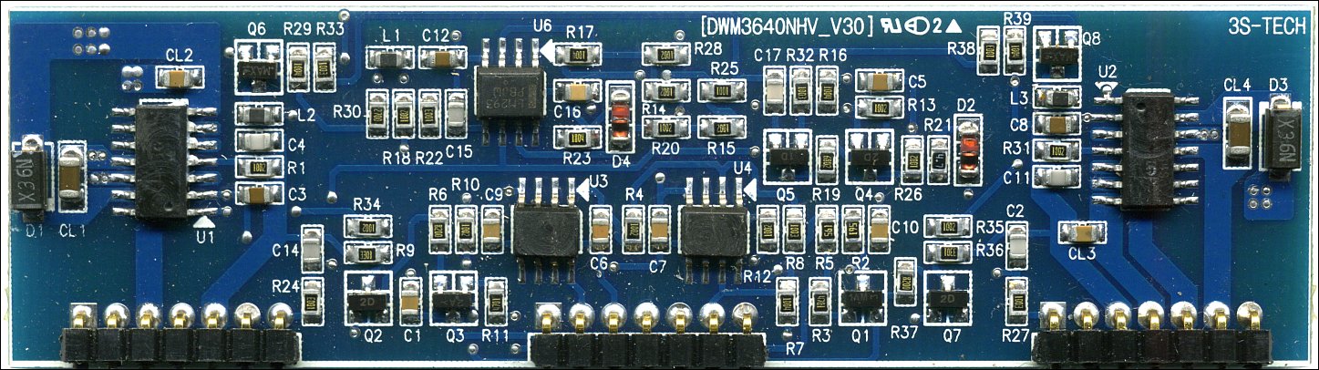

How about Perry the number of pins match? That driver board is compatible so I think I have some out there thanks.

I annoy you again with this amplifier since I feel that the fault is in the driver board, the output transistors get hot I can not tell you how many degrees because I have nothing to measure the temperature but the touch with the fingers can not be touched because Burn I changed the ir21844s and the tl072 that were absent in the card I had there is oscillation in the output transistors, I measured all the resistances in the gate of the mosfet and they are in the correct value. What do you suggest me to review I thank you since I don't have much experience with class d amplifiers.

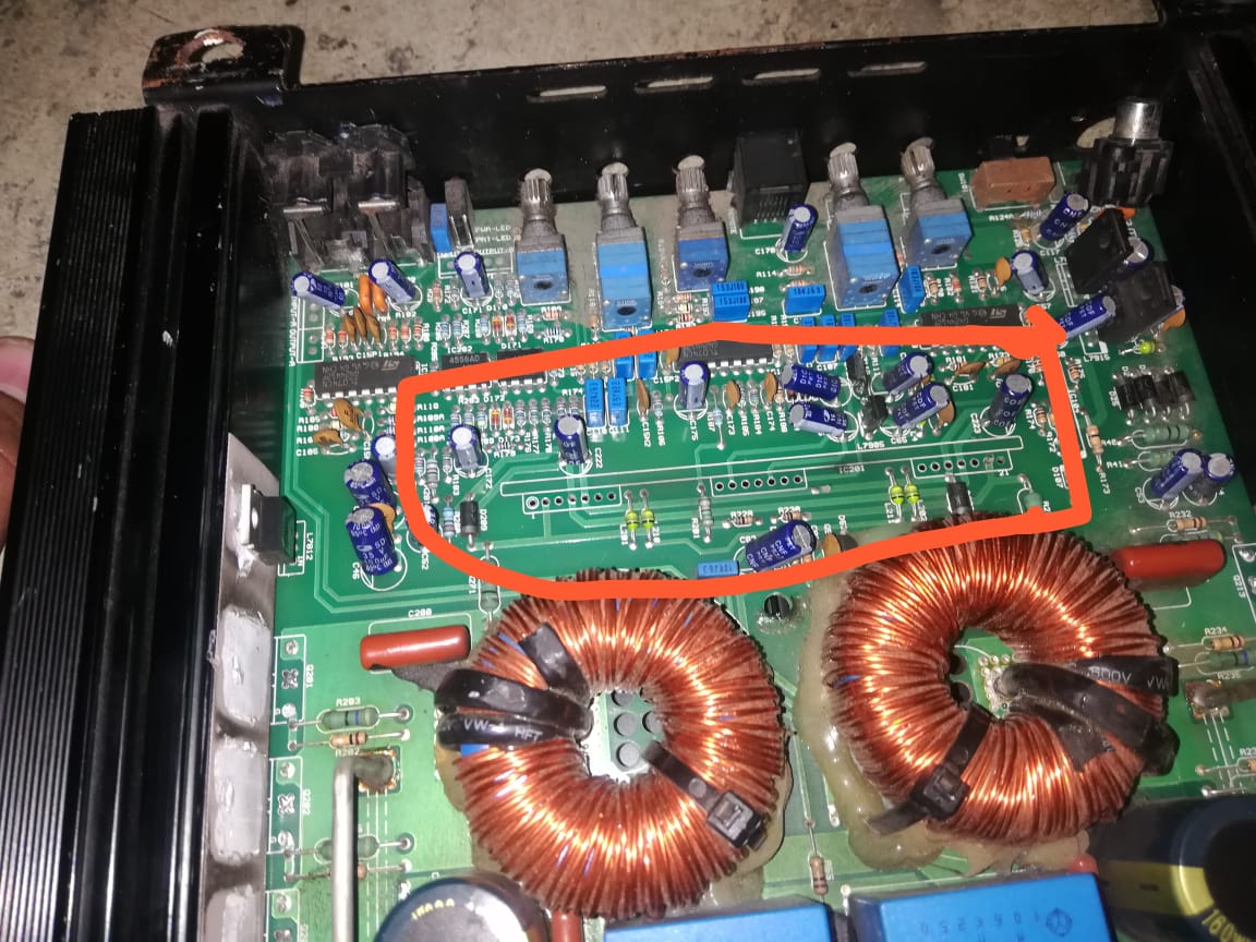

Correct Perry everyone gets hot the same, I told you that I put them in their heatsink thinking that it was normal because they were working and in the test with 1 ohm load the tvs diode and 3 mosfet of the output were burned, now I mounted the new transistors again including the rectifier diode but only when connected outside the chassis just activates the relay, the output mosfet heats up
Are you saying that you were testing the amp out of the heatsink while driving a speaker load?

The board has some damage from when the driver board was removed. Are you sure that you reliably reestablished ALL of the connections from the top of the board?

Well actually that board I took it from another amplifier I had to spare but it needed the ir21844 and the tl072 I installed it and I tested the amplifier with that board and it turned on well, the amplifier originally came without the conducting board and with the source burned, I repaired the source but now I have the problem with the outputs
Do the outputs heat up (clamped to the heatsink) if you just let the amp idle for an extended period of time?
Does the amp draw excessive current at idle?
Do you have a scope?

Did you buy the FETs from a reputable distributor (not ebay)?
How did you reconnect the traces on the top of the board that had broken vias?

With that scope operating from battery (no connection to any other power source), do all of the gate drive signals look good? Black probe on the source leg, red on the gate leg. Scope set to 5v/div and whatever timebase that will display 3-4 full cycles.
