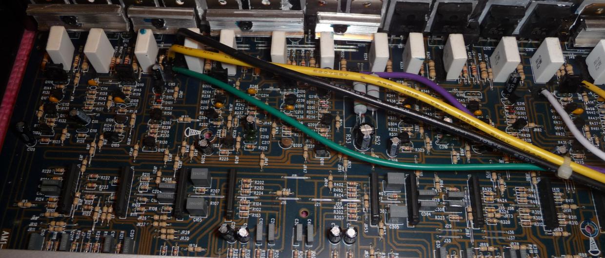

Cadence TXA6004 - channels outlined

After naptime I checked the smaller transistors (the driver's drivers) above the drivers, and they appear completely shorted, typical transistor failure mode, which is what I had been expecting and looking for, just didn't find as quickly as I'm used to.

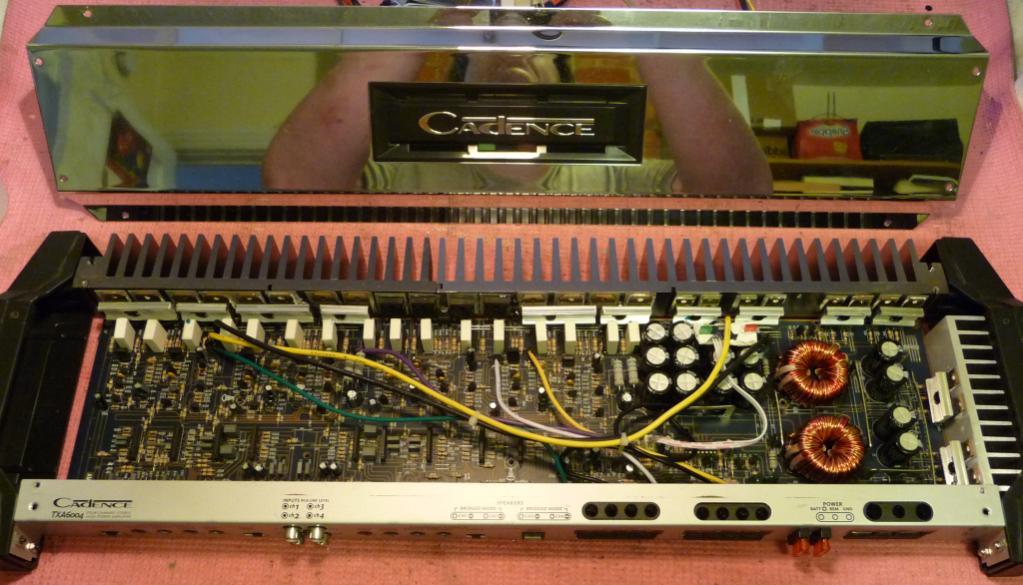

When the client brought these in, he was bragging on them. I like that its all through-hole components (no SMD), and the boards are neat in that you can see the bottom traces from the top, but the plating is crap - the pad plating breaks off from the transistors with very little heat, plus the holes are split on the ends, and there isn't a plated through-hole on the whole board. The heatsinks don't make sense either. A reasonable amount of surface area, but when the case is assembled there is no way for air to flow through them. Neither convection or breeze. No heatsinking on the drivers either. And they were all sort of randomly crooked too. And on the solder side everytime they bent a lead to hold the component in, they bent it over another trace.
Then I googled 'em up and found that these amps were a big embarrassment to Cadence because they failed easily. The redesigned ones have some circuit changes and longer heatsink fins.

Ok, pulled the drivers drivers, I had seen + and - 29 across all 3 pins of each (respectively npn/pnp) so I thought they were blown, but no, apparently they were just full on as I left them out, powered up and measured at the pads, finding the base pads at +&-29. Hmmm. Its coming from somewhere.

Time to check voltage at every transistor in the area...
Although I already tested them on Diode-check earlier for shorts, so maybe a shorted op-amp on the channel?

When I first put in the replacement outputs I remember hearing white noise through my test speakers before the protect light came on - and up to now I hadn't paid attention to that info, but, perhaps one of the op-amps is either shorted, or operating at infinte gain (no feedback)?

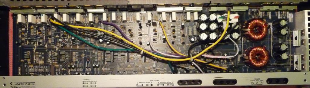

This appears to be a generic Asian design. If you can post a high quality photo of the power supply control area and one of the power amplifier channels, I'll see what I have that's close.
