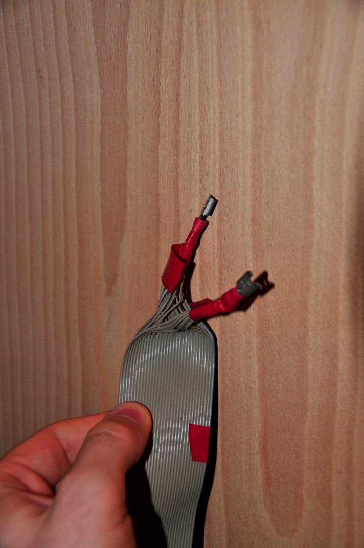

As Calvin says, for an ESL you can use a cable which trades off parasitic capacitance in favor of low inductance, since a little extra capacitance won't make a difference.
The easiest way to make such a cable is from computer flat-cable. Simply alternate between + and - signals: all even conductors carry +, all odd conductors carry -.
As an added bonus it's possible to run this cable under the carpet if necessary 🙂
I can post a picture later if desired.

Yes, cable inductance is much more important for ESLs than for conventional speakers... 10nF cable capacitance is not much of a problem, it is swamped by the (transformed) panel capacitance.
BTW, see photo below for what I did. The alternating wiring scheme minimizes inductance (I don't have a tool to measure it).
Kenneth
