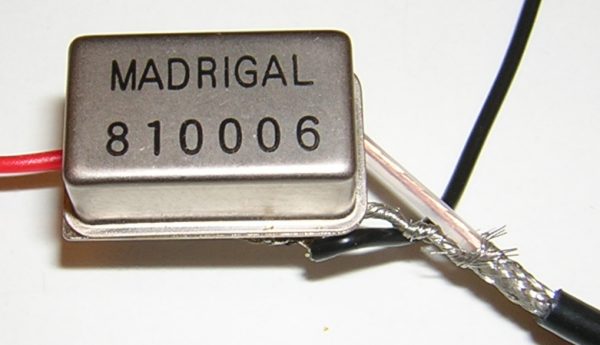

Based on measurements i have found the surprising conclusion that changing a coax cable from 50 cm to 150 cm did not change jitter performance at all. (Non terminated).
Proper termination of the cable also did not have influence on the jitter at the output of the cable.
It was measured on a steady clock (with 2pS jitter level 3-sigma) , the result might be different if you were to use a bi-phase modulated SP/DIF signal though.

Lars it's also interesting that you got 2 ps from a standard oscillator and Guido gets 6 ps from a special developed one (unkowned what the special thing was).
