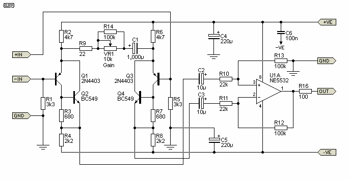

Mic Preamp
Good Morning everyone, l apologize for diverting your attention, someone kindly assist. l would like to know how to calculate the gain of the following preamp schematic. which resistors do you use to determine the gain. l want to make some frequency response measurements, and would like to build a good mic preamp with a 6 position pole switch for the gain pot. great regards
