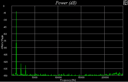

Just to add my 2 cents:
Here a loop trough measurement of 5 m el cheapo Belden CATV cable. It is an average of 256 synchronous measurements. Averaging was done in the complex domain of the FFT. Signal was – 10dB below full scale. The audio card was an M-Audio Audiphile 2596, @ 24 bit / 48 kHz.
The very low noise floor is due to the averaging. The real measurement floor is probably something of -130 dB, I guess. The harmonics seen are for sure the distortion of the card. They rise a lot at 0 dB signal level, just before clipping. At -40 dB signal the distortion vanishes completely from the plot
BTW no cleaning of the cable connectors and card jacks was done (cinch).

Thanks.
Though until you notch out the fundamental, the measurement isn't quite comparable, as I'm sure John would be the fist to tell you. :)
