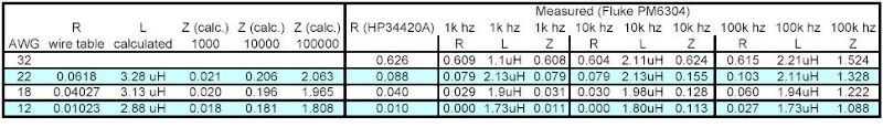

The attached graph shows some realistic inductance/reactance values for four 6' long wires: 32, 22, 18, and 12 AWG. I had indicated in another thead (now closed) that I would make some measurements. The only intent here is to provide real values.
Both meters are within their calibration periods. The 32 AWG wire is silver plated OFC. I didn't furnish calculations because I couldn't readily find the datasheet. The 22, 18, and 12 AWG wires are basic stranded wires.
I typed a longer explaination (that got lost when there was an error with the picture dimensions).
On the left is Z (calc.) 1000, 10000, and 100000 hertz. I used the formula L = 0.005 l (2.3 log10 (4 l/d - 0.75)). I made the calculations after the measurements. They all seem to jive. There may be errors and inaccuracies. This is only to provide ballpark figures (rather than joke figures).

Hi John, thanks for going to the trouble, and pity about the thread being closed prematurely.
Seeing as you have the appropriate gear, do you mind measuring some representative cables like standard fig 8 power cable and others.

I could certain try to do that (no promises that I will meet your expectations). What aspects are you most interested in?
I have no problems, but am not sure that extra handling of the test cables would be generally accepted. Also, not sure that we should add more to Steve's efforts.
Thought about doing that, but I am just making a small point about using realistic cable inductance/reactace values (0.0000000... just wasn't working for me). I'll save starting a new thread for something more interesting/controversal : ).
