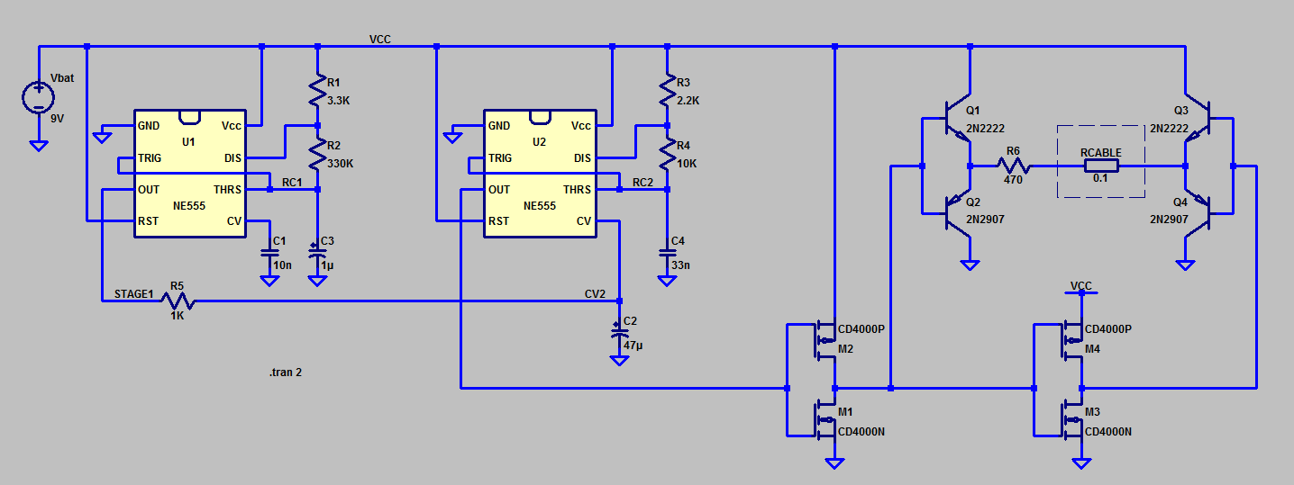

Does anyone know how to build a simple cable cooker, which can be used for speaker cables and power cord too?
You could experiment with something like this.

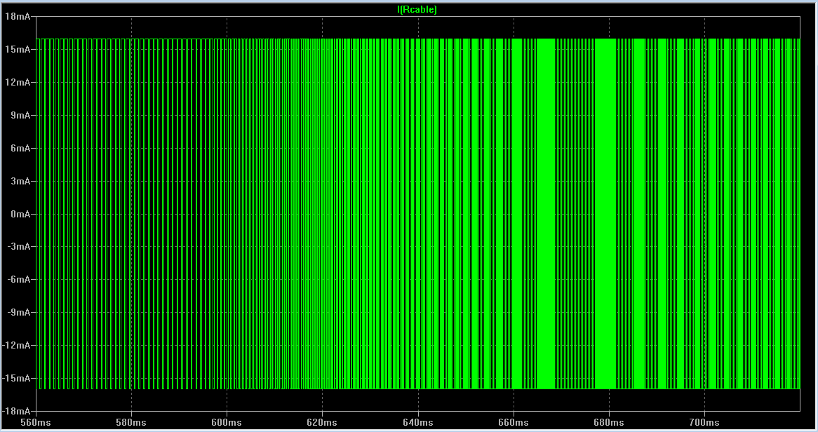

The first 555 timer/oscillator IC creates a slow ramp on node "CV2" which controls the oscillation of the second 555 IC. This is fed through a pair of CMOS inverters (CD4069, CD40106, whatever 15V CMOS inverter chips you have lying around) to an H-bridge. The H-bridge drives current through the cable in both directions; you can see that the current alternates between +16mA and -16mA.
Beware, this will drain a 9V battery pretty quickly: 600 mA-hr / 25mA = 24 hours. So you probably want to run it from a wall-wart or other AC-to-DC power supply.
