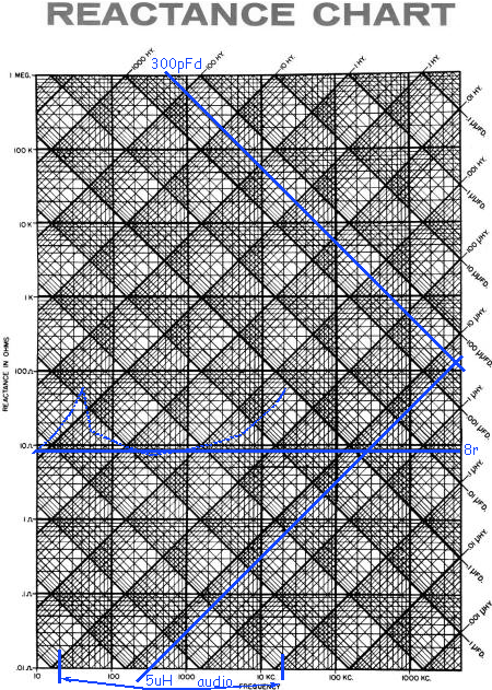

If you are math-lazy, use the Reactance Chart.
3m of most cable is probably 300pFd or less, and <5uH.
Speaker is nominal 8 Ohms; however there is a bass rise and almost-always a significant treble rise.
Plot, C, L, nominal Z, and probable Z.
The C is never close to adding load to the speaker.
The L does come near 1/10th of an 8 Ohm resistance at 20kHz. However most real speakers are rising above their nominal at 20kHz.
I'm not going to speculate about >20kHz because speakers may be screwy, and transistor amps are OFTEN screwy 100kHz-10MHz. You think it is an audio system but the transistors do not know that. There's no way to generalize what different designers do.
