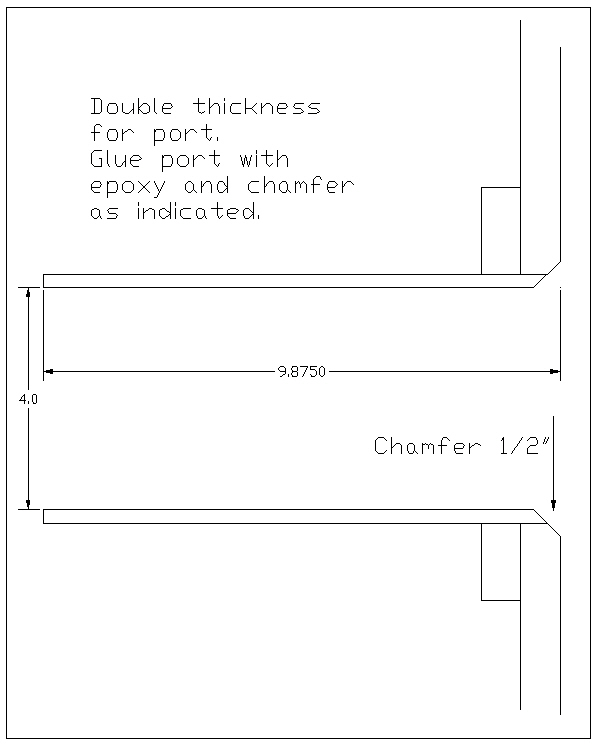

The Eaton Cabinets have an internal volume of 30 litres
the Port is tuned for about 50Hz as far as I can see.
http://44bx.com/tannoy/images/Eaton.gif
If you sealed the port (without damaging your cabinet) you will get an rough idea what you could expect in a proper sealed box.

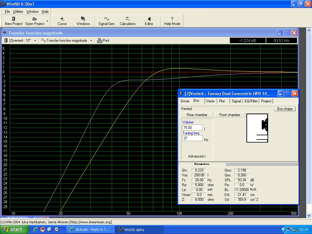

Using the partial T/S provided earlier:
QES 0.26
QTS 0.23
FS 26 Hz
VAS 0.2 m3
BL 11.2
RE 5.8 Ohm

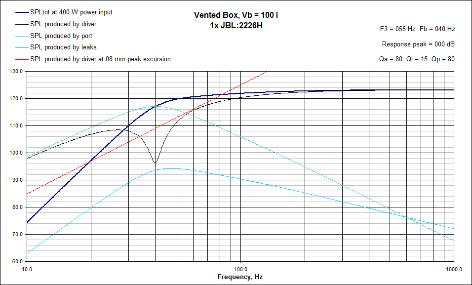

then 24L net for the HPD10 gives a Qtc of 0.707 and an f3 of 68Hz.
I would then add a JBL 2226 in a 100L ported enclosure underneath the HPD10. The attached FR for this driver/box is using 400W, but as you Tannoys are rated at 50W, and are several dB less efficient, I doubt you will ever use more than 100W through the JBL's.
There are doubtless many other drivers you could use, but I suggested these as I am familiar with them and they are an excellent driver for a number of reasons; their FR is good way above the intended xover of 200hz or so, the SFG motor structure is low in distortion and the cooling structure designed into the motor will ensure that power compression will be a very minor factor in use with the HPDs.

The reason for the partial t/s is this is the minimum relevant TS data that WinIsd Pro Alpha will accept. I found out later that a QTS of 0.233 gave a more accurate QMS Win isd calculates this as 2.198 Quoted QMS is 2.2Using the partial T/S provided earlier:
QES 0.26
QTS 0.23
FS 26 Hz
VAS 0.2 m3
BL 11.2
RE 5.8 Ohm
I did another sim in WinIsd. I Aimed for a -3db point of 40hz (I feel that 40Hz is a relevant frequency at least for rock and roll as 41Hz is the lowest note on a bass guitar!)
This calculated out to a 75 Litre box tuned to about 37 Hz (to avoid the dreaded one note bass hump) The yellow line on the sim emulates what the
Eaton cabinet acheives with the dimensions I found on line.
Intrestingly this seems to show a -3dB point of 60Hz not Tannoys Quoted 50Hz But Tannoy also quote a lower efficiency....😉
Personally I think this should work, especially given that you wont be pushing the drivers too hard with 15W amps. This would need a lot less investment than adding Crossovers -Amps and Subs. Especially given the quality drivers that would be needed to match the tannoys!

Good plot, Xoc1! I was messing around with Win ISD and the HPD295A earlier, and I think you got a slightly better response. Goes to show how unimpressive the Eaton cabs are. When you try punching in volumes greater than 150L, the bass hump goes wild. However, those drivers benefit from horn loading which changes everything. You can achieve even better bass response in the back loading of a Cornetta (R-GRF style- not the bass reflex Japanese Cornetta). In those cabinets, a 10" gold achieves a -3db@35Hz and it's Very hard hitting!! If I were trying to achieve a "stand-alone" 10" Tannoy, this would be my cabinet of choice.
Not sure if its in the data given or not, but whats the port diameter/length for that set up?
I punched it in like he did (75l and 37Hz tuning) and got 1 port (round) @ 0.102M diameter, @ 0.160 length. That translates to 4 inch diameter, and 6.3 inches long.

Just for reference, this is the 60l recomendation in another thread
JRKO
If were you...
I would use a 12"Wx28.375"Hx14.5"D enclosure which gives roughly a 56 liters net volume, having taken into account lost volume caused by transducer and port.
A 4" internal diameter ABS port whith a lenght of 9.875" long as shown on the drawing. This port is on the back panel and toward the bottom of enclosure. Chamfer as on the picture.
Box, which is filled by 33% of volume with fiberfill or fiberglass, is tuned to 35Hz, slightly overdamped with F6 of 35Hz, relative to 100Hz. Sensitivity is 94 dB...not bad.
Decent group-delay and port velocity.You can resize the enclosure but don't change the internal depth because of port and naturally keep volume constant. Keep fills tight on enclosure near port.

If were you...

Thats the size port I came up with. I would use 4" drainpipe for the port anyway which makes it easy to tune to a different length.I punched it in like he did (75l and 37Hz tuning) and got 1 port (round) @ 0.102M diameter, @ 0.160 length. Maybe he gets something different.
