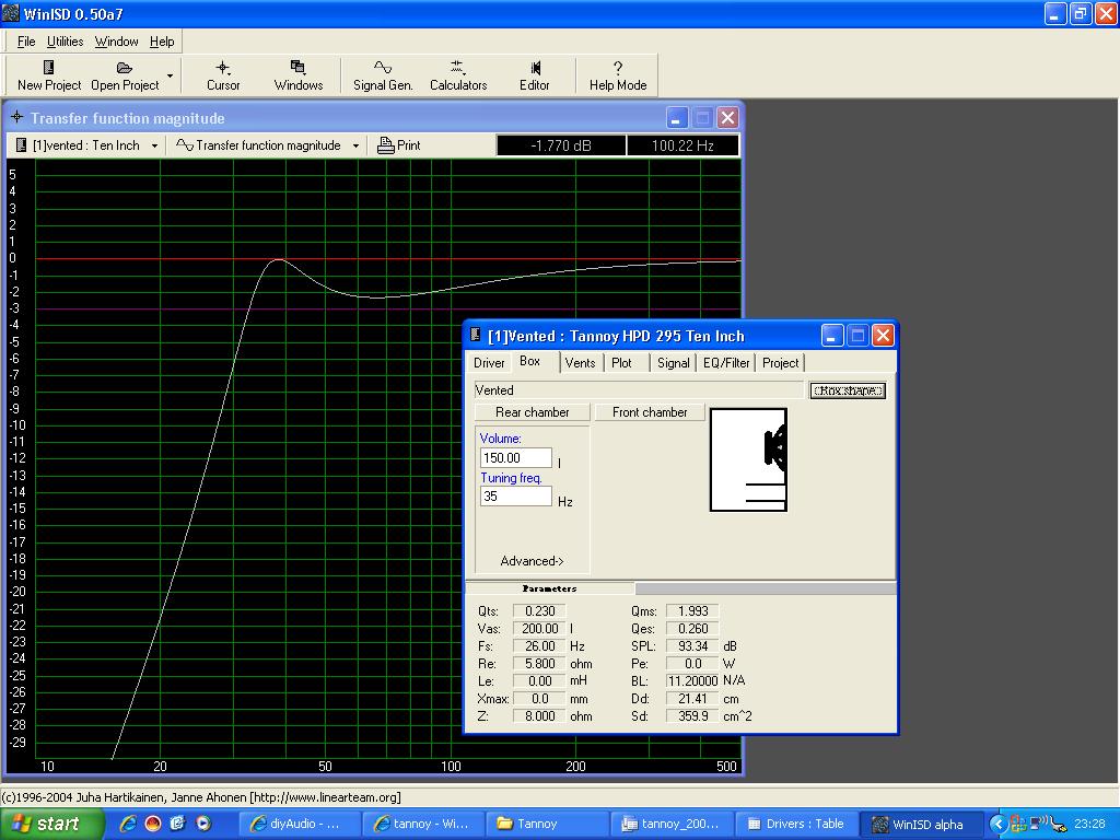

I found the Driver parameters Here
tannoy
I then entered the Parameters into WinISD Alpha
QES 0.26
QTS 0.23
FS 26 Hz
VAS 0.2 m3
BL 11.2
RE 5.8 Ohm
WinISD then calculates the missing Parameters
You can then model up a Ported Cabinet.
I found that 150 litre box worked reasonably well tuned to 35hz
This gives the same shape of frequency response curve that you might expect from the Tannoy 15"
2 X 100mm ports would be suitable.
You would have to decide what size box you can live with and play around with the variables.

That is the kind of shape of sim i patently avoid... either it is tuned too low or the box is too big (or both).
Brett's method is going to get you the most... I'd tend towards an aperiodic mid-TL thou.
dave
Please don't get to upset about the shape of the response in my sim it was only meant as a quick example of what is possible. I overcooked the bass port resonance and made it a bit too large.😱That is the kind of shape of sim i patently avoid... either it is tuned too low or the box is too big (or both).
To get a flat response from a Tannoy dual concentric you will be looking at a very small box with poor bass extension. The bass response starts to sag in an enclosure over 45litres or so.

a big vented box tuned low can sound good.
But 35Hz from that 10inch driver is just too low.
You must eliminate the hump and try to find a slowly falling LF response.
If you go for a slowly falling response it will sound bass light. It really needs a low bass driver to augment it. Now you are designing a 3way. But, it could be excellent.
