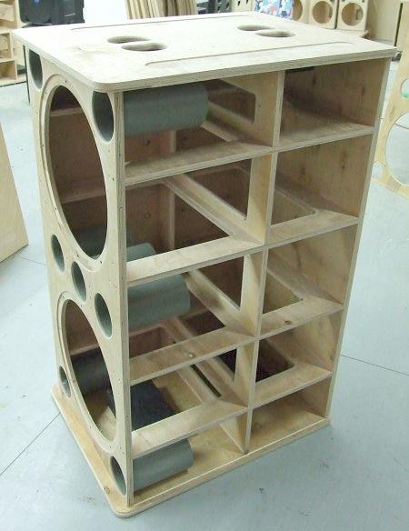

When the point of bracing is to stop the panels vibrating, then the corners aren't the most effective place to put the braces. The corners are already relatively stable because of the joint to the adjacent panel anyway.
You really want the bracing near the centre of the panels, but offset a bit so you don't just create 2 smaller sub panels of identical shape & size.
The attachment was posted a few years ago on another forum by the principal of MM Acoustics, and is a pretty well braced box.
HTH,
David.

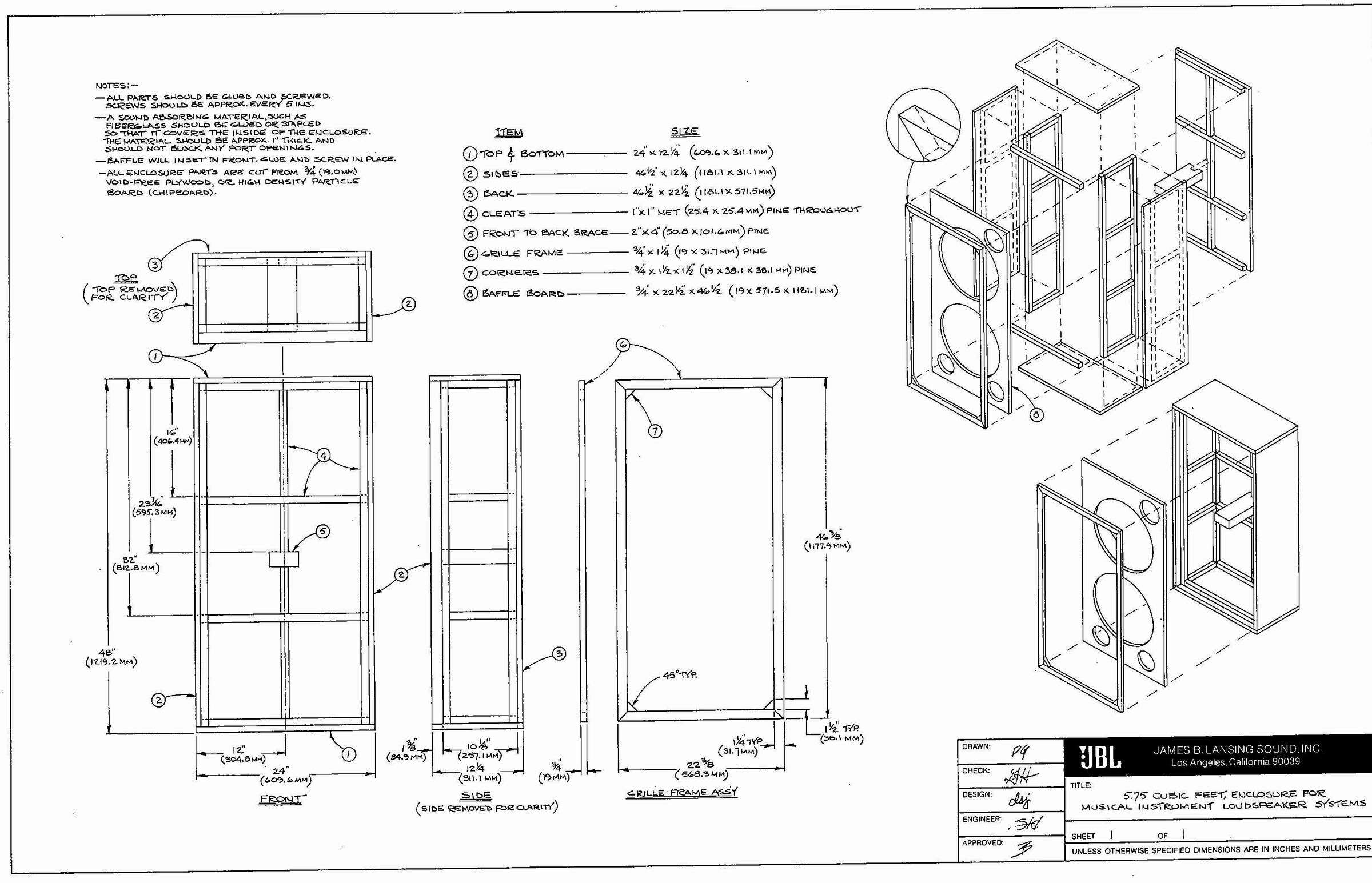

Attached drawings of JBL Kit (year 1970). They reinforce the vertices, the center of the panels and an bracing of generous dimensions between the deflector panel and the rear panel. Everything helps to lower resonances.
I've always built my cabinets like that.
It is clear that as the speakers and amplifiers have increased the power, the same happens with the number of reinforcements of the boxes.

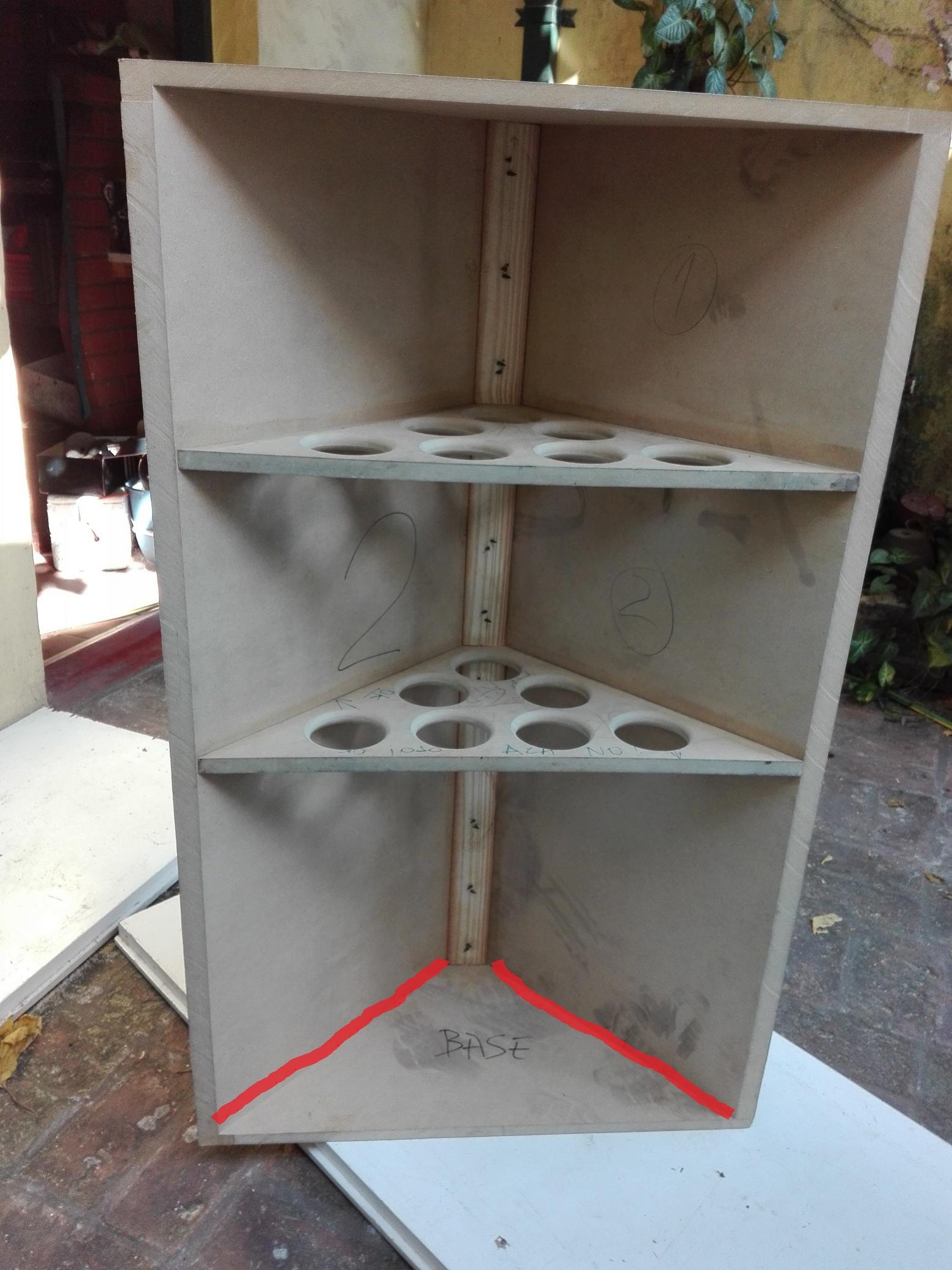

Here is an example:
Supra Sub - www.pcpaudio.com
So I decided to also reinforce the missing vertices of the upper and lower panels of my current construction.
Here is an example:
