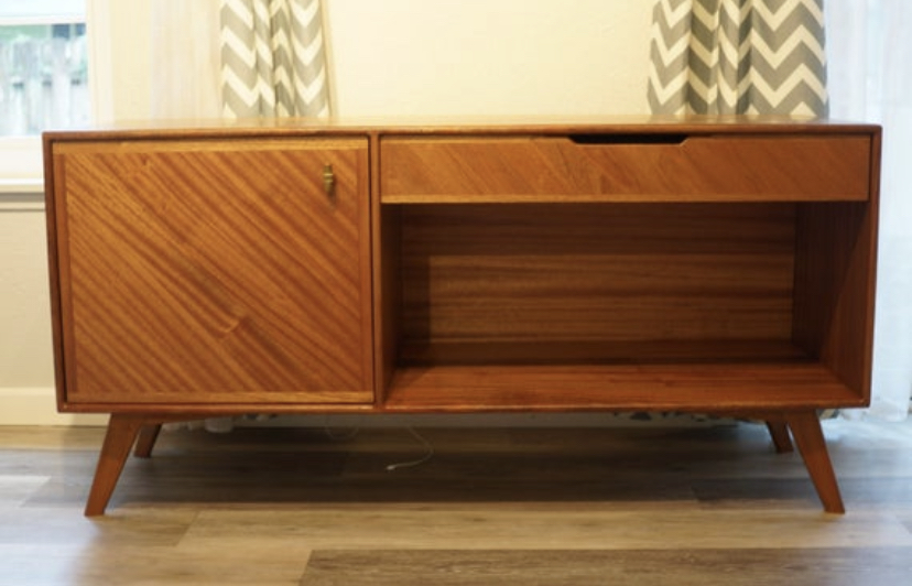

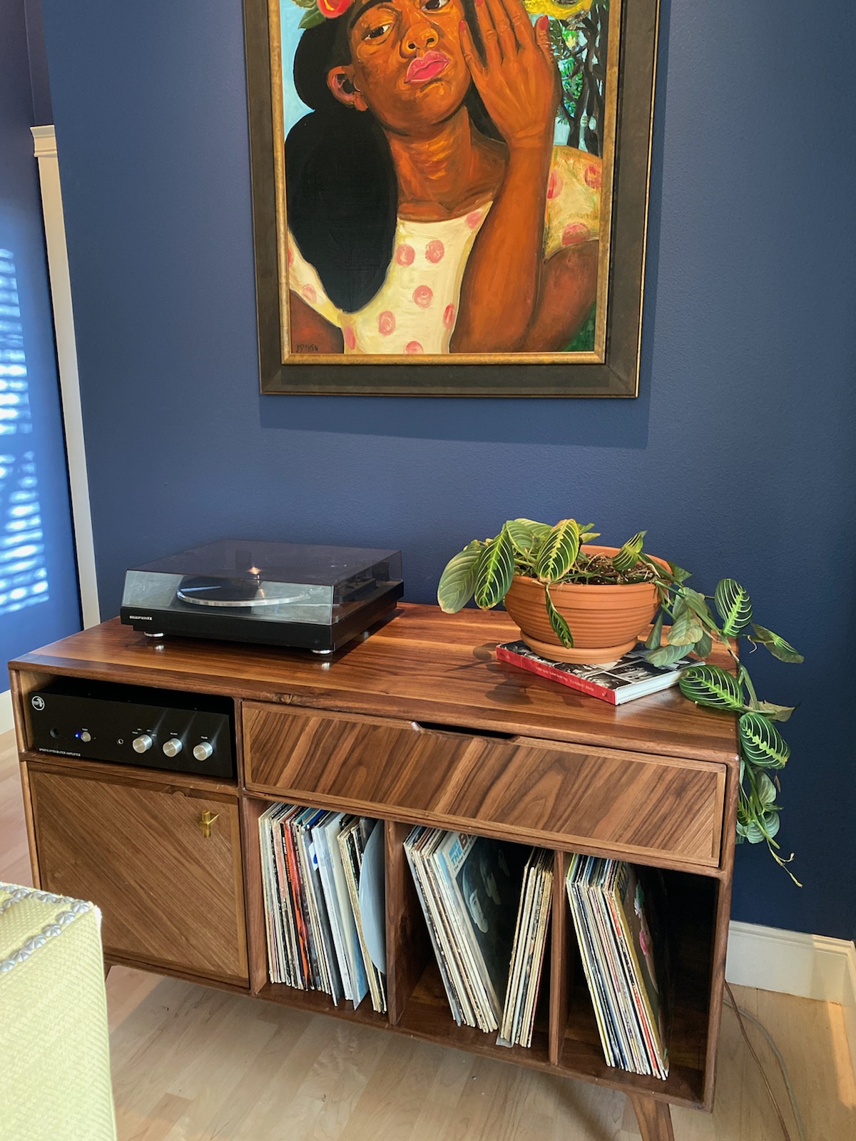

Pic of the last consoles i did to hopefully prove I’m not all thumbs, and to show you more or less how I design the stuff in my house. 🙂

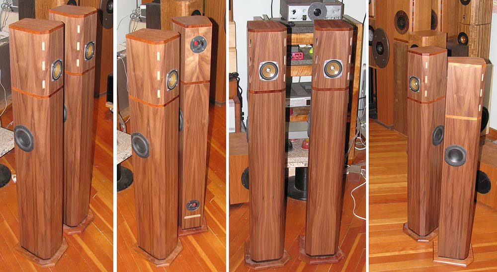

For some reason those thumbnails didn’t expand to full size. The left is clone of Tannoy Churchill, for 15” co-ax, and the right hand is PHY 8”; both commissioned for the late owner of a local hi-fi shop. The Tannoys were quite impressive, but the PHYs were incredibly underwhelming; at least in the “factory recommended” enclosure.

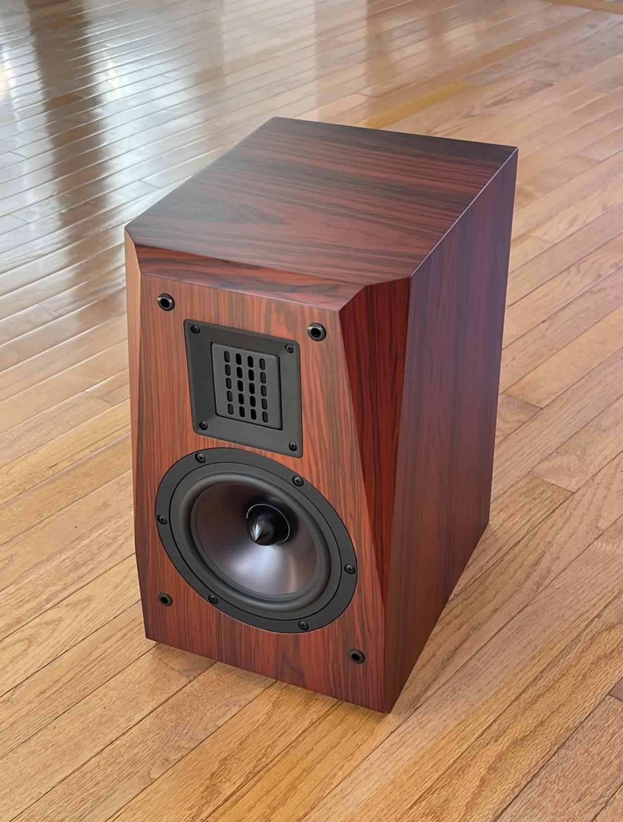

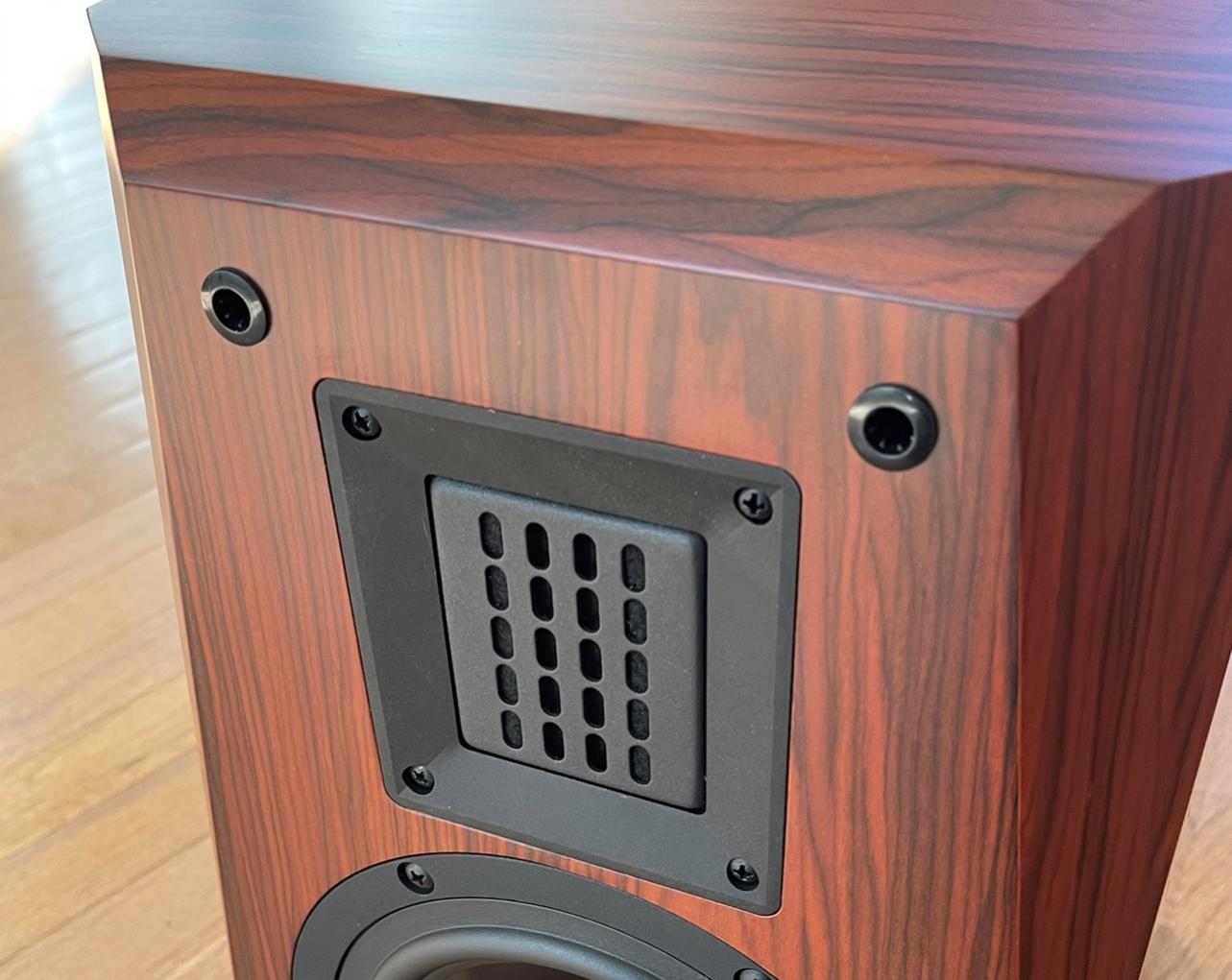

I don’t know how these guys did the rosewood veneer on these speakers that I designed for a customer. But it is flawless. It looks so good I couldn’t tell it was wood veneer until I looked at the grain under a microscope.
They look fabulous but you can hear how they sound here.
