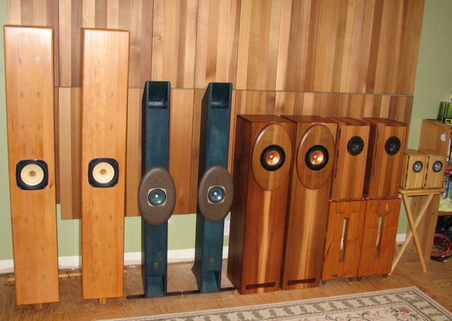

How about the multi-core materials? Has anyone used the material with alternating mdf and ply cores?
We are experimenting with it. a recent build was with 3/4" MDF-ply-MDF with 1/2" solid cedar laminated to the outside. It worked well but we have not done a comparable enclosure to compare it with. 2nd from the right
