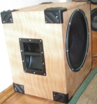

After long searching/reading around, I decided to consult fellow experts here about my current cabinet making attempt 🙂
Here is the situation
I have a 300w (rms @ 4ohms) head (although it is sold as a bass amp it is a full range one), and a delta-15lfa (new version I guess) speaker in hand (an apt:80 tweeter and a proper crossover is on the way).
I'm hoping to use this combination for stage monitoring/PA purposes during gigs of our jazz band which I play trumpet in (it is a Bb trumpet but I usually add lower 12th harmonics on it with an effect processor).
I think delta will use only 150 watts max or so since it's 8ohms.
As you may guess I couldn't decide on cabinet dimensions and between vented/sealed choices since this speaker is something almost in the middle in terms of suitability (vented/sealed).
Another confusing point is in pdf documents available from eminence site, parameters stated like this:
Resonant Frequency (fs): 41Hz
Qts: 0.58
Compliance Equivalent Volume: 86.1 liters / 6.6 cu. ft.
But on their specific page for this model, it is stated as:
Resonant Frequency (fs): 39Hz
Qts: 0.48
Compliance Equivalent Volume: 241.0 liters / 8.51 cu. ft.
I guess differences come from the existence of two models (new and old??) with polymide and Kapton formers though I'm not sure.
Despite I can easily reach all necessary materials, I don't have enough time and motivation for multiple trial/error attempts (mmm bad for a diyer🙂). Thus if something goes wrong the only possible modification after finishing a cabinet is to open some suitable vents (if I begin with sealed version of course🙂).
So could you please recommend something as a start point? Should I try a sealed cab with a mediocre volume first, (average of their recommended sizes)?
Thanks in advance

Sorry if this isn't very helpful, but Kapton is a brand name for polyimide:
http://en.wikipedia.org/wiki/Polyimide
I'm not sure why they list different specs for the driver.
How low of a frequency do you wish to play with this? I've seen a number of guitar amps (maybe they were practice amps) with open backs. If you're playing just above 150 hz, this could be an option for you. I don't know the Bb trumpet, but this website lists the low end of a C trumpet's range as 150 hz:
http://www.listenhear.co.uk/general_acoustics.htm
I know you said you can't do trial and error, but if you whip together a box with an open back, it's not like it needs to be sealed or anything. Heck, it doesn't really need a bottom. Can you do four sides of a box?

Thanks for reply
A real Bb trumpet is close to 140 cm long, and the pitch of its "fundamental" is Bb 2. But that note is essentially impossible to sound. So the lowest practical note (the "open" note) is the first harmonic, Bb3.
But I occasionally add lower harmonics via a processor. I forgot to mention that I also want to make this cabinet suitable for a 4 string bass. Because the amp is actually a bass amp so err...
I would like to use this delta-15lf to its limits at least to 40 hz (lowest note of a 4 string bass I think).
And "open back" you recommended... well actually I never thought about this option untill you mentioned 🙂 So now it's a decision between three. Humm... 🙂
All ideas will be appreciated
PS: Sorry for any syntax errors, English is not my native language 🙂

trumpet stage monitor - PA
Dude, (American term)
Lots to consider here.
For a pure trumpet monitor, something like a box with 4 10 inch
speakers should work really good. Consider an A 440 Hz, and
about the lowest note on the horn is an octave below, so you
won't need any output below about 220 Hz. Don't know anything about your effects processor and what it's doing....
300 watts should be very good for a jazz band.
For a 15 inch driver, I don't think a tweeter will match up to it
very good - you'll have a big hole from about 1K Hz to 3 Khz.
For a 4 string bass, a 15 inch is good for jazz. Not real happy about your plan to run both a trumpet and a bass through the same speaker.
Not sure I can really help, but what size clubs do you perform in, what kind of sound pressure levels do you need, and what are your thoughts about carrying around some big boxes to the gig?
HTH,
-Don

Hi again
About bass guitar; I rarely play it at home and never on stage so you may disregard it for now.
For the woofer tweeter combination, I wrote eminence for a suitable tweeter and that apt-80 was the one they recommended.
"Usable frequency range" of delta-15lf is 42Hz-3.2kHz and it goes relatively flat between these limits.
http://www.eminence.com/proaudio_sp...link=DELTA-15LFA&speaker_size=15&SUB_CAT_ID=2
Apt:80's relatively flat area begins from 2k or so if I'm reading the chart correctly.
http://www.eminence.com/pdf/apt80.pdf
So there may not be a huge lost range between them.
Actually I have seen cabinets around utilizing only a woofer and a tweeter but it seems they are for bass amps 🙂 like this BL-115 one in http://www.drbasscabs.com/ and I have no idea if it's suitable for trumpet.
We usually play in small clubs and small concert halls and I'm also not keen on shaking the room 🙂 So hi-fi ish sound is more important than sound level to me.
Would you say that sealed cabinets are more hi-fi then vented ones?
The effect processor I used is a Korg Toneworks model. And resultant sound are not limited to a usual trumpet's. I sometimes even amplify weird whistling/buzzing sounds coming from the mouthpiece (somewhat Arve Henriksen'ish). They have considerably high pitch.
Combos and cabinets for keyboards (supposed to be full range as well) are usually sealed, aren't they? So should I go this way?
Finally the size; it should fit in a hatchback Opel 🙂
It's hard to decide, considering my occasional itch, to poke our nosiy drummer with an unexpected bass note from the tumpet🙂
Cheers
Temporal

trumpet PA stuff
Some of the drbass cabs look good for your use.
I'd advise to just go with something like the BL210 and
be done with it. Saves lots of time and money.
You can try to build your own, but I can't believe that a 15 inch can go up to 3.2K, then you have the hassle of creating a crossover and mating with the amplifier.
HTH,
-Don

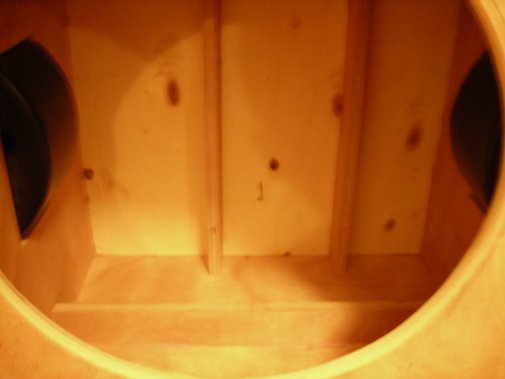

As a quick progress report, after two work days spended in carpenter's with trying some different woods and sizes for an open baffle (a piece of flat plywood actually) I ended up with something like this:
Why? Well, an open baffle could be the most suited configuration for trumpet soundwise. But physical aspects (durability, handling, positioning at different stages etc.) became an increasing concern in my mind while I was there (carpenter's).
At least I tried, didn't I 🙂
I attached the woofer and corner protectors temporarily for picturing, since the cabinet is not finished yet. There will be a tweeter there somewhere 🙂 Sealing should be secured (I may ask about sealer later 🙂). Internal padding and a grill for woofer are also in the list.
I'll report back when everything is finished.
