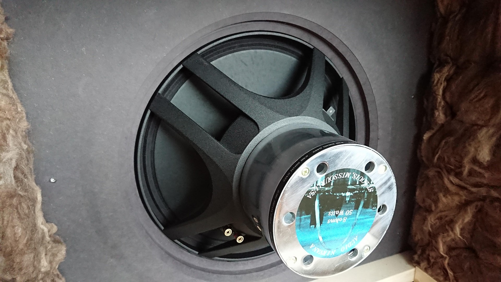

Hi GM this is also very very good damping material.
Maybe better.
But not very good for health they say.
Anyway i have very good experiences with it.

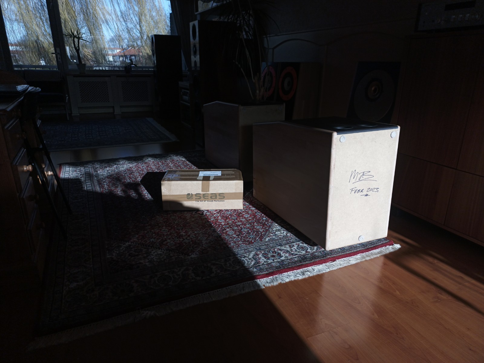

This was a very nice and simple project with the Super 15 Alnicos.
Maybe better.

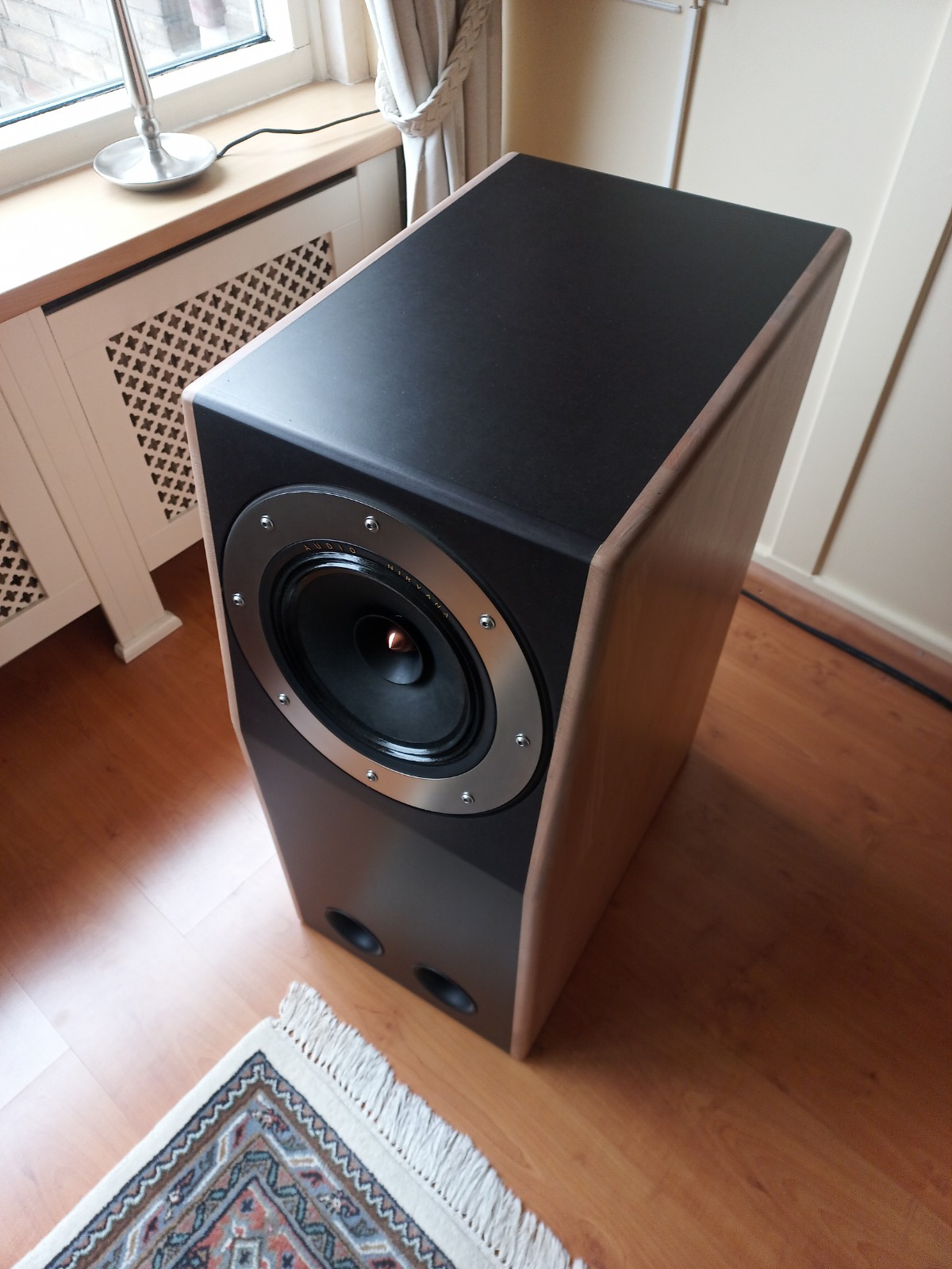

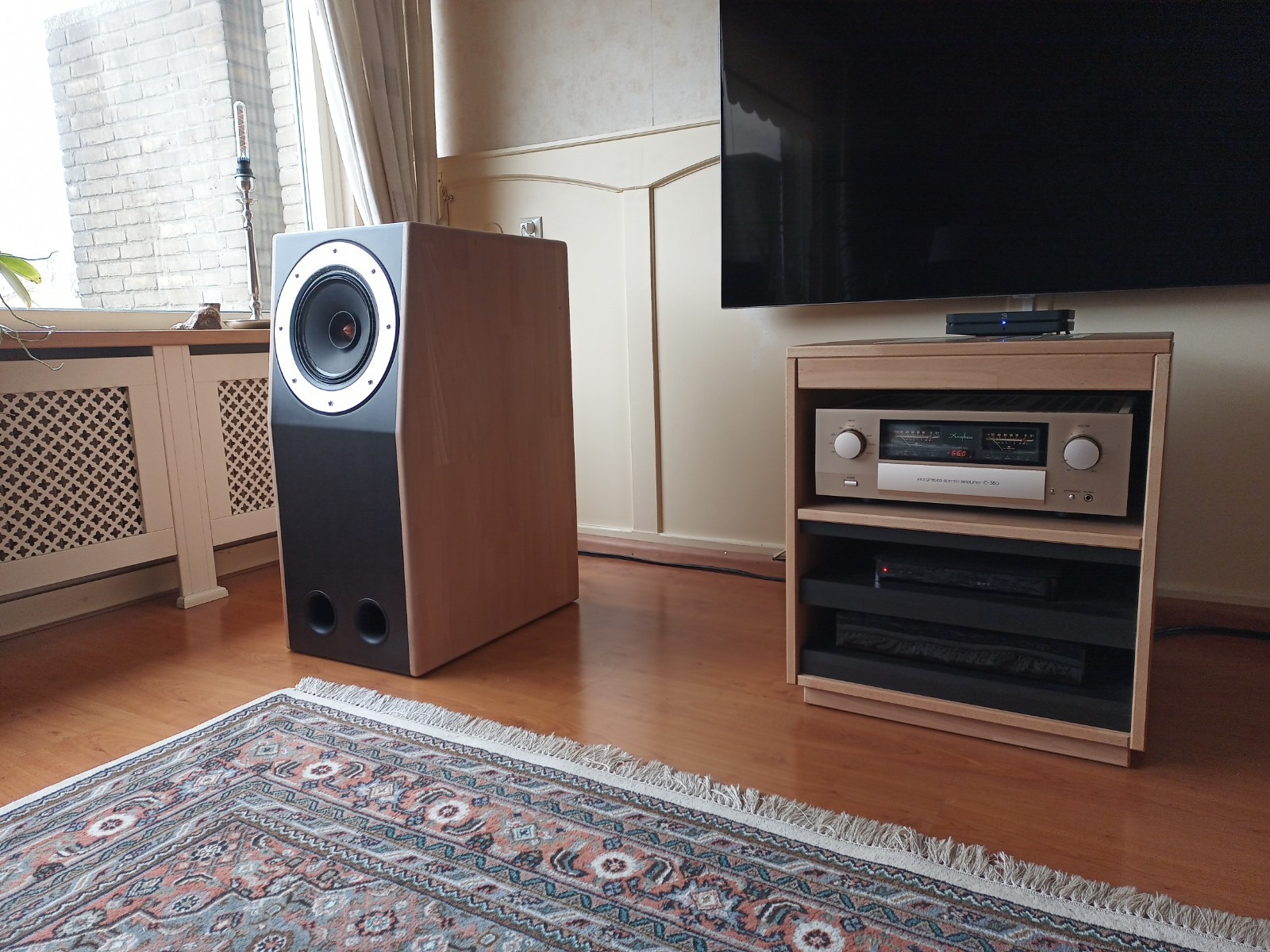

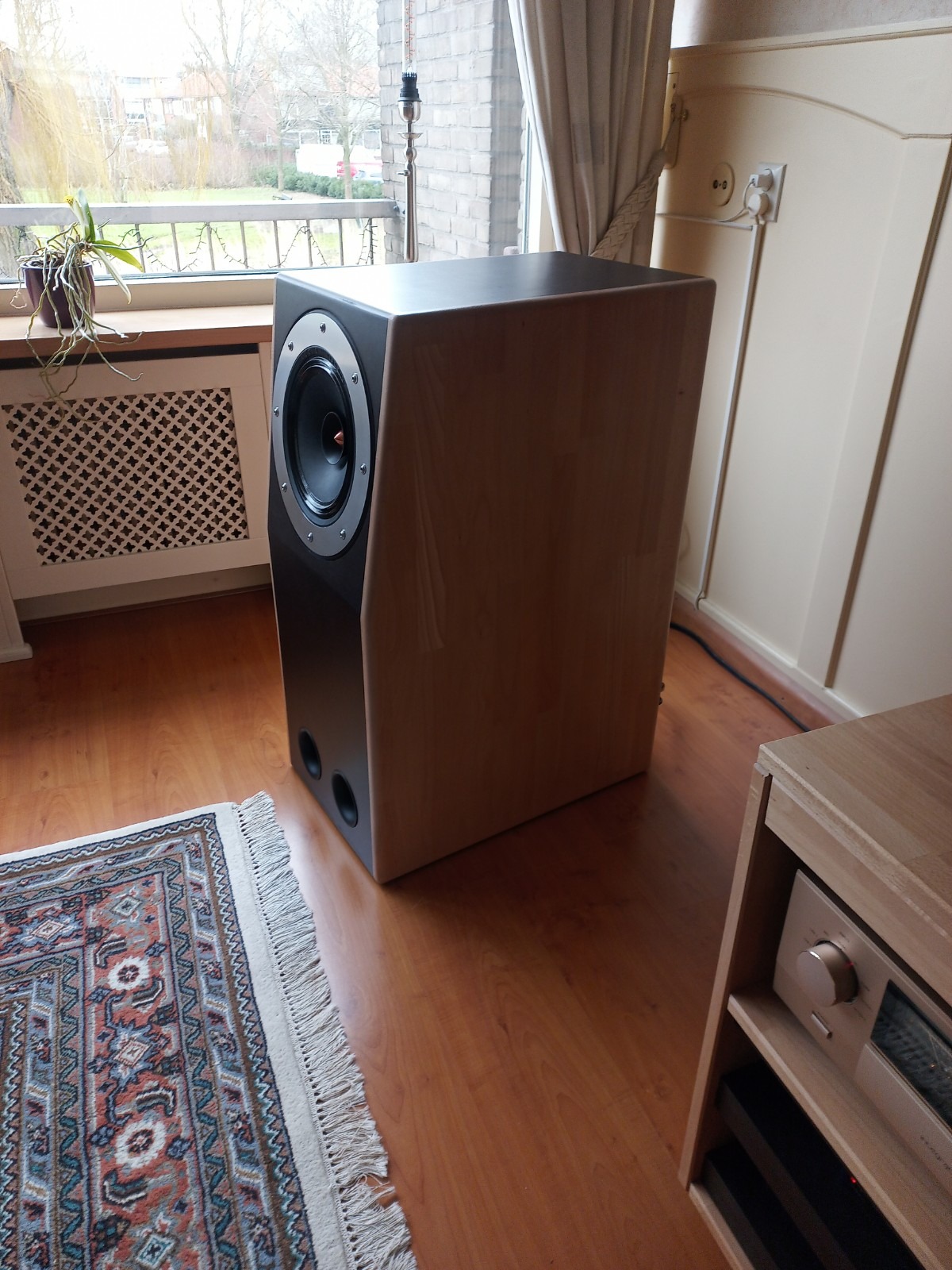

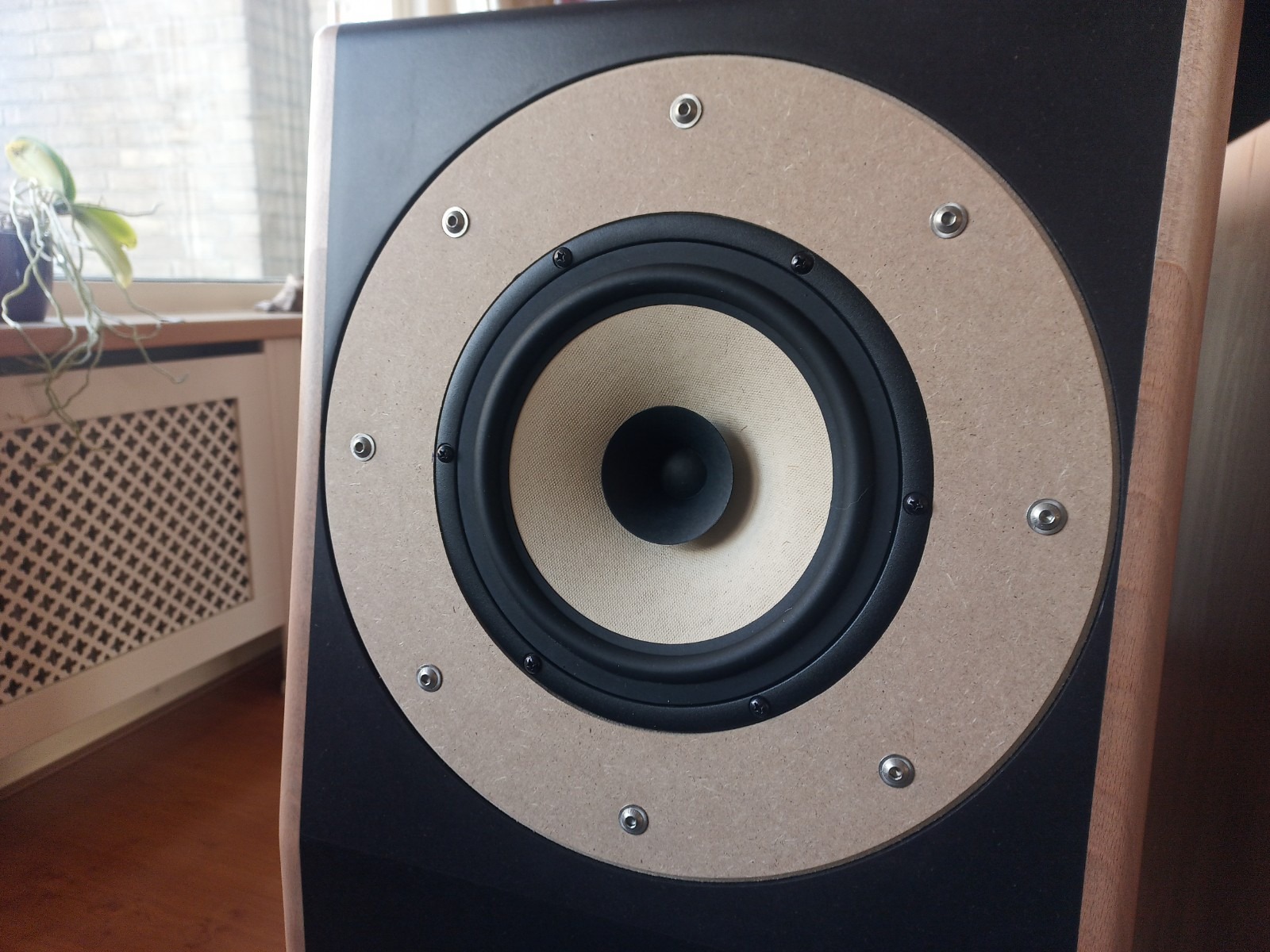

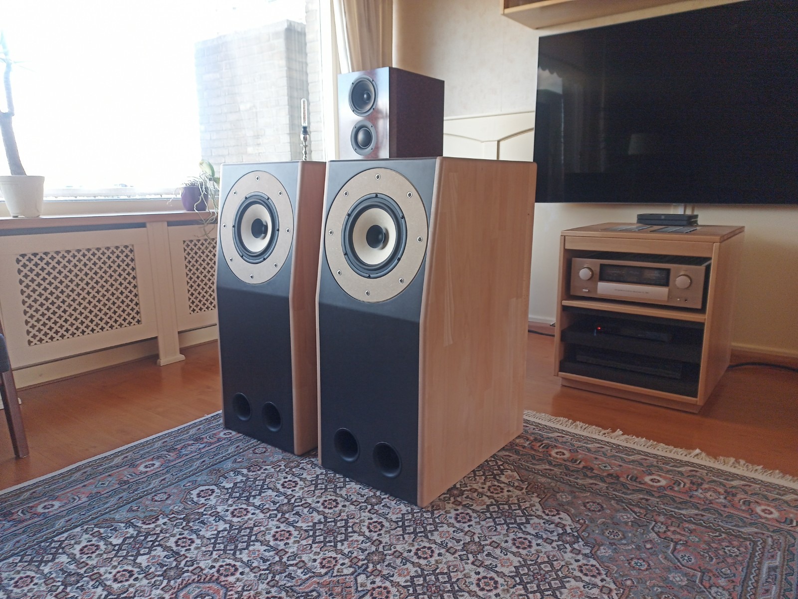

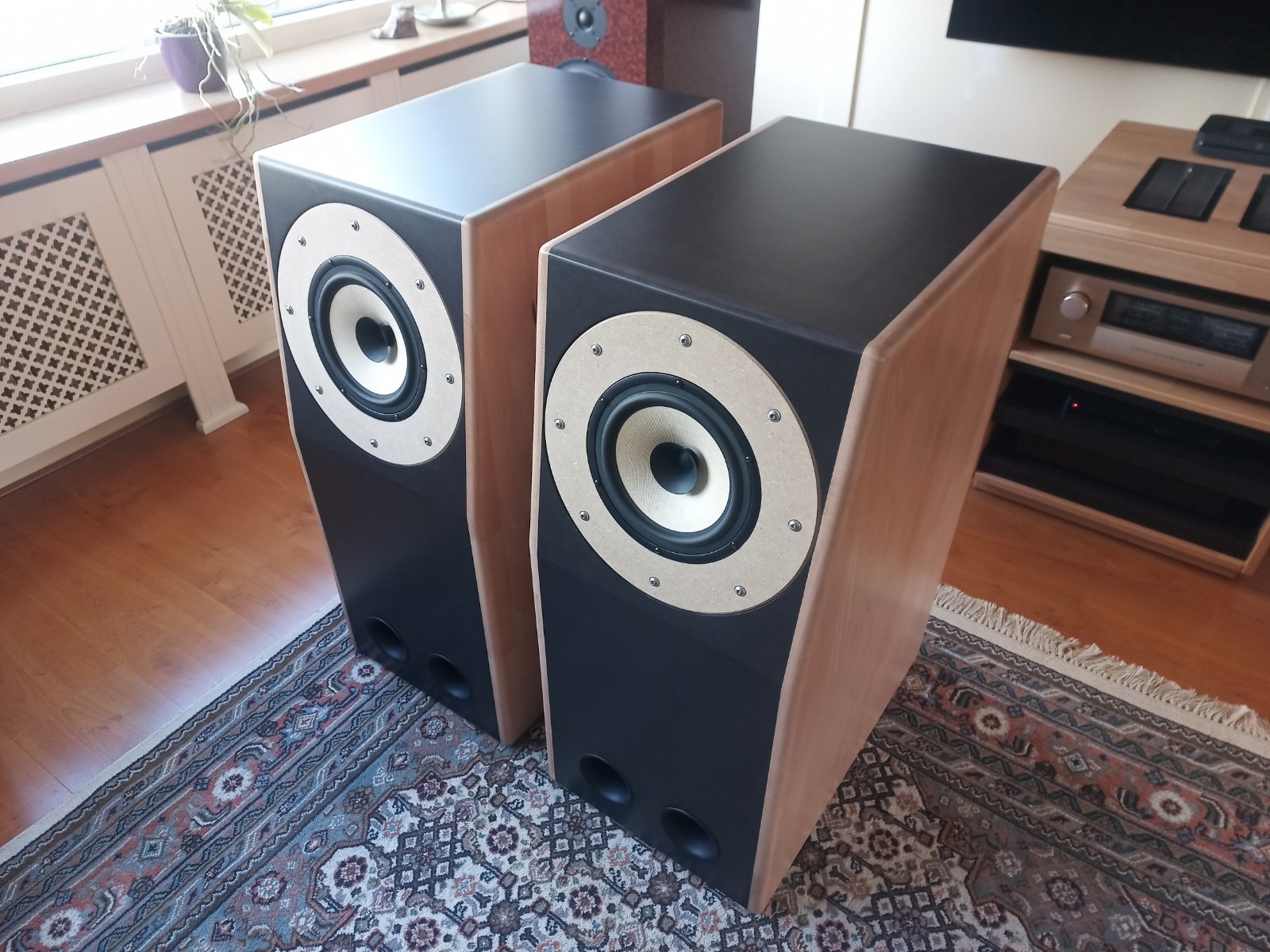

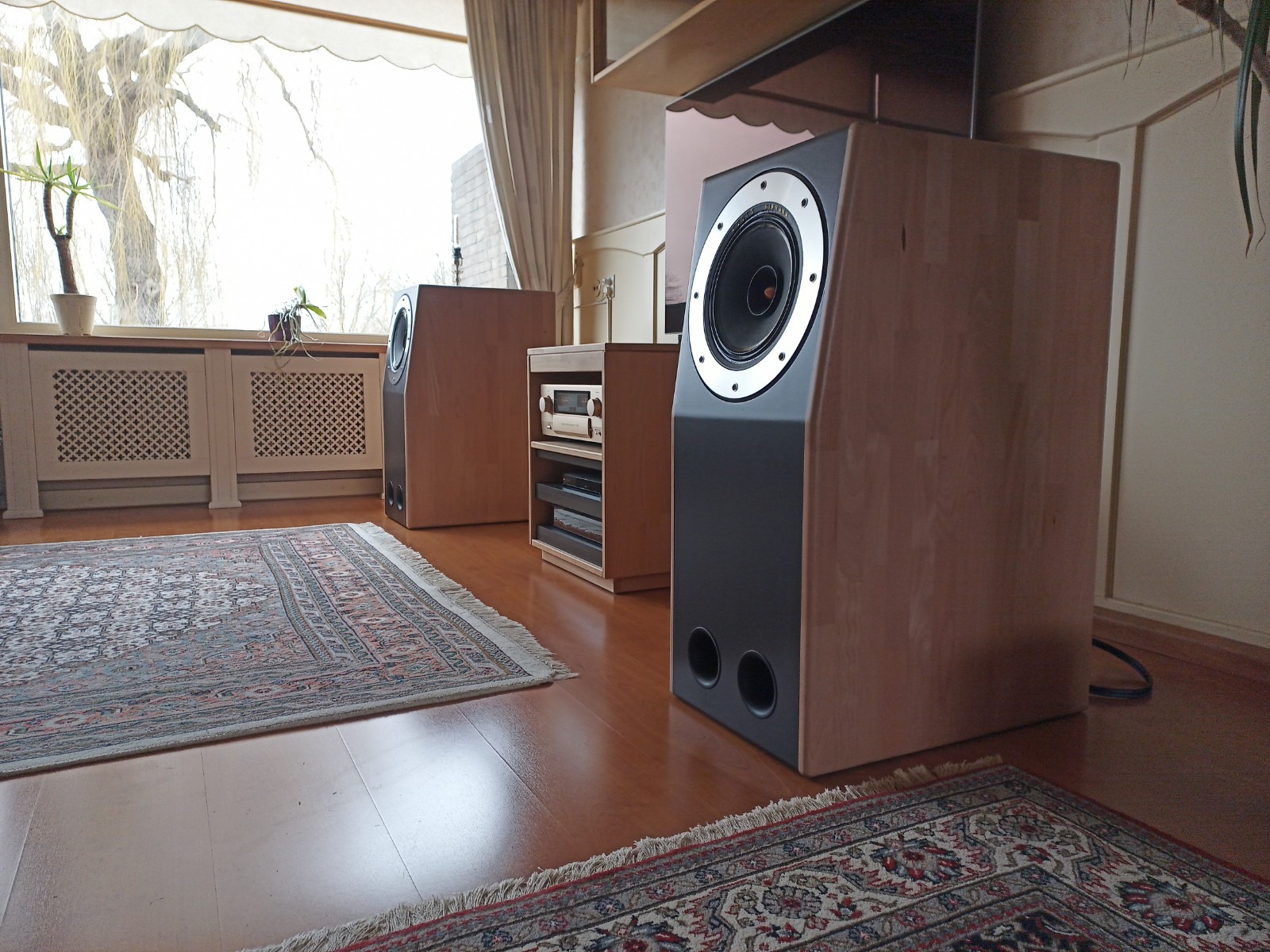

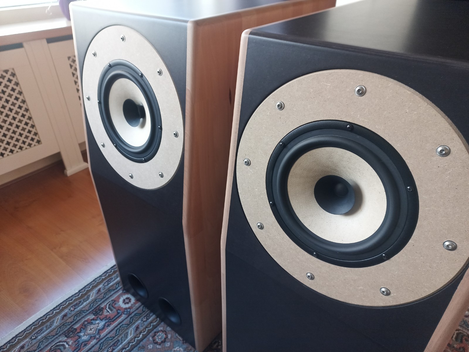

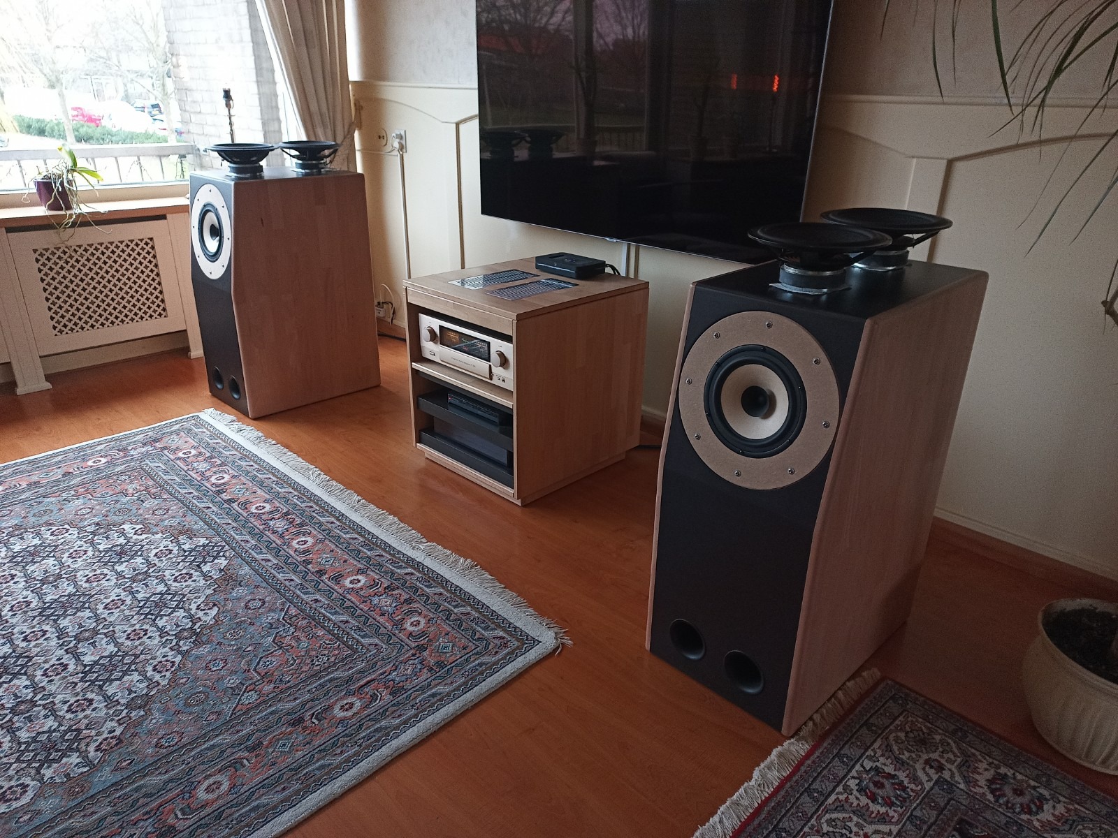

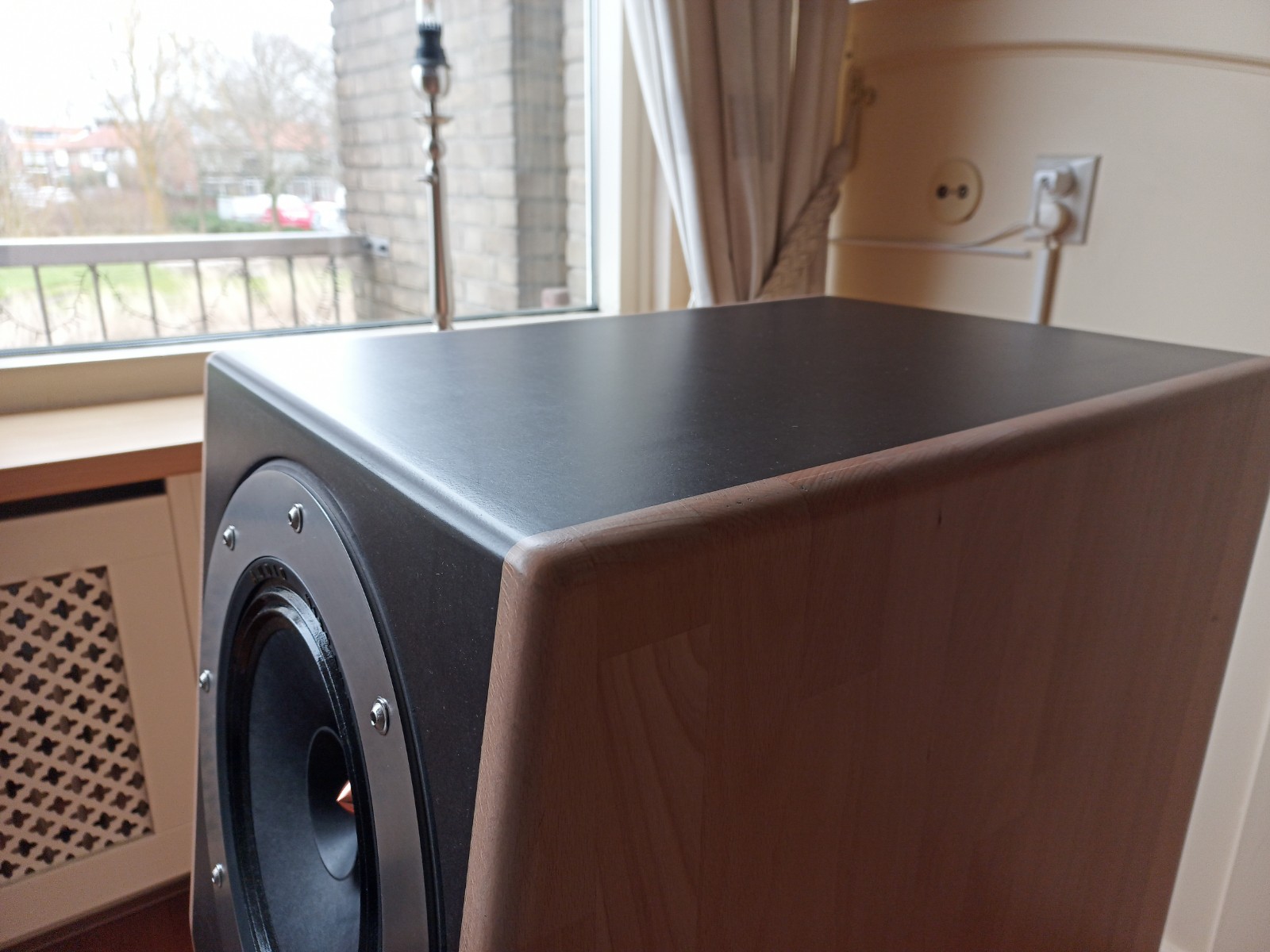

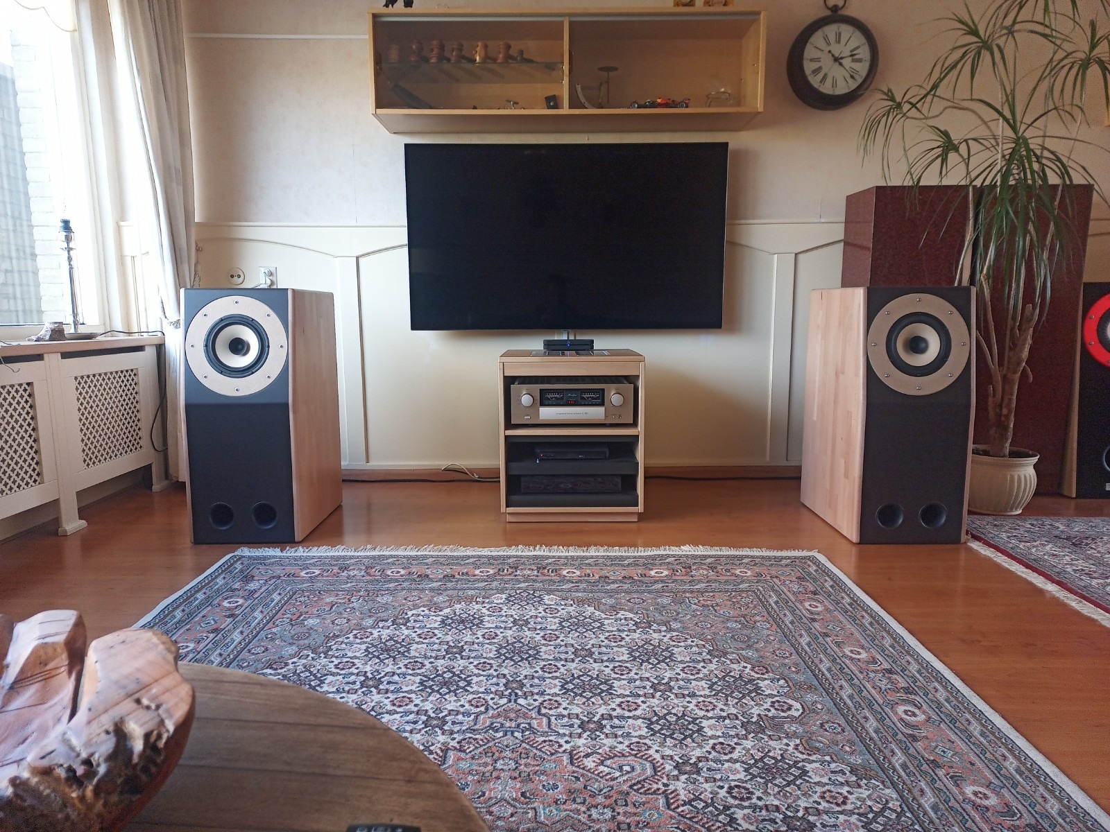

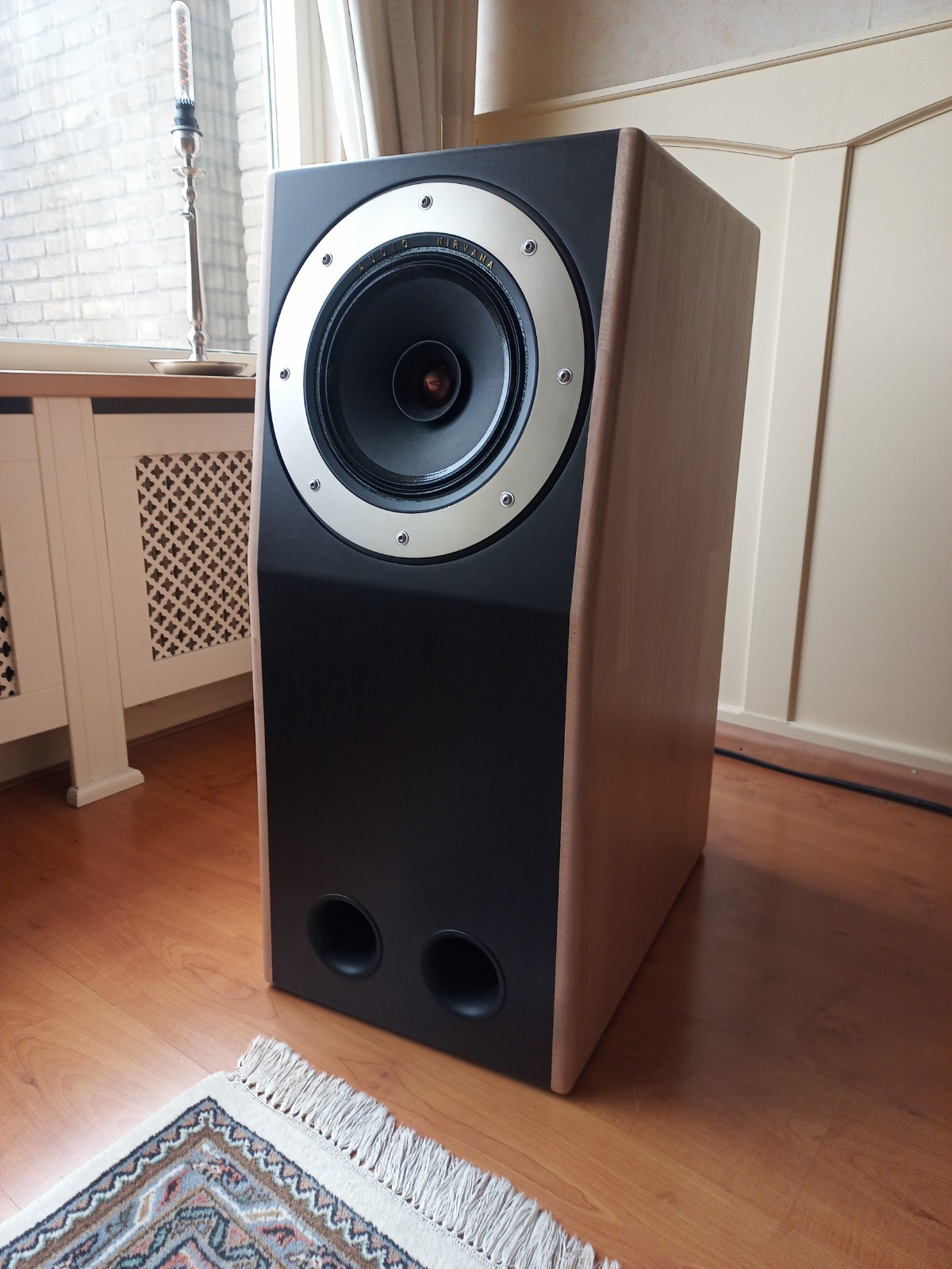

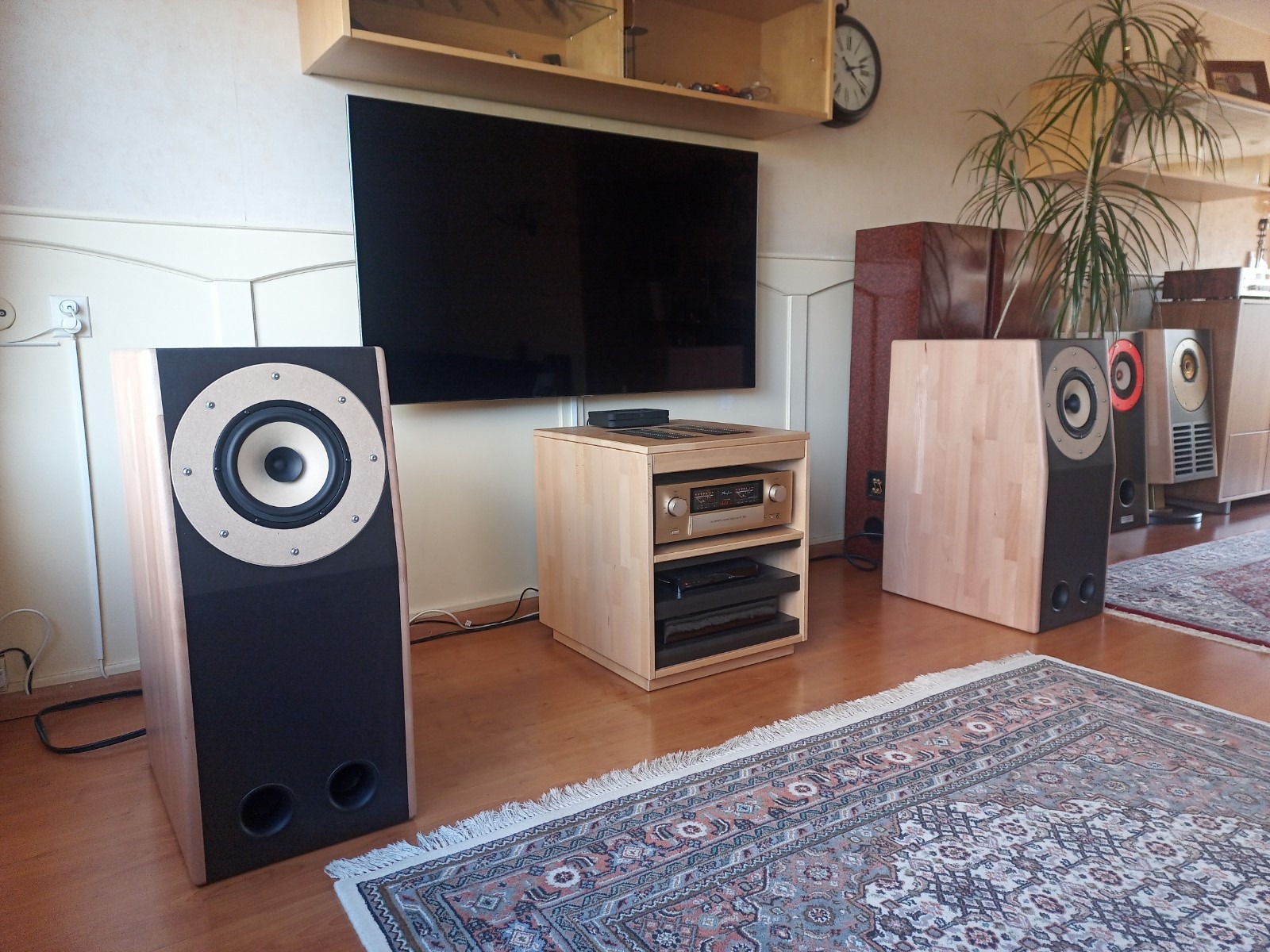

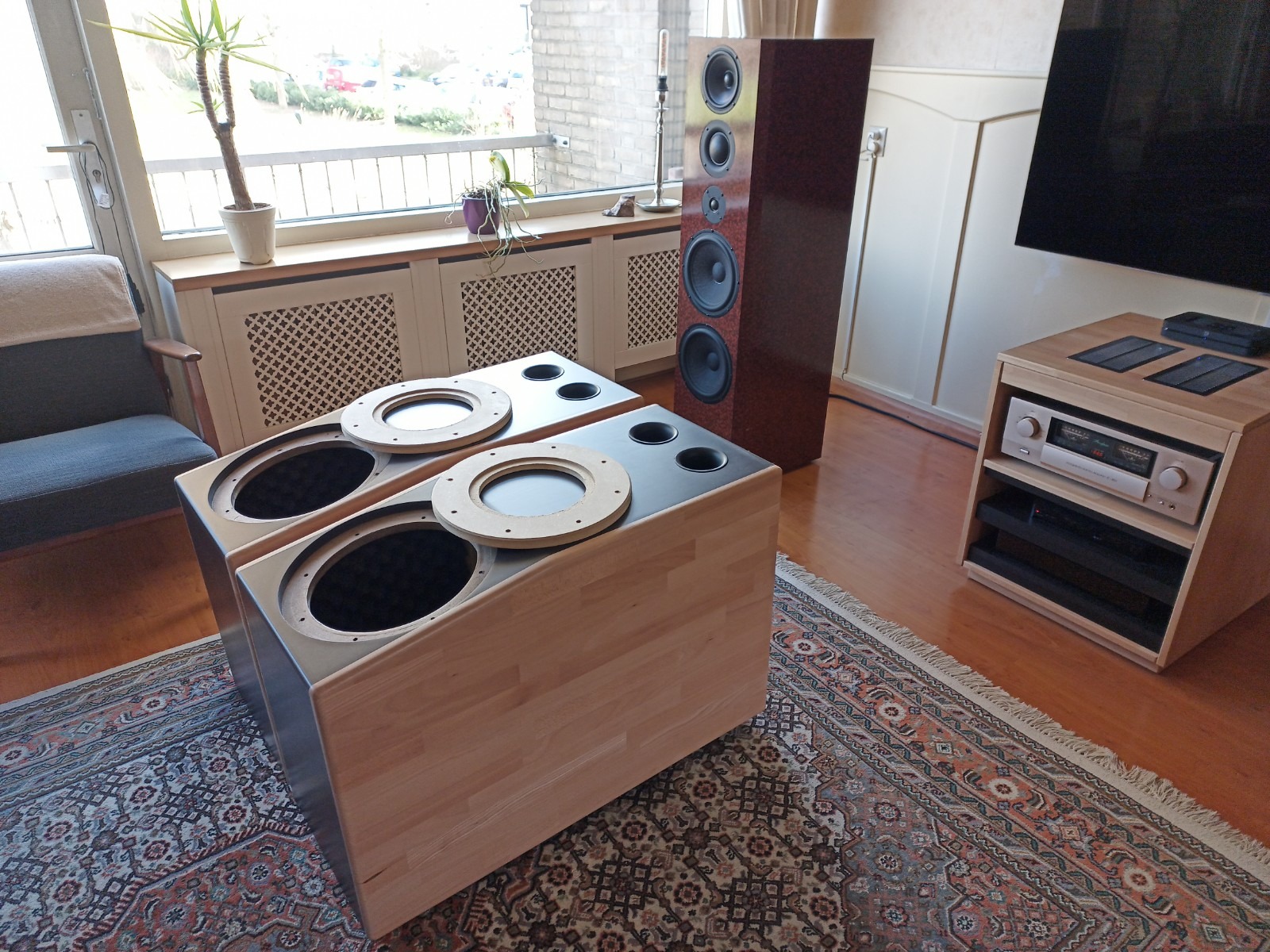

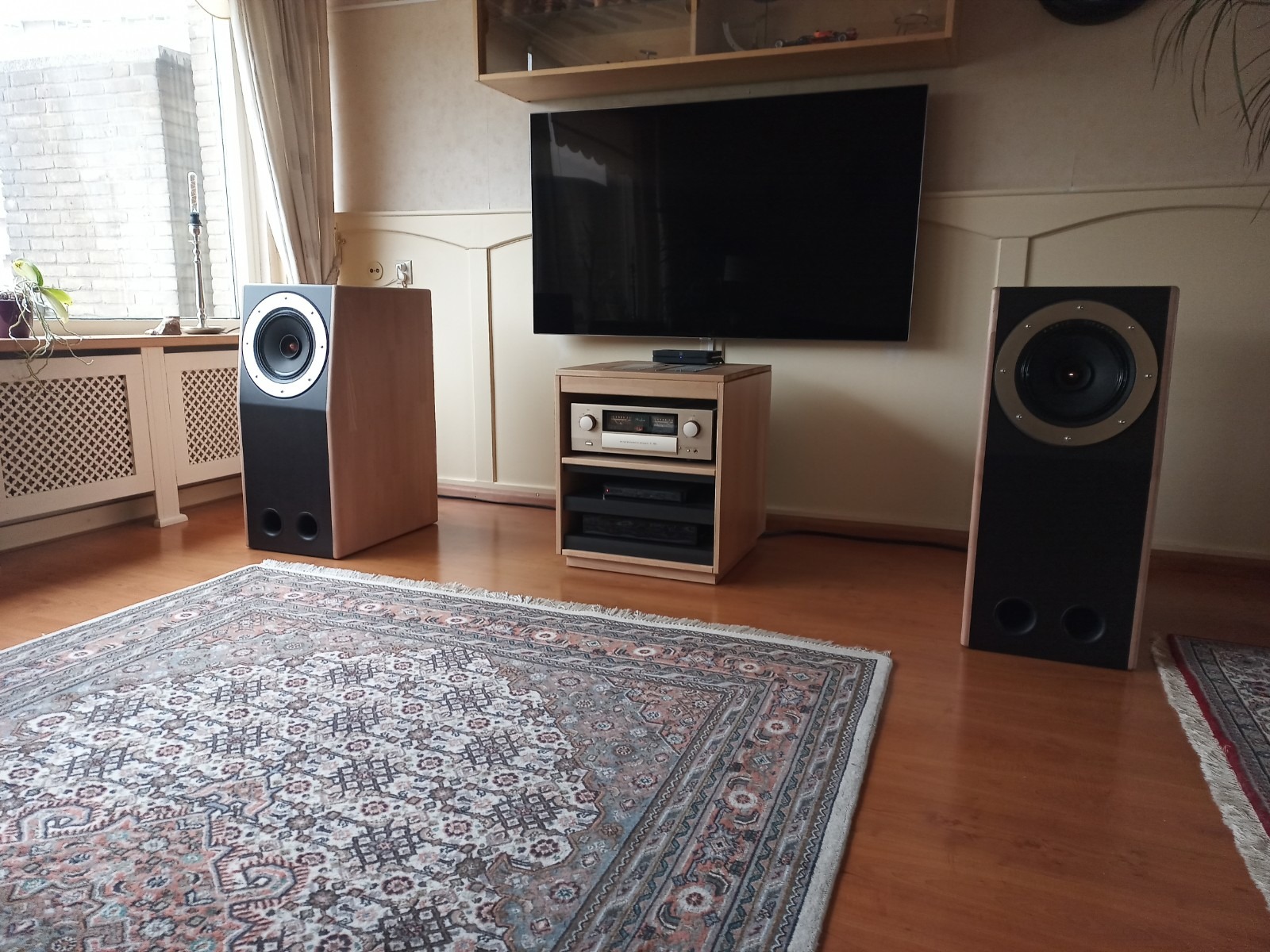

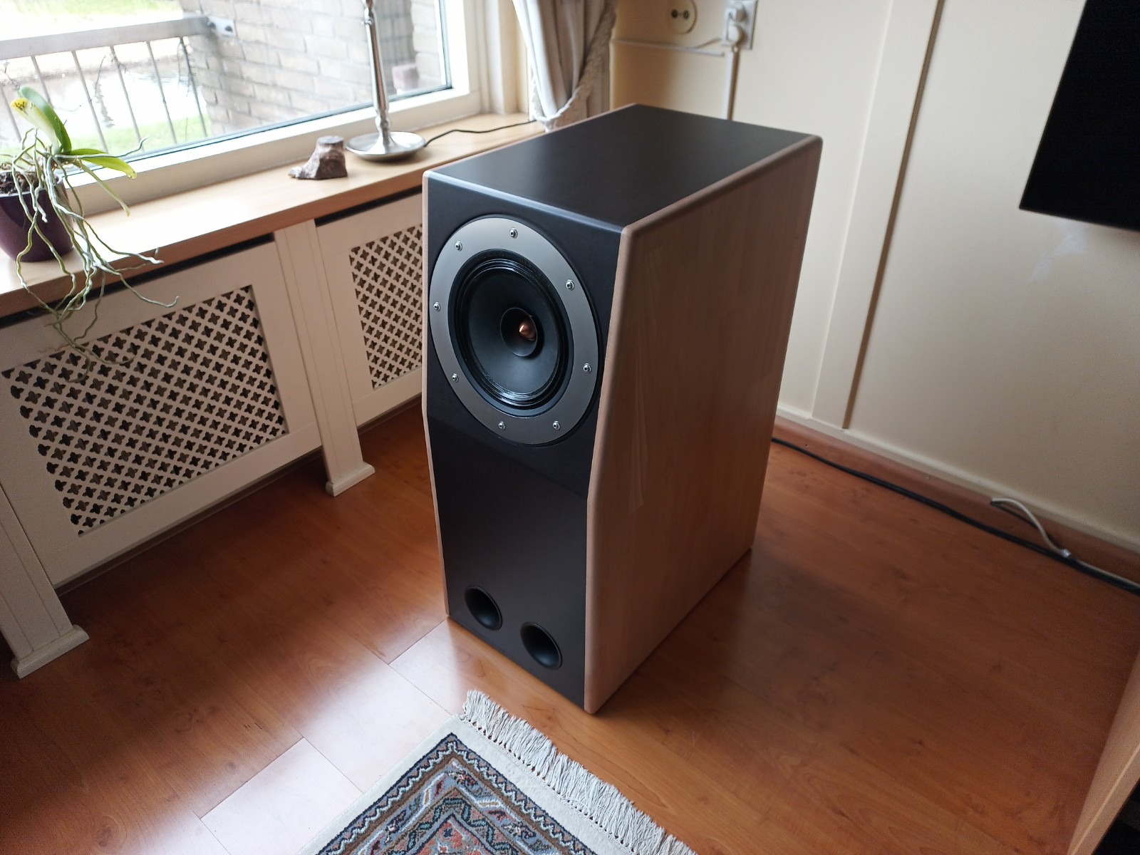

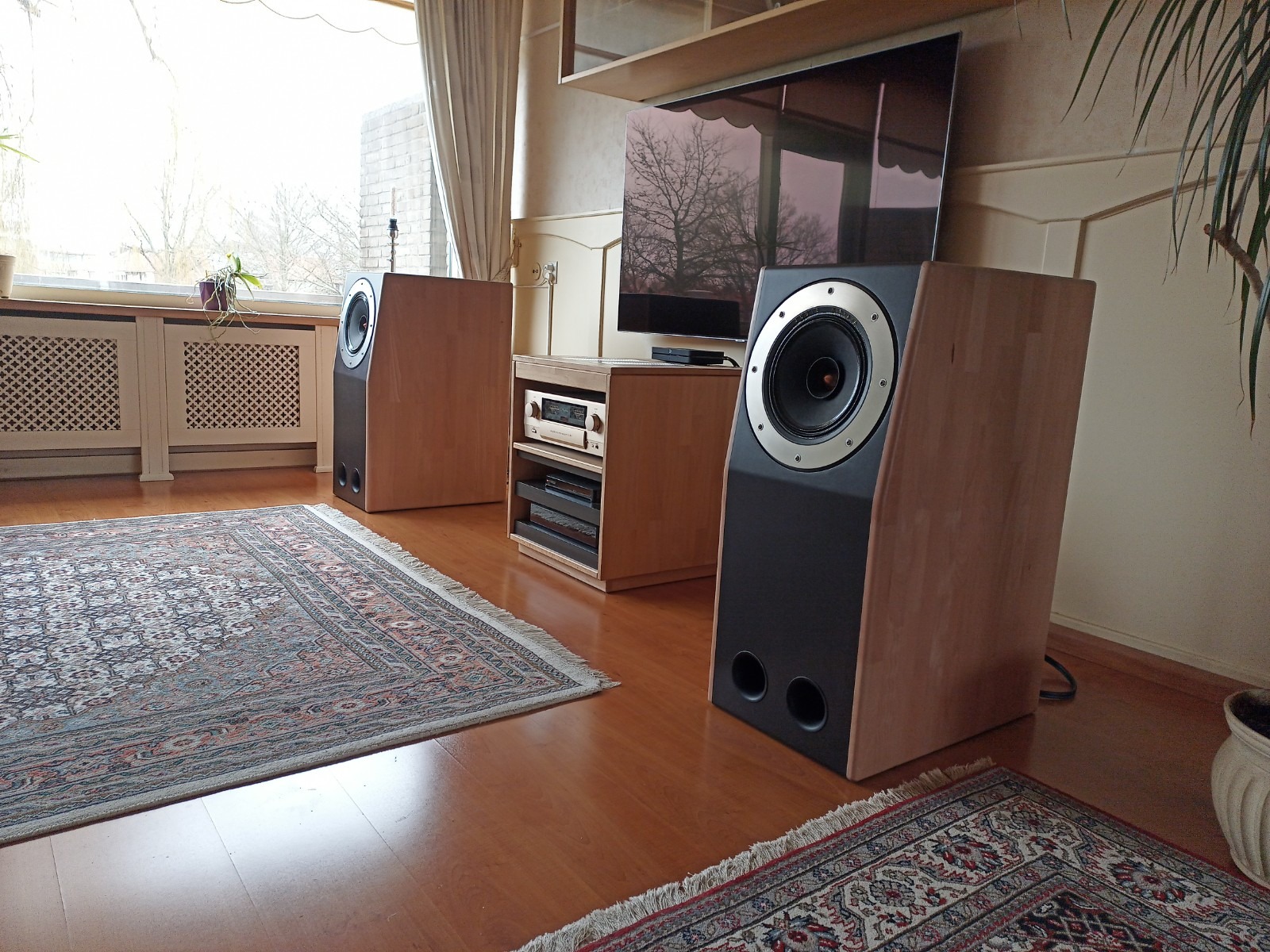

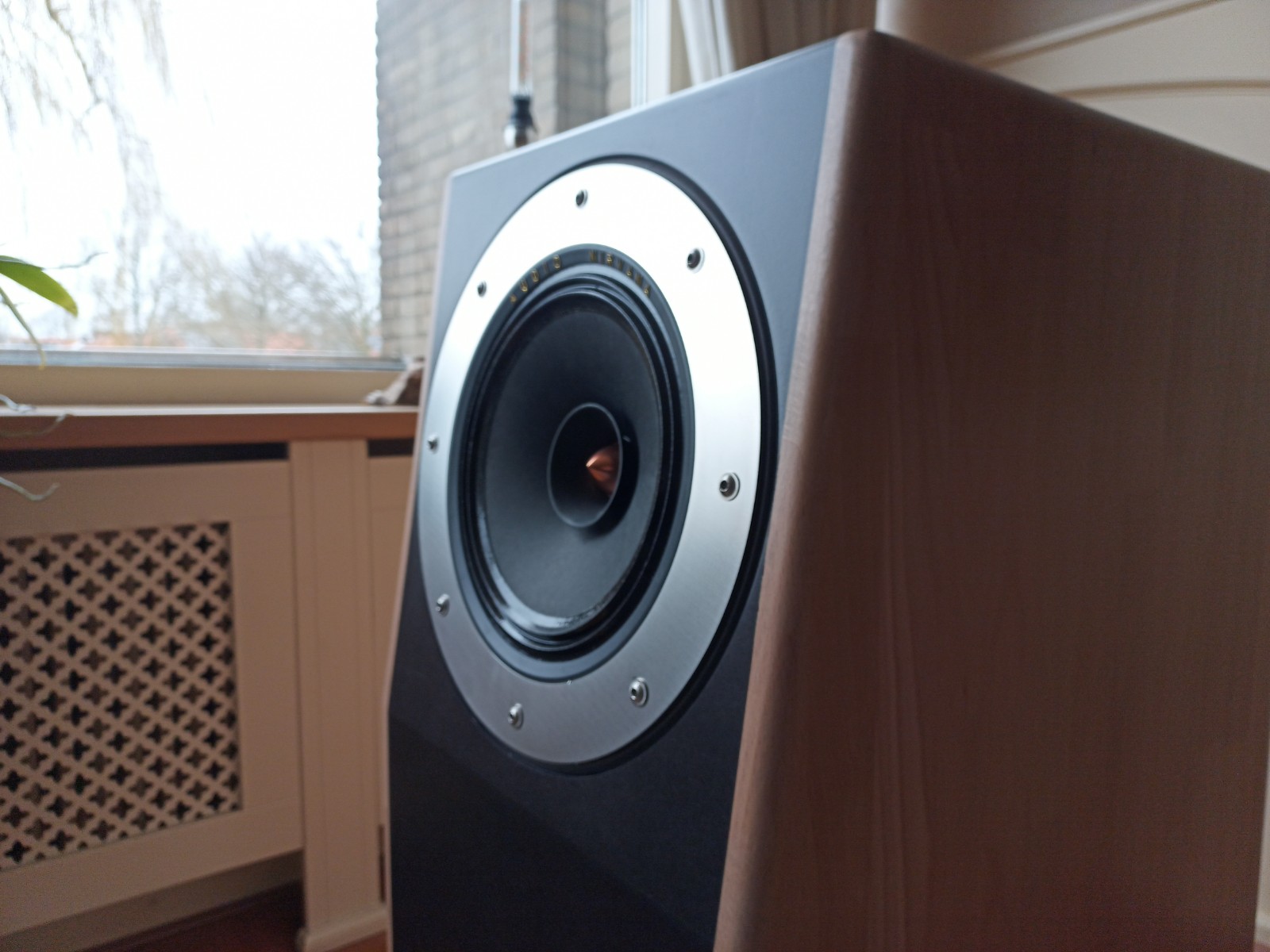

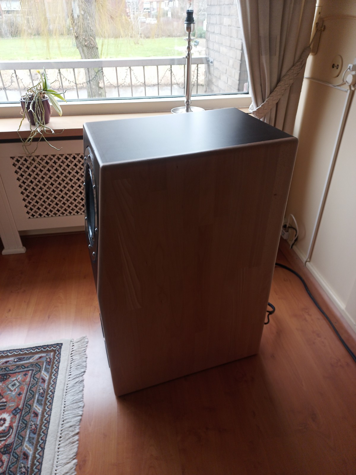

And they are ready 😍😍.
Only I have to add some feets.
Very nice sound, even without any filter component!
Goes very deep en enough detail.
Happy with the result! 👍👍

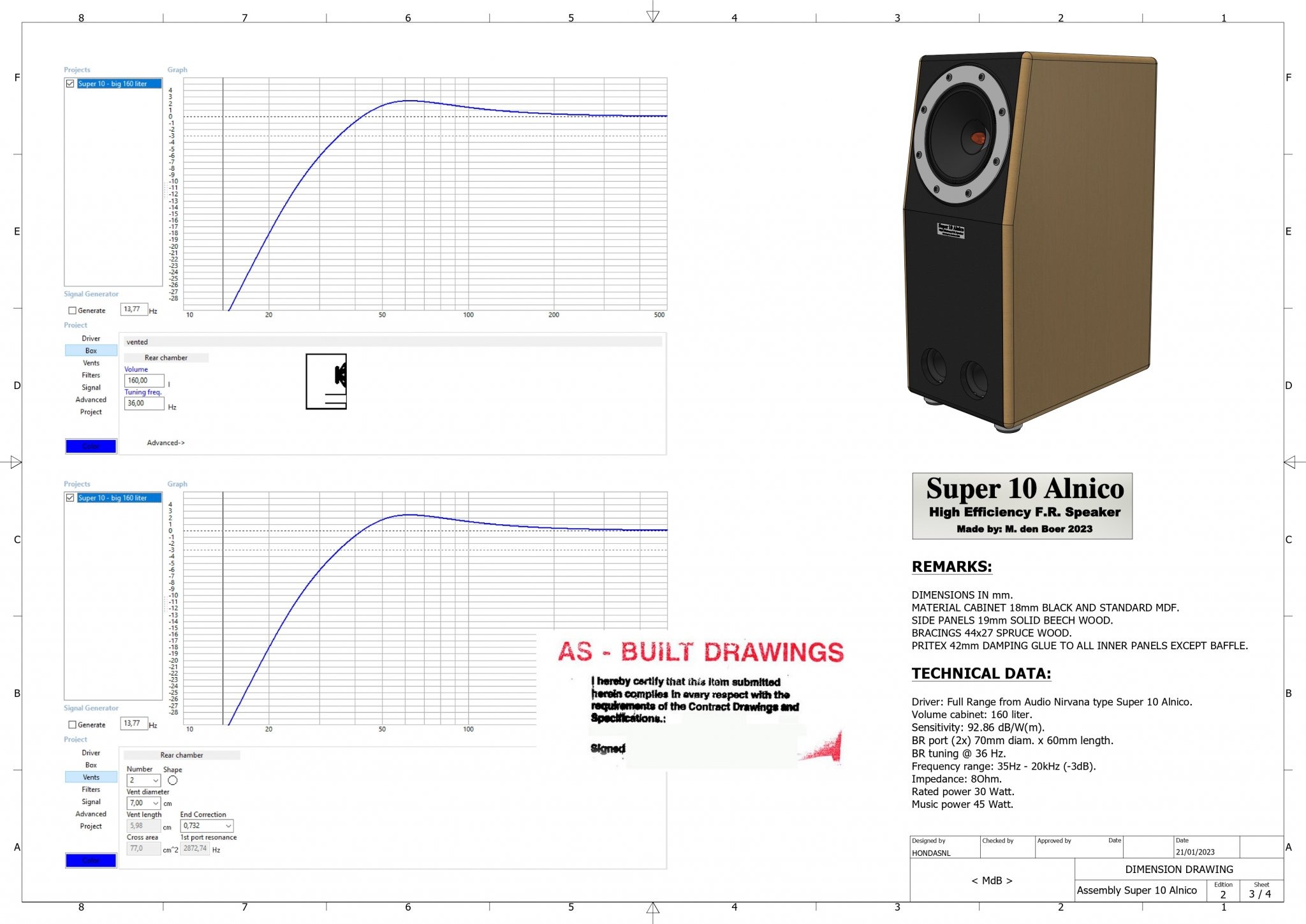

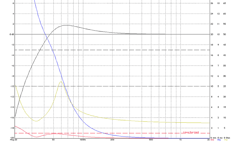

Been following with some interest, finally got around to simming your alignment.
You may need to damp the ports if that big peak before roll-off gets amplified by the room.
dave
dave

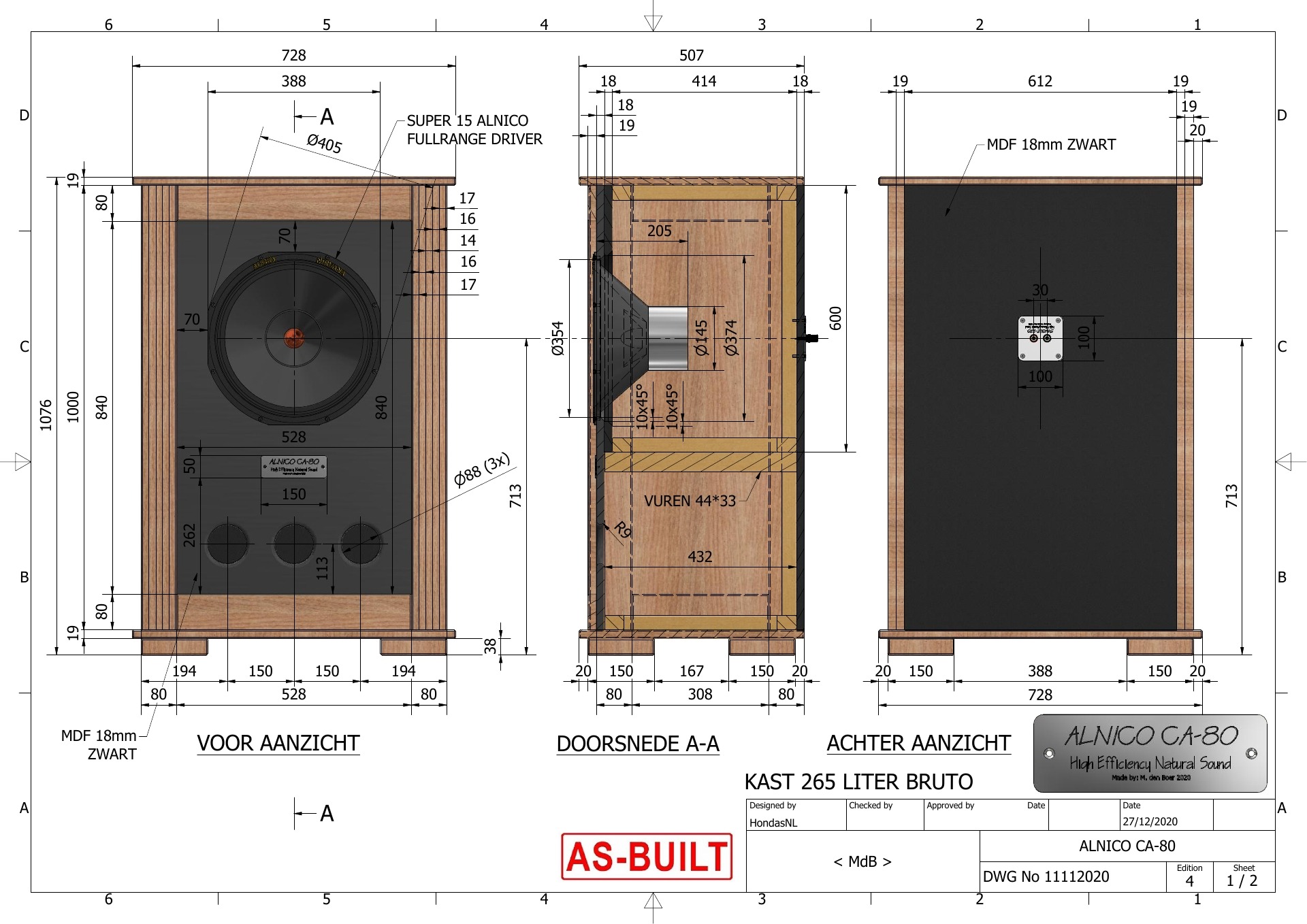

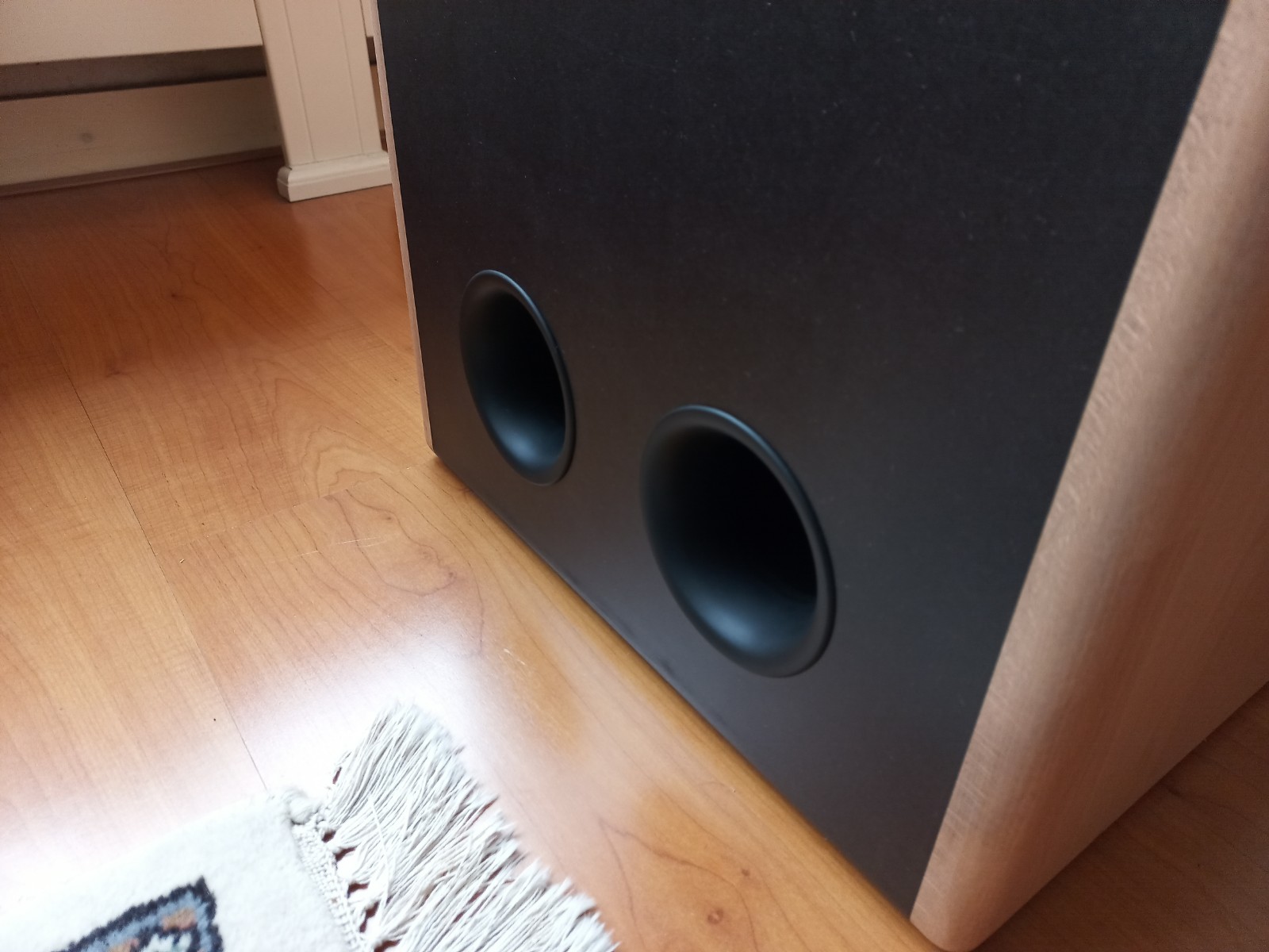

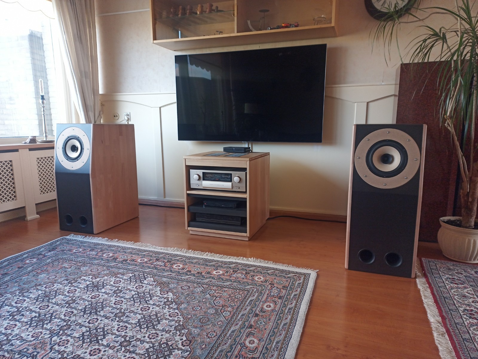

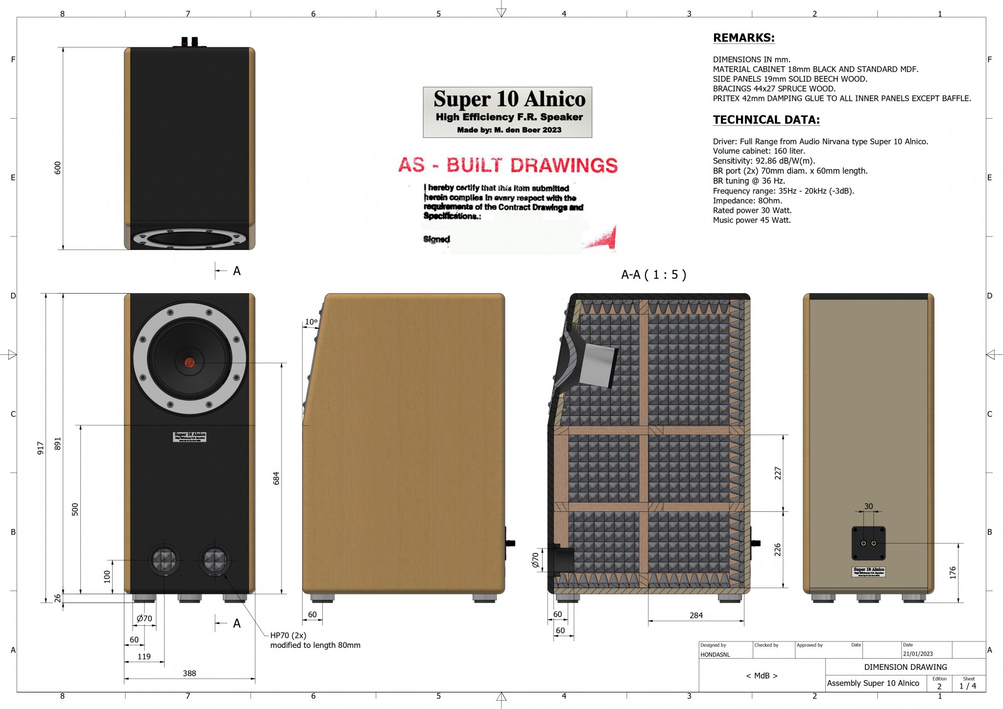

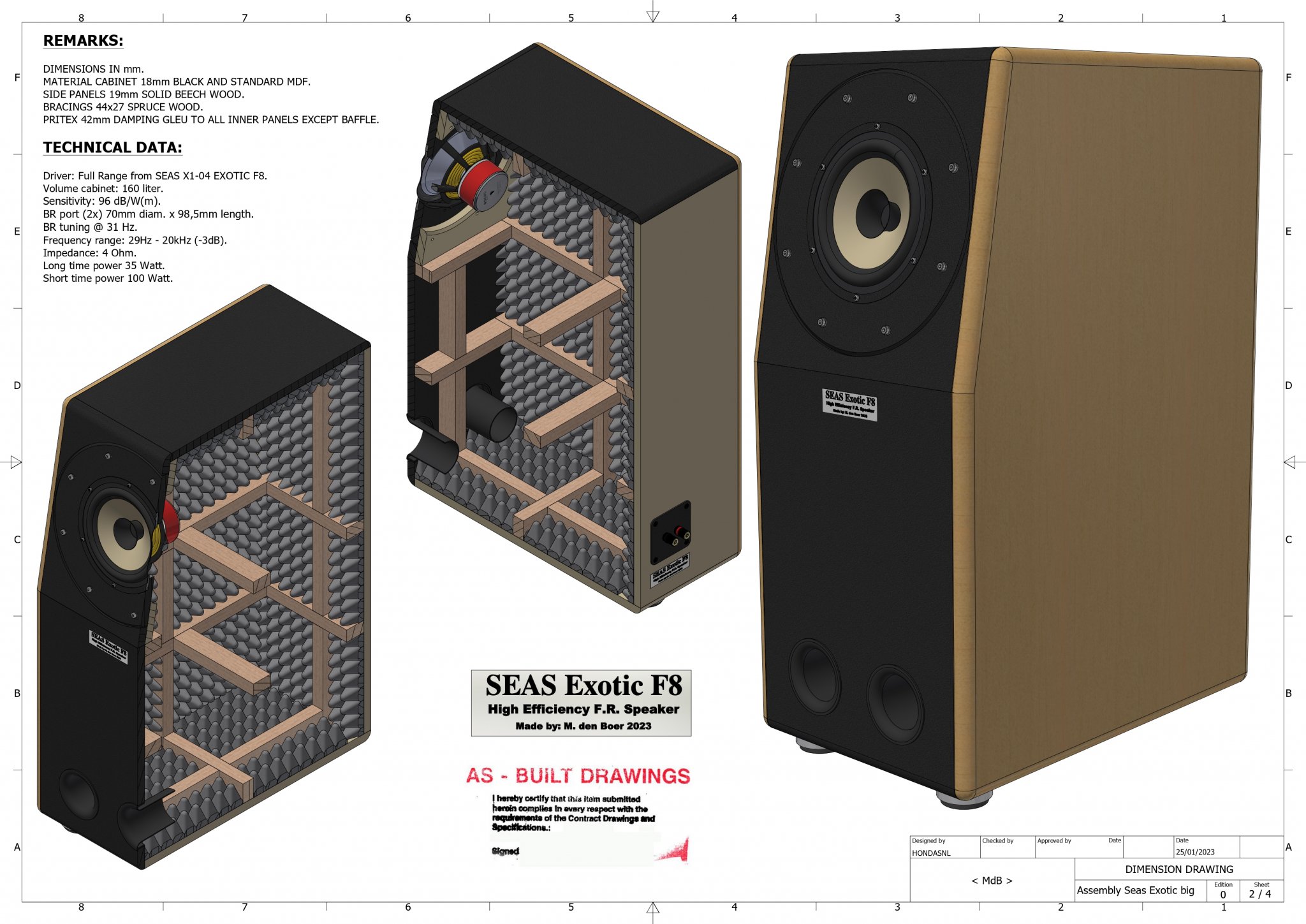

Thank you for repeating the sim in my first post ;-). Practically my room react a little bit different. So I modified the length of the ports after some listening hours. Sims are a good starting point but not that good for your unique setup.
The rise in response starts below 300Hz and reaches +2dB. It looks like just about right amount of baffle-step correction for average room conditions.
Some details please about ports lenght modification.

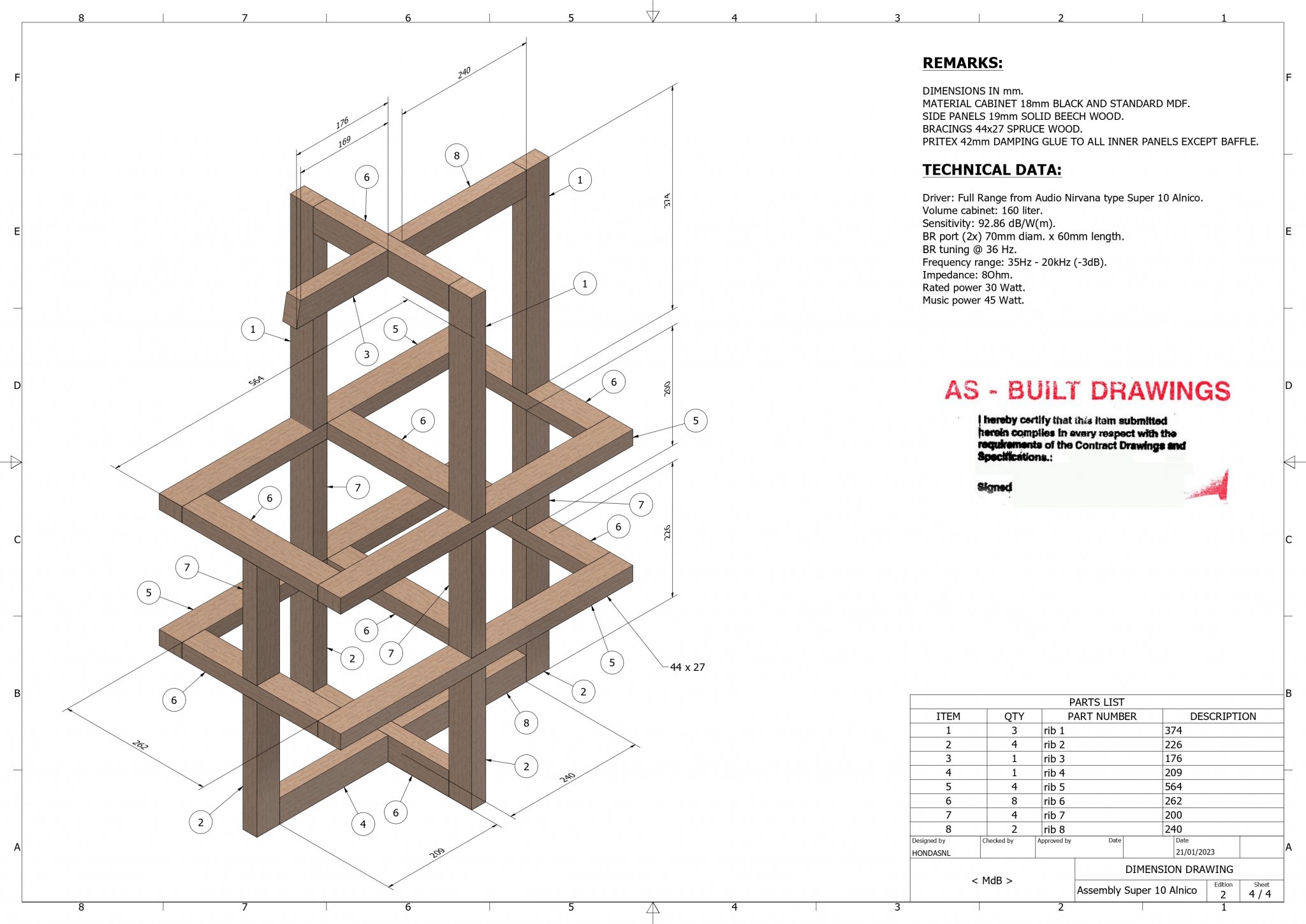

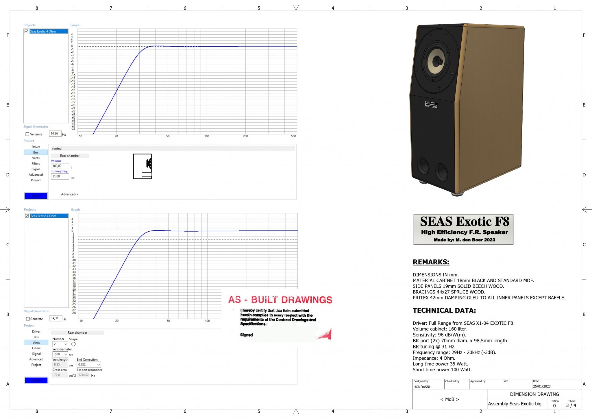

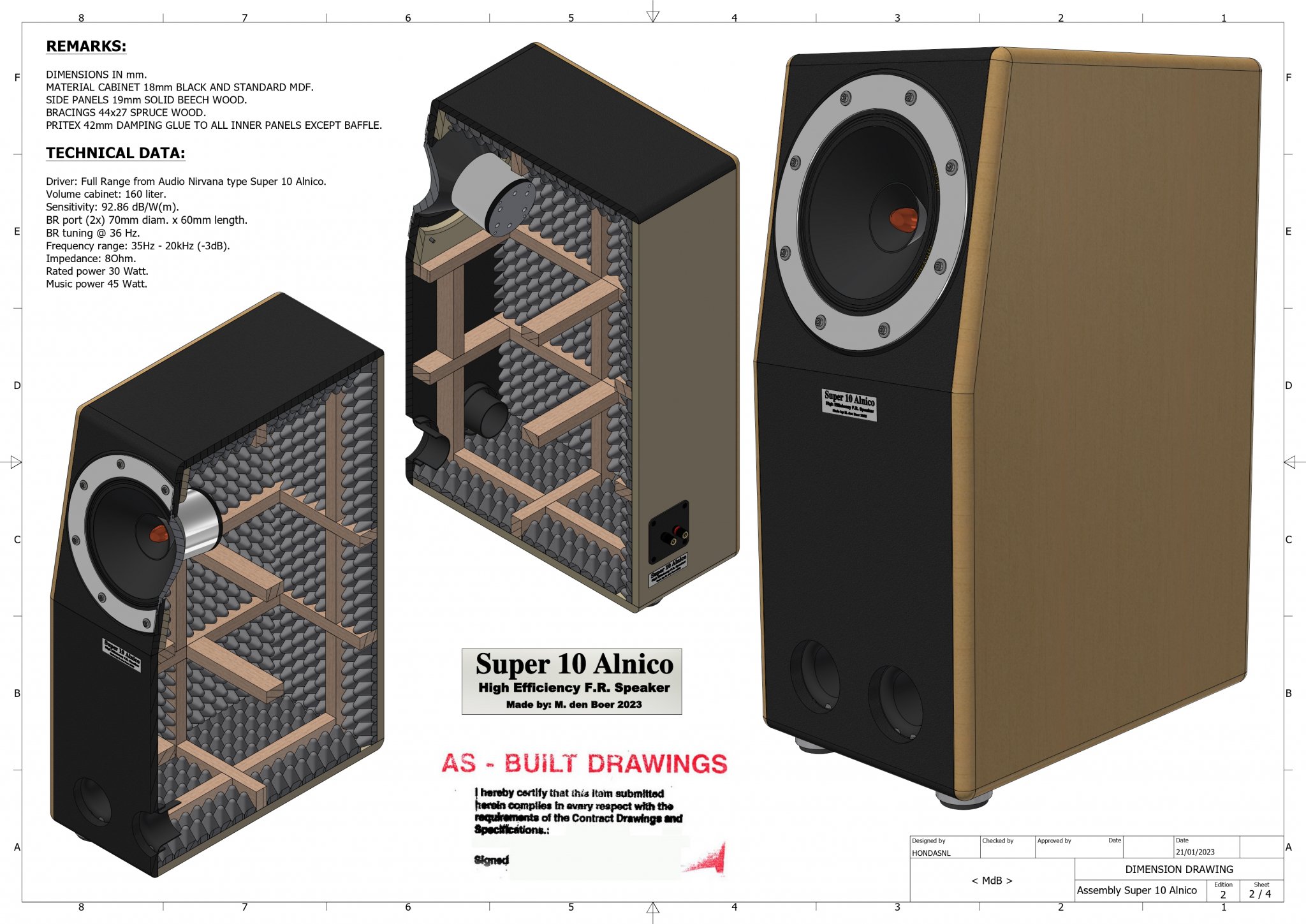

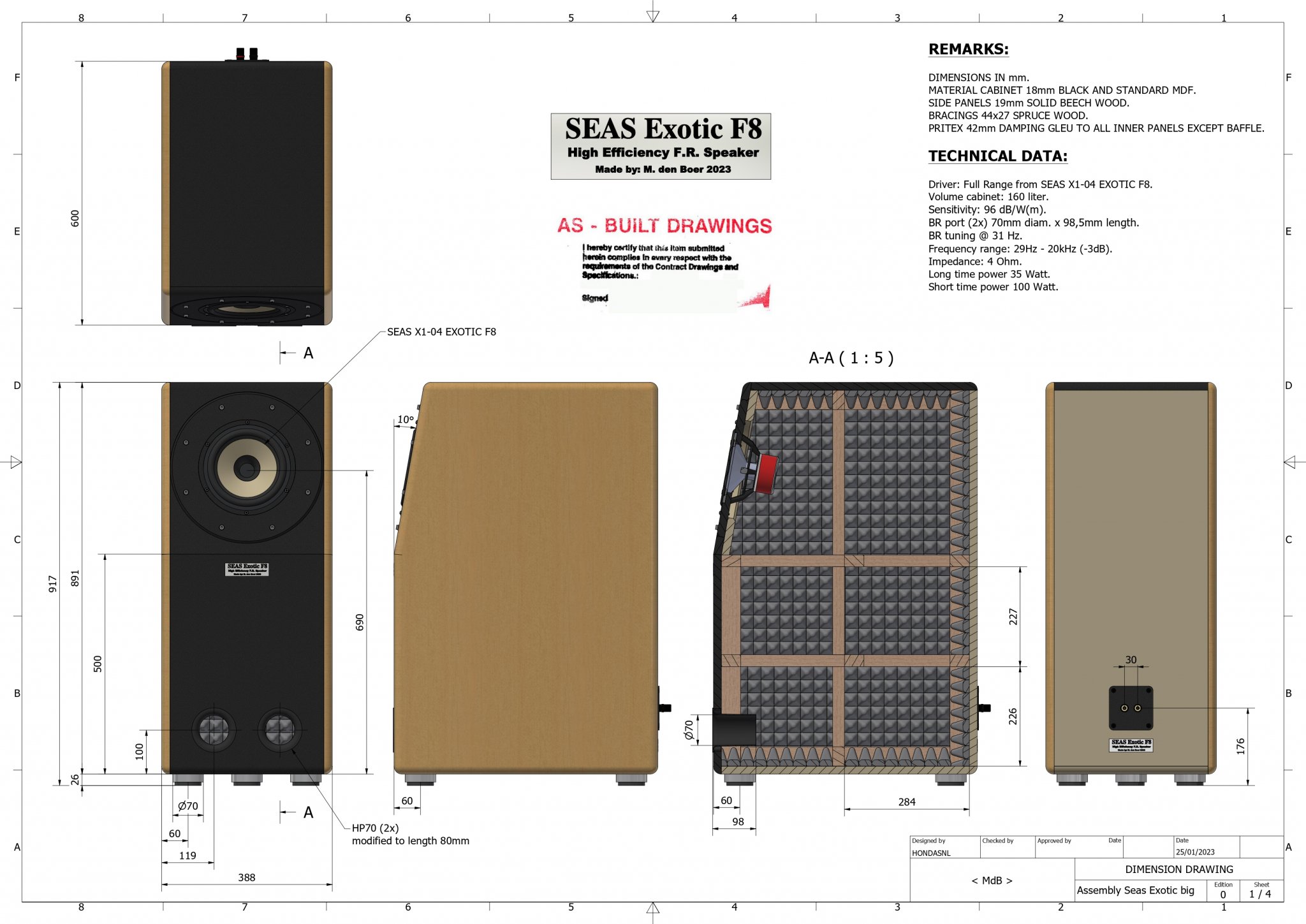

As promised, hereby the as-built drawings with the correct port lengths and settings.
Do what you want with it ;-).
Conclusion is that these drivers (in 160 liter) perform very well and goes nice deep without any irritating producting of lows.
Believe it or not, everything is in good balance, not perfect but very good.
This because I think that the most full range drivers have more efficiency in the mid-lows / mids and highs than the lows.
You also can see that on the data sheet.
Overall a very very nice and simple project without any filter component.
Thank you.
Thank you.

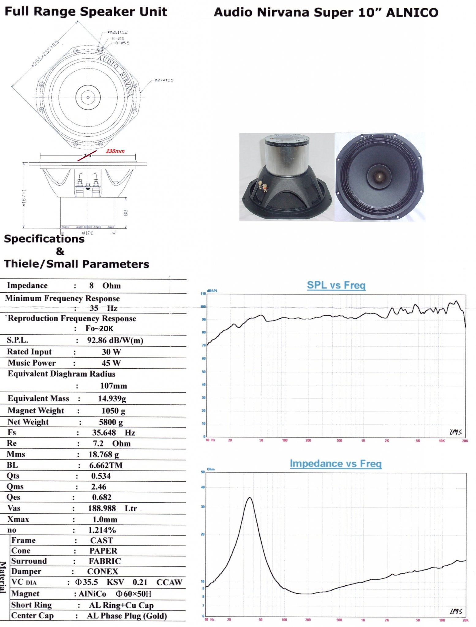

Baffle Step will start about 300 Hz, the peak is too low for that.
dave
Thanks!As promised, hereby the as-built drawings with the correct port lengths and settings.

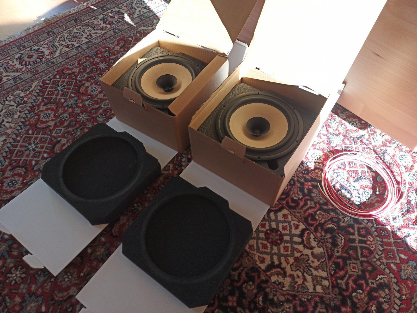

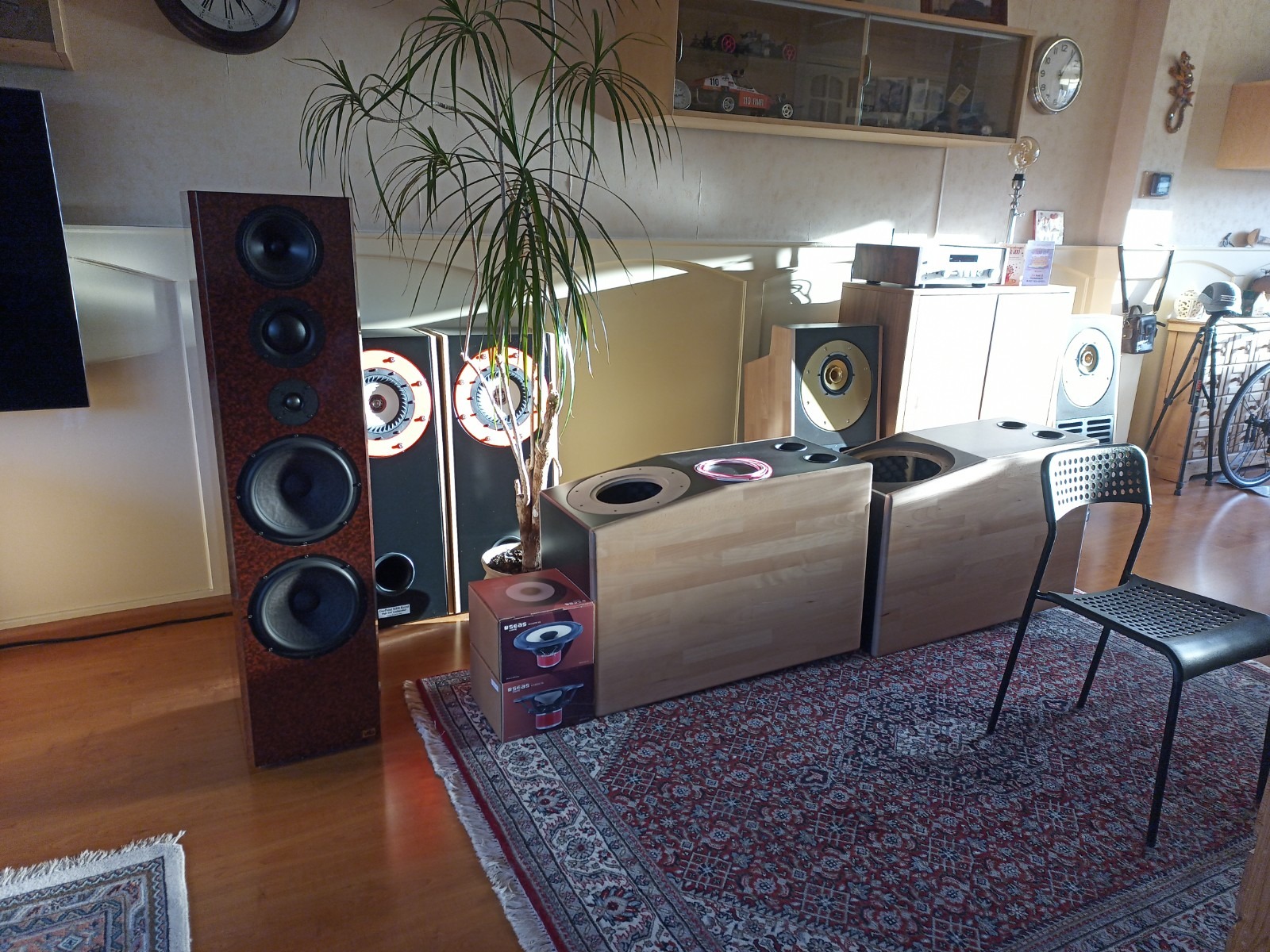

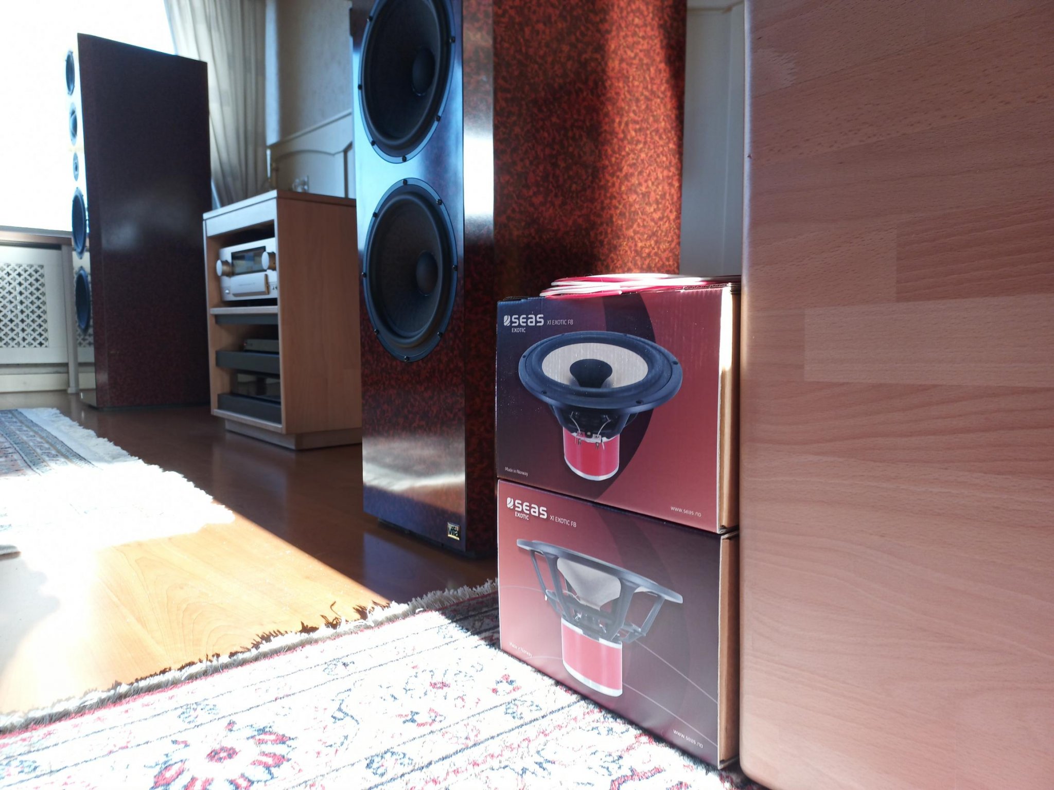

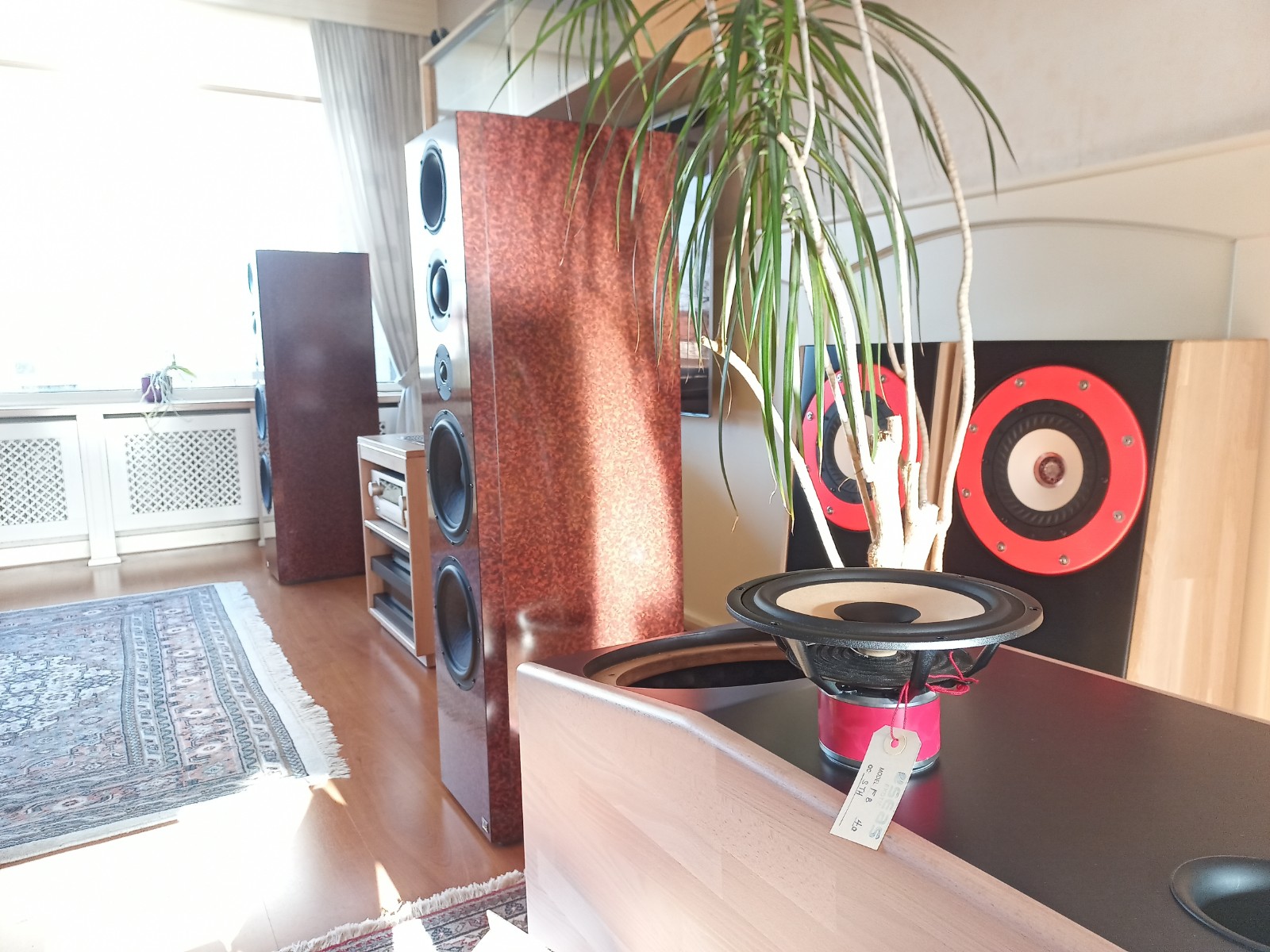

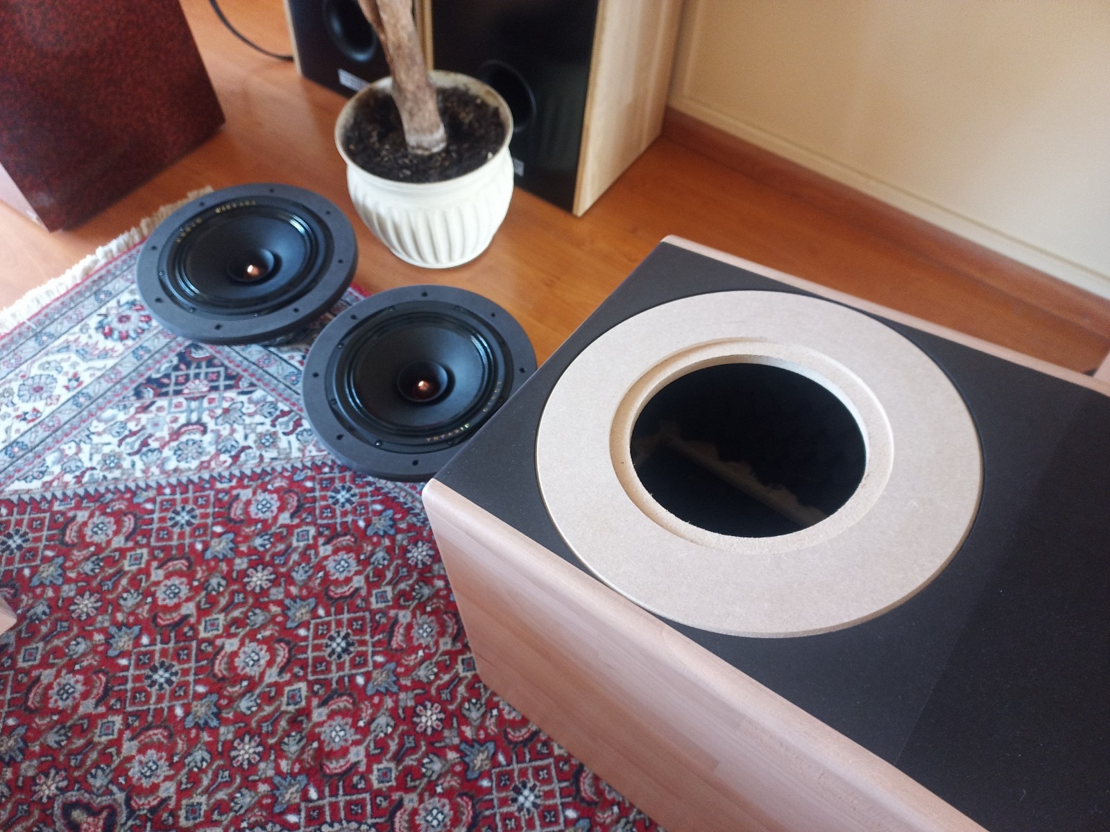

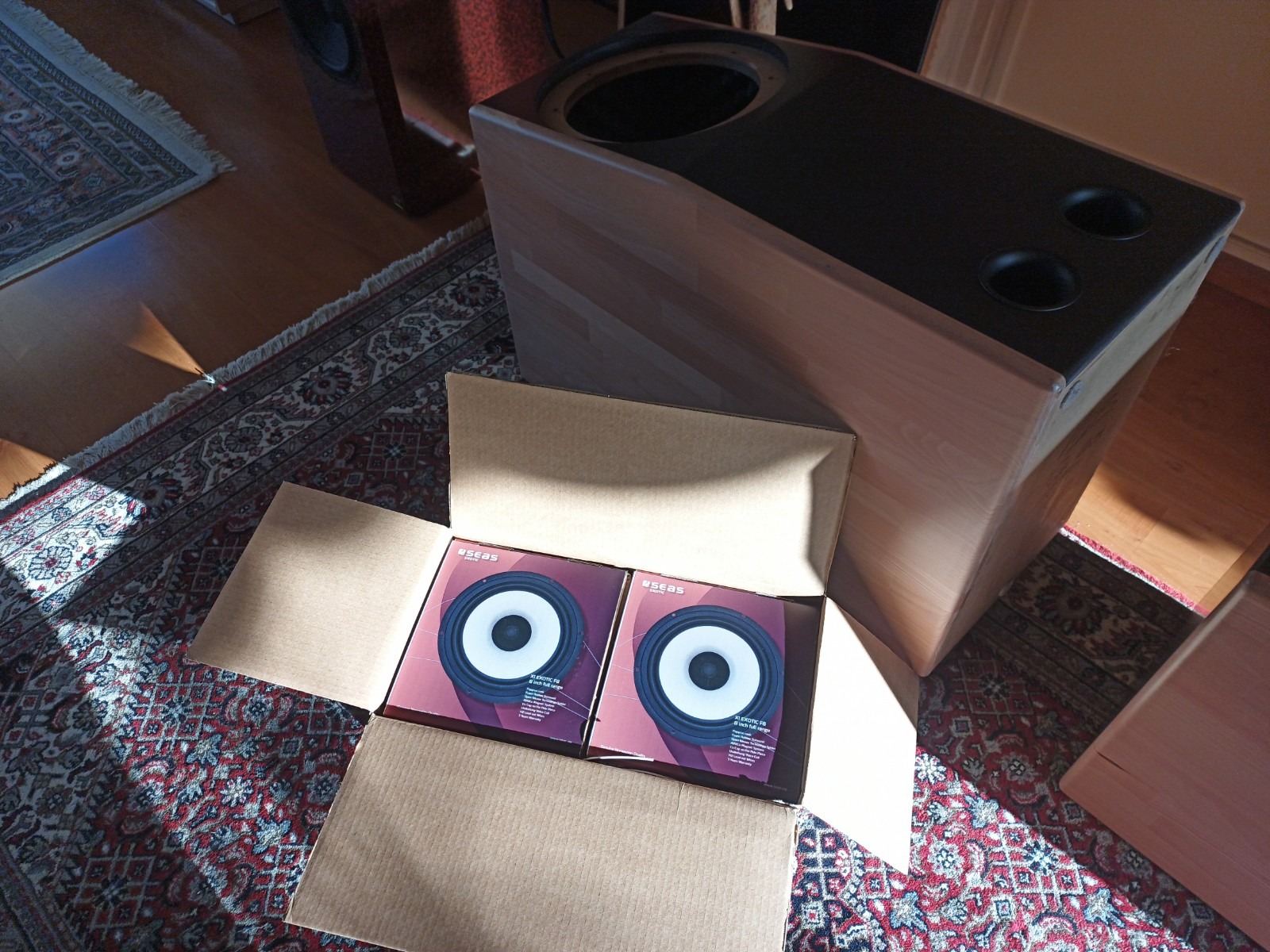

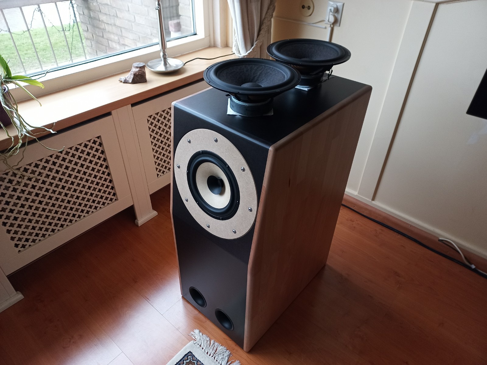

Waiting for what those beautiful SEAS can do....
Very very beautiful.
Just the packaging already.
Very very nice drivers, Superior.

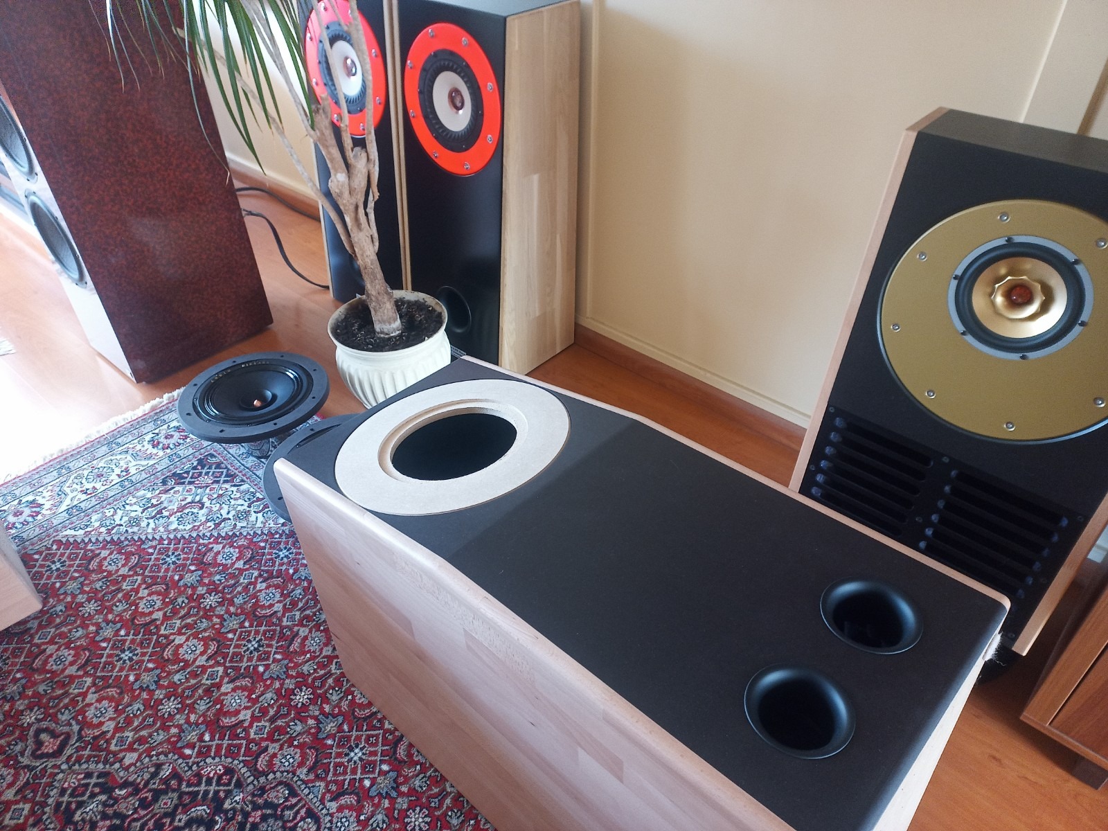

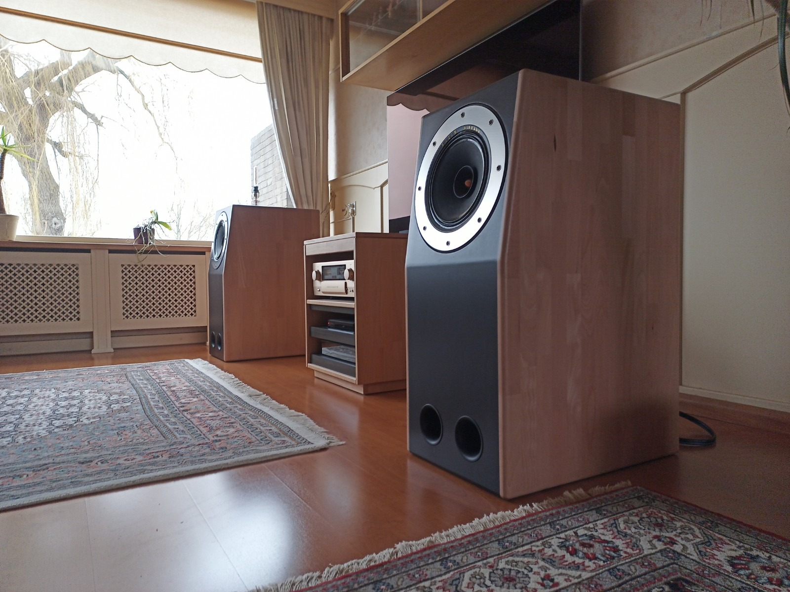

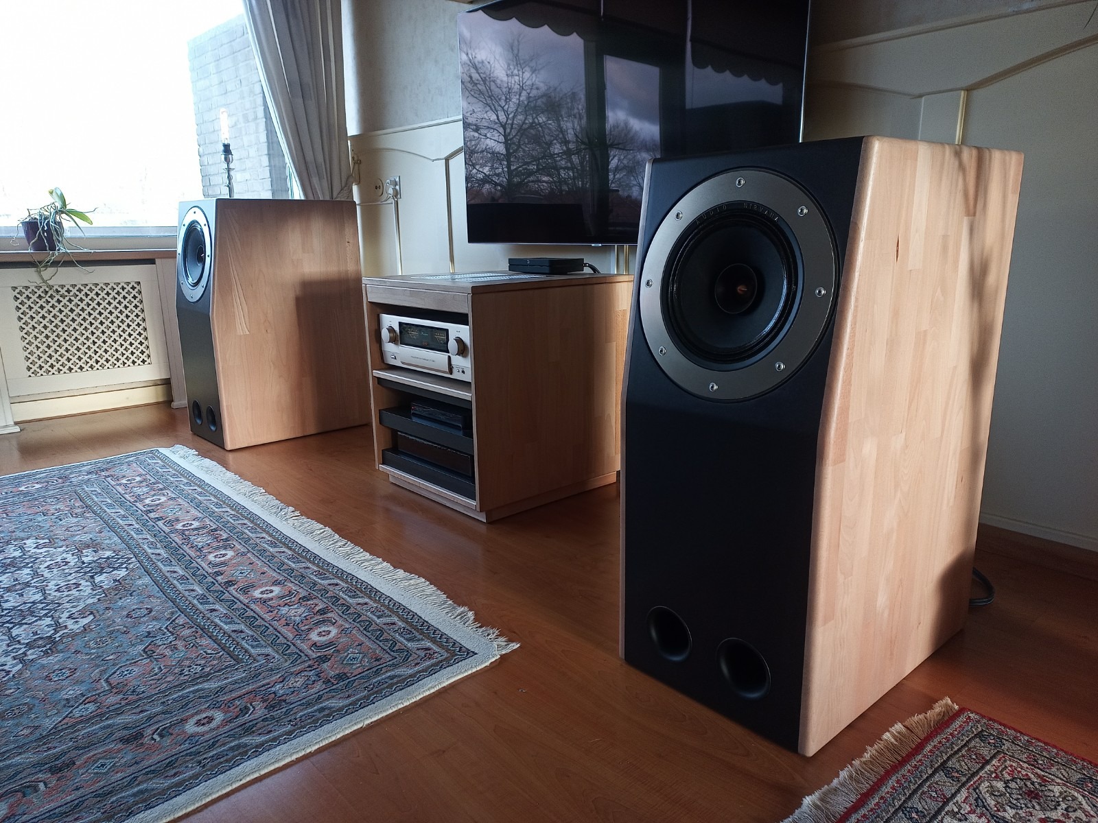

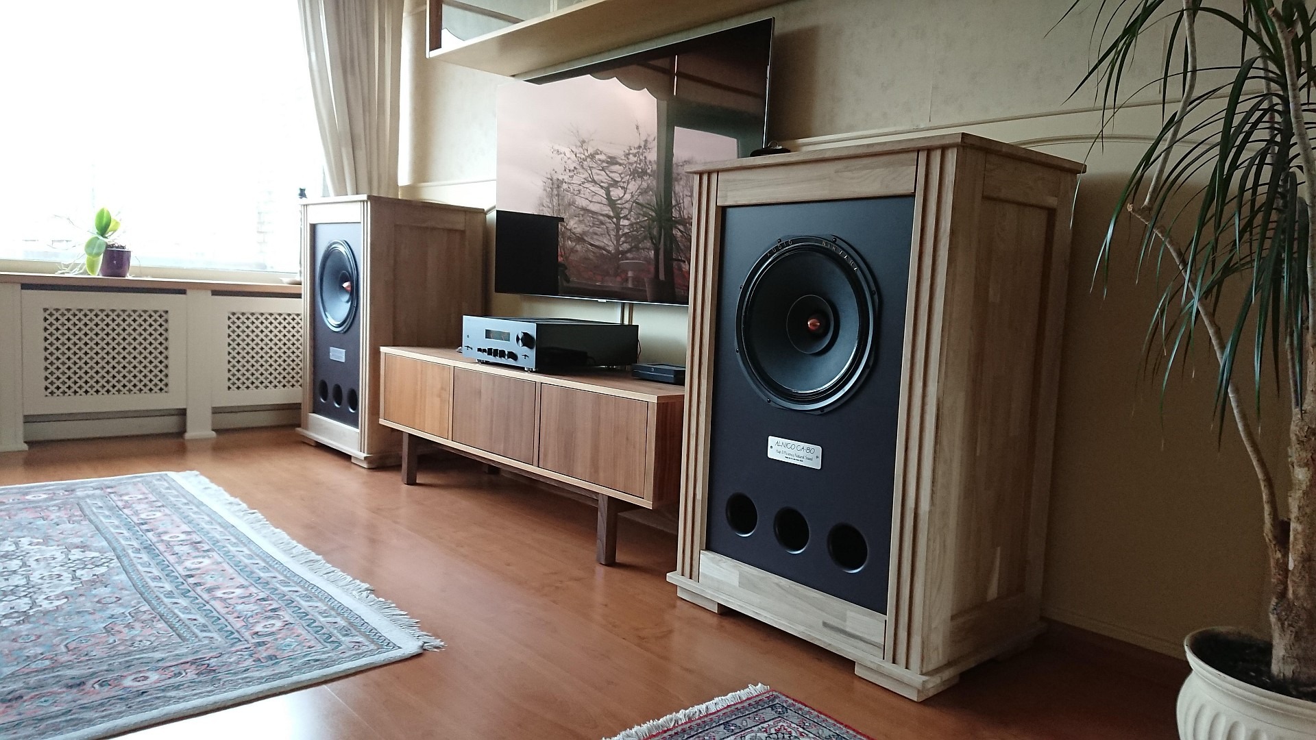

Wow! This sounds also very very nice in this cabinet 👌 👌 😍 😍

Makes sense.
Qts .44
Vas 143 L
Fs 32hz
Ideal 4th ported is over 160 liters in area making f3 under 30hz !!!!!
Qts .44
Vas 143 L
Fs 32hz

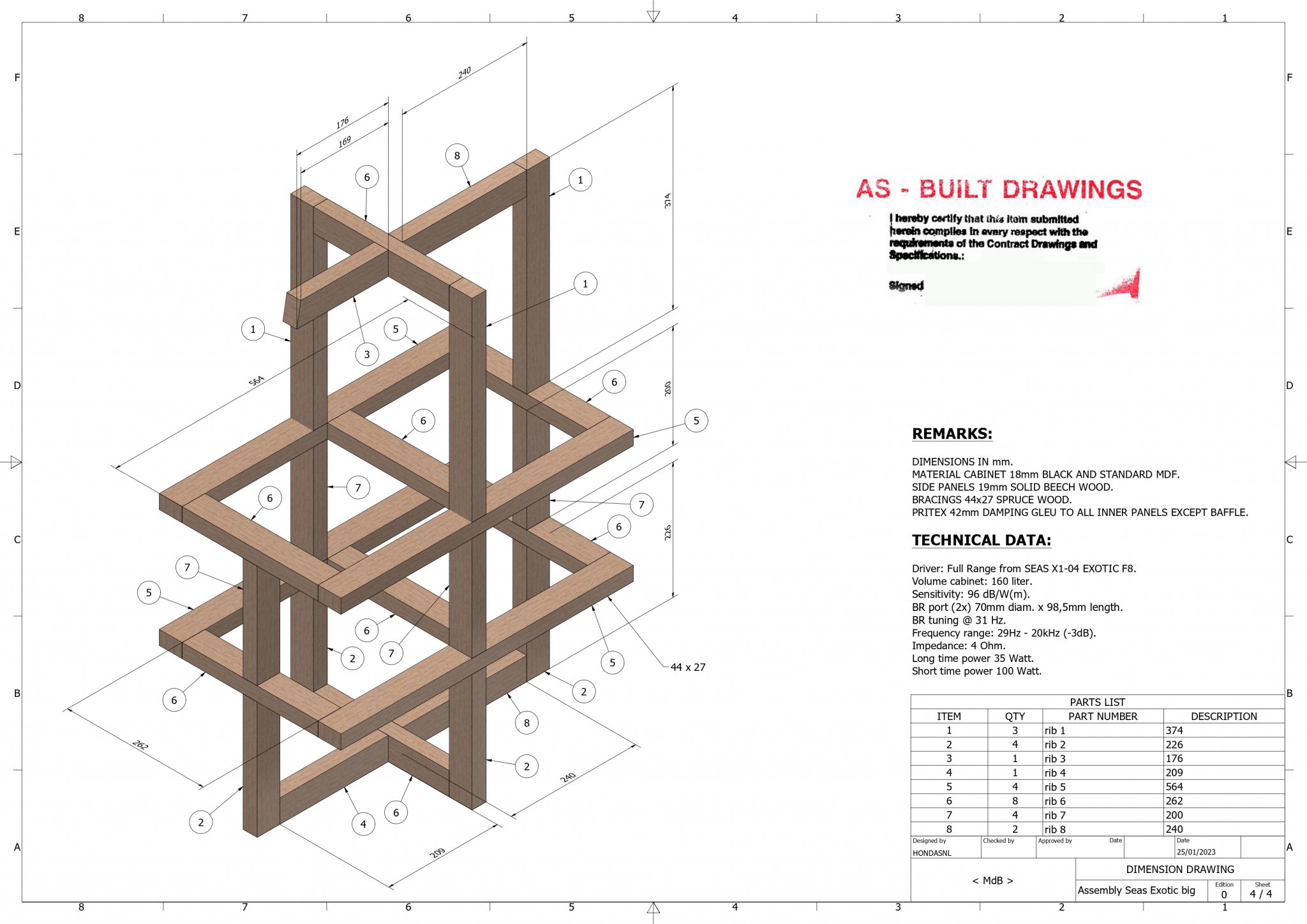

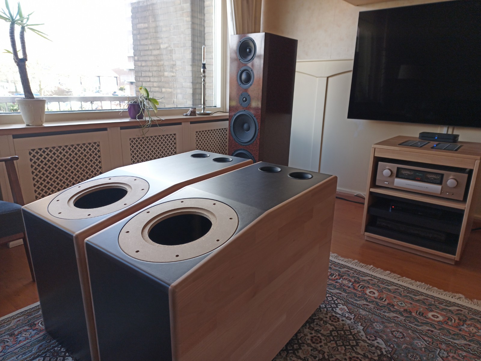

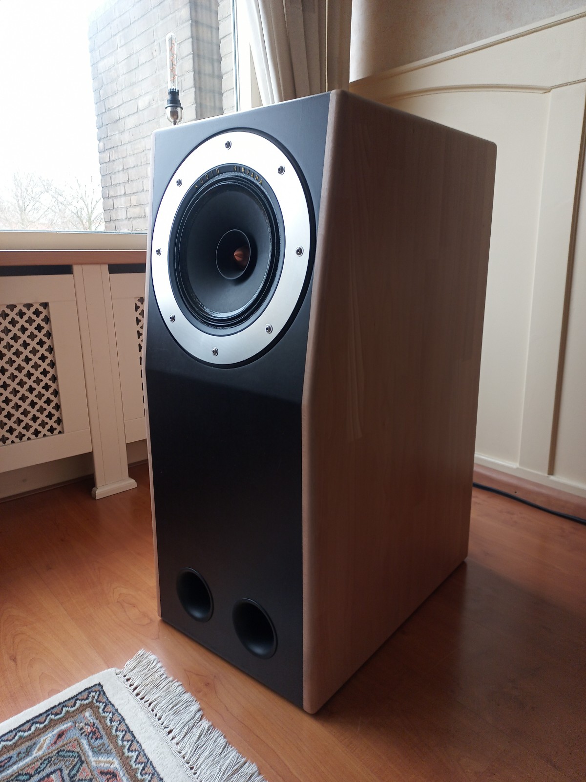

Here the As-Built drawings for information.
Nice and easy effective project.

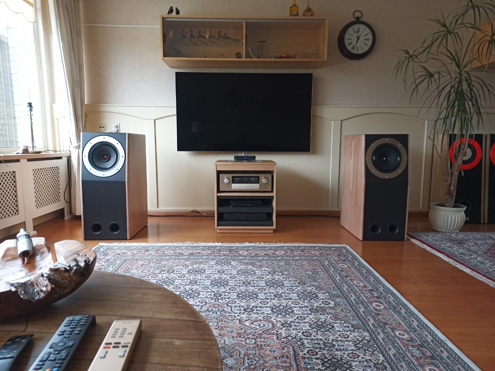

No filtercomponent used yet.
I don't have experiences with filtering.
But believe me, it sounds already very good as it is without.
The Super 10 Alnico is also without any filter component.

- Full Range
- Cabinet for the Super 10 Alnico in 160 liter BR
