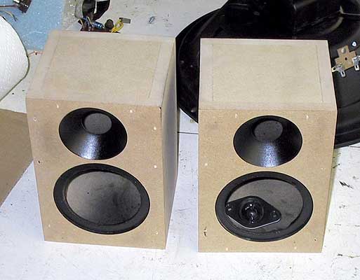

Thanks everyone for the numerous responses.
Based on what I've read, I will decide on either 1/2" or 5/8" baltic birch plywood with minimum bracing.
But I have another idea for a more advanced project: a cabinet with non-parallel sides on the inside but is absolutely rectangular on the outside. This means non-uniform-thickness walls (i.e. a side panel 3/4" thick in the front that tapers to 1/2" in the back). Does this make much of a difference (as far as reducing standing waves)?
coolkhoa said:But I have another idea for a more advanced project: a cabinet with non-parallel sides on the inside but is absolutely rectangular on the outside. This means non-uniform-thickness walls (i.e. a side panel 3/4" thick in the front that tapers to 1/2" in the back). Does this make much of a difference (as far as reducing standing waves)?
