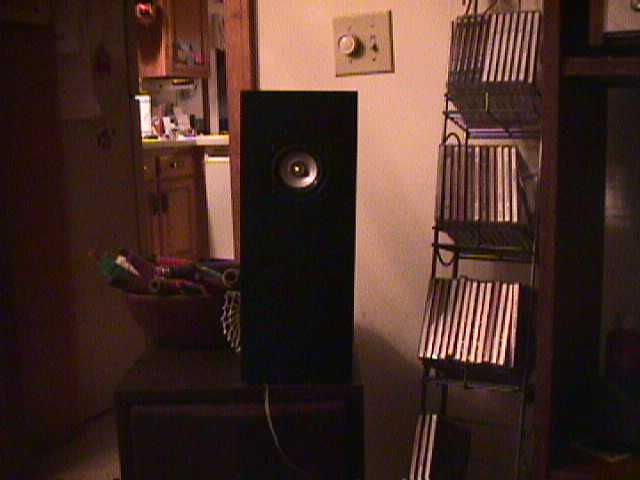

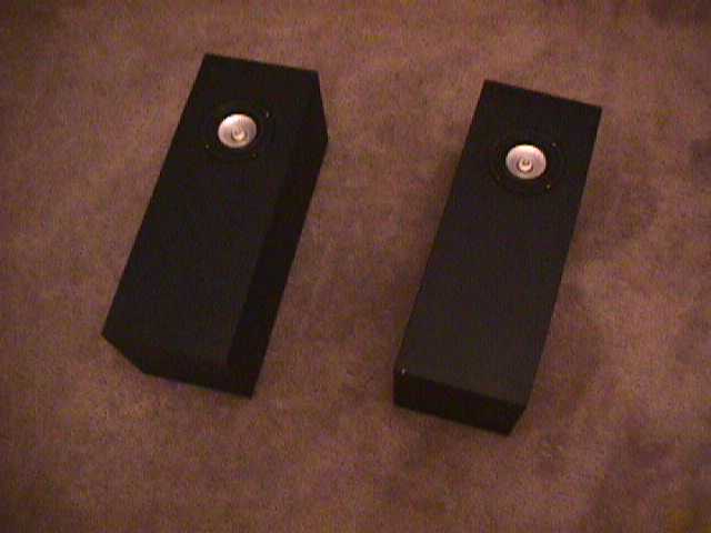

hey, i just finished building a set of speakers based off of that link. i built the taller ones and they are farely close to your .707 (i think its around .72). i just started auditioning them about 20 min ago and very impressed so far. i understand there will be little to no bass from these, but mated with a small sub, they sound very nice (might run off of my creative/cambridge soundworks 4.1 pc system for the time being. gotta find out the stock speaker's ohms). here's a pic.

SQ Kid said:hey, i just finished building a set of speakers based off of that link. i built the taller ones and they are farely close to your .707 (i think its around .72). i just started auditioning them about 20 min ago and very impressed so far. i understand there will be little to no bass from these, but mated with a small sub, they sound very nice (might run off of my creative/cambridge soundworks 4.1 pc system for the time being. gotta find out the stock speaker's ohms). here's a pic.
Nice looking boxes. I thought I might mention something something I added to the page last week. (after not touching the page for almost a year) I had forgotten to include the unique stuffing method for the tall box.
The box needs very heavy stuffing near the bottom, and moderate to heavy stuffing about halfway down, with average stuffing in the rest of the upper portion. What this does is smooth out the 1100hz wavelength node cuased by the vertical length of the enclosure. You might have done this already, but I never made it clear on the web page.
John
