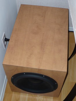

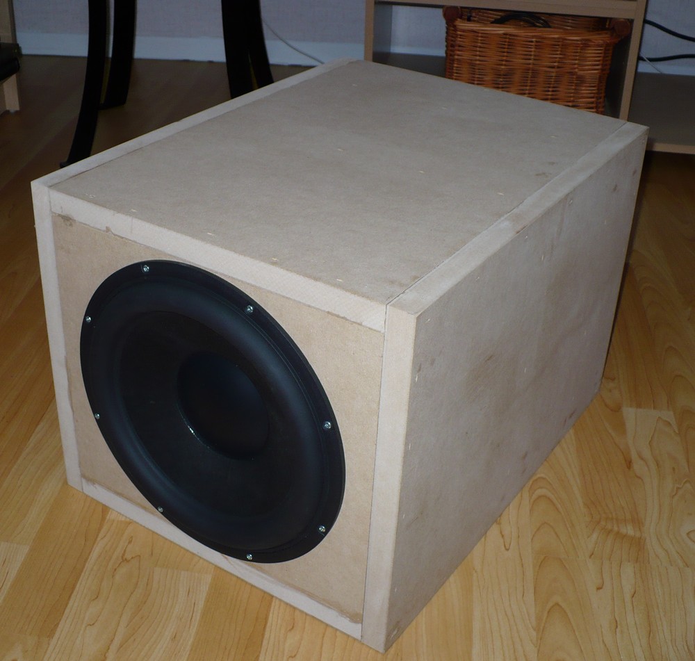

How does this sub sound? I have a pair of these speakers, with the same amp (x 2). I was looking to build this unit(s) as well (two of them)... Would you make any changes to improve?
Mike
Mike
sub
Very good idea , dont look for any improvement....This sub is perfect.

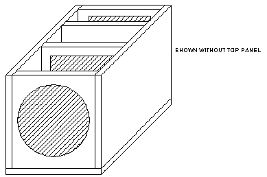

I was playing around in hornresp on this driver a couple days ago trying to find a combo that gets me 20Hz without being too long. The path is a bit long with this driver at around 5 meters, but I'll post it here just for fun.
Although the voltage is limited to 28V due to displacement @ 25Hz (not sure if the T/S params are for series or parallel coils), the efficiency of the cab will get you 20Hz at 125dB when placed in a corner. Not too shabby, 'cept for the long path which makes for a HUGE box.

What do you think about this cabinet for my 12" Peerless ?
What made you change your mind?!...dont look for any improvement....This sub is perfect.![]()
That subwoofer PEERLESS XLS12 is no good on a TL.
I'm not an expert in those type of applications.
Posting link for PEERLESS XLS-P830500 (v.2010) SUBWOOFER 12" here
Note. I guess, and take it at face value, that older versions were different and not the same or worse when simulating with a TL. This (2010) version shows a yellow tag (not of a problem for bjorno mathematical simulations) and older versions show a red tag when simulating.
