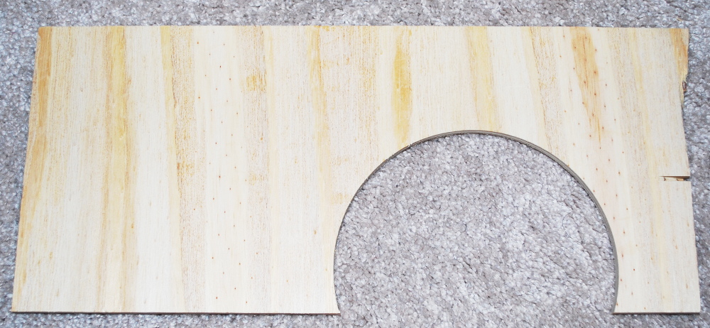

For myself, I've never managed to get a proper circular cut out with a jigsaw. But once I got my hands on a router, and made a very simple plywood circle-cutting jig for it, speaker cut-outs became straightforward. I just set the router depth to make repeated shallow cuts, and keep making passes until the hole is all the way through.
The actual circle-cutting jig is simplicity itself: a strip of plywood with four screw-holes to mount to the face of the router, pivoting on a nail pushed through one more hole spaced at the right distance.

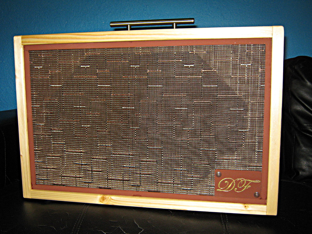

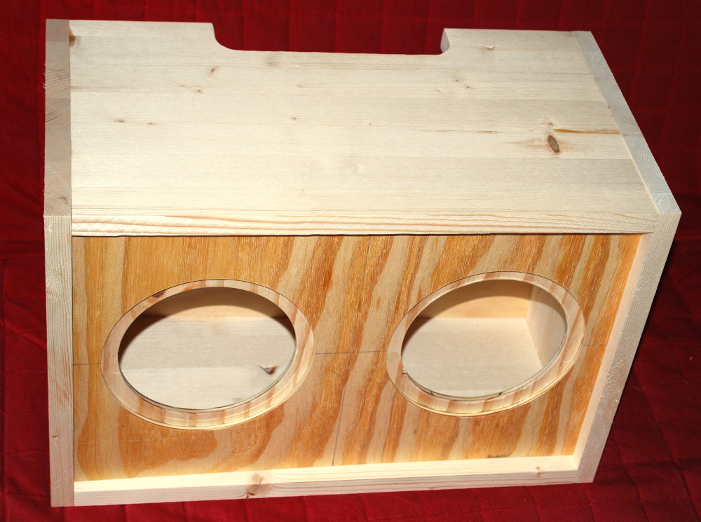

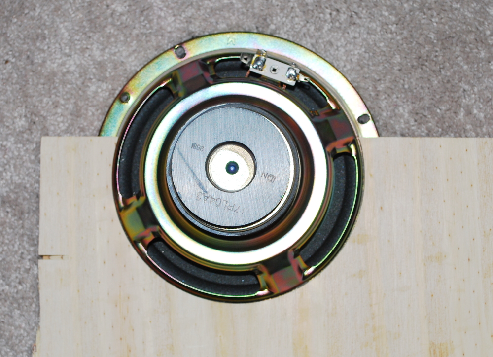

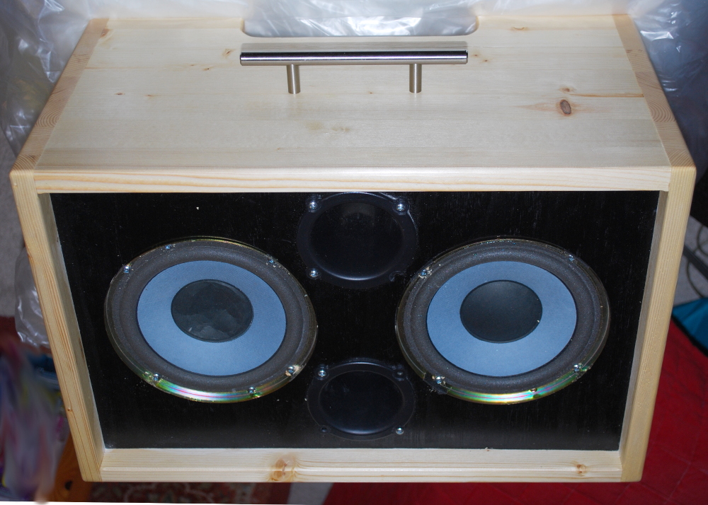

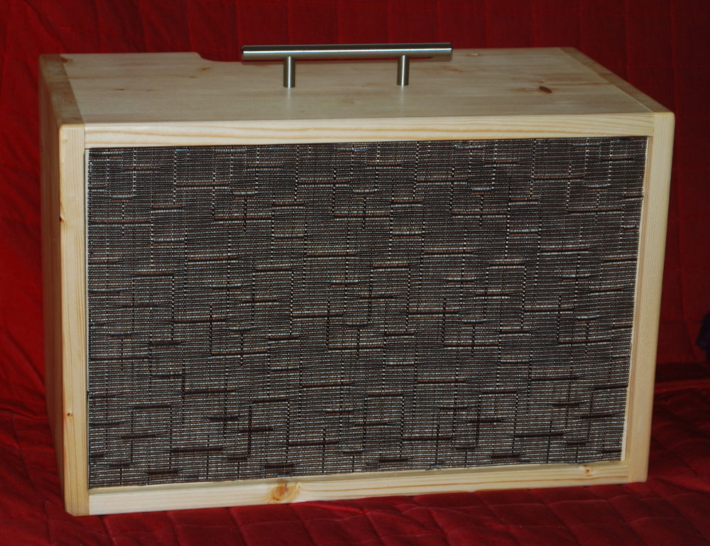

These pics are from an amp I built in late 2017 as a gift for a friend. The pics go from first test cutout in a scrap of plywood to finished combo cab.
-Gnobuddy
