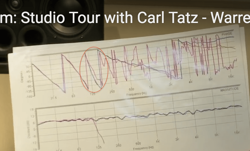

And you want the phase of the subs and mains to match closely through the crossover region, the circled area:

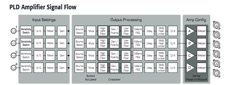

Getting the crossover and EQ alignment right is the biggest challenge, but you should be able to do as well with the QSC PLD4.2's filters, if you have a pair of the amps.
If you don't already have a pair, get a second- it will be probably will be less expensive than good components for a pair of 3-way passive crossovers.
I'd suggest tuning outdoors, save the presets, duplicate them and use it as a starting point for fine tuning in the room.
Personally, I think a +6dB low end boost as Carl shows is a bit much for mixing, but may be good for client playback.
Good to have a "flat" preset, and a few "house curves" to fit the level and genre.
