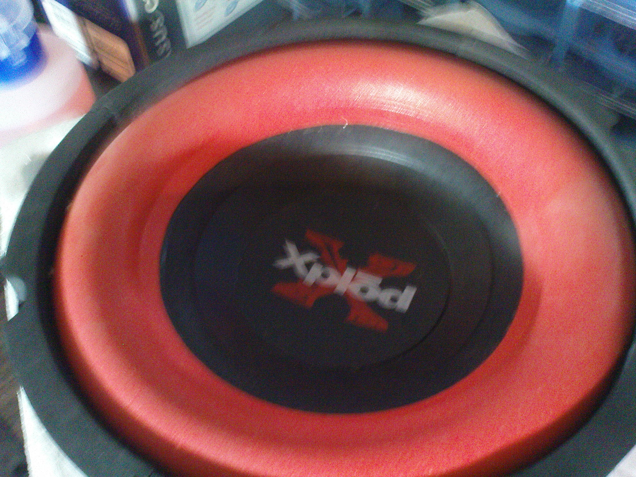

well I have two Xplod 8 inch 220w 4ohm subs, my question is what is the best box for each one so the bass out good enough regardless of the size I just want to make sure to make best box for these
here is sub picture:

I found specs on the 5 sided version just for an idea
The 5 sided ones need a sealed box of 0.36 cubic feet or 10.9 cubic liters. Search for any numbers on the sub and that might get something. If the sticker fell off or the markings are gone, I'd go with a sealed box of .75 cubic feet or 22 liters of internal air space with both woofers in the box.
Maybe if you posted another picture but of the back side, someone might recognize what year or series of subwoofers they could match to.
One other question, are these for a car or home use? Be careful around here when you say size does not matter! Someone will cook you up some plans for a 2 meter tall BIB version.
well according to your needs for specification about these subs, I just know it the old version of the new XSL82P5. but the different is in the wattage the new one has more powerful core than the one I have.
anyway I don't have any catalog for them I have them from 2 years and I thought I was lost them but I found by accident at my old tools garage so I hope to build something fit them.
for the use of them it was for my car, anyway now I want to use them at home with my amp.

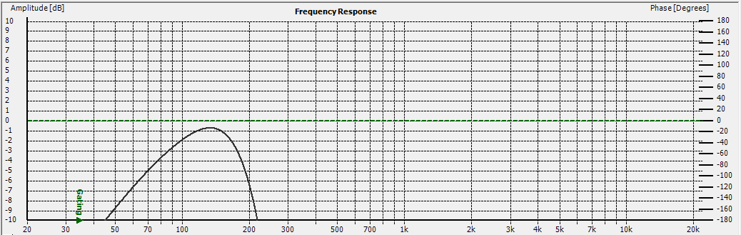

your driver is best for car. when i simulate the sealed box(0.36). -3db is very high. when i sim the vented box. i think it's better than sealed box. i get the result about 19 L but must be add the cone displacement about 2 L(i think)=21L (Inside Dimensions) when u build. the port diameter is about 2" length is about 19.6 cm. about the box u can design by urself with my link,it's very easy for the beginning. u can select the dimension by urself :)

thank you very much for the link now I do some simulation and I get 21.27L for cabinet when I used Rectangular type for enclosure the dimensions I used is:
Height: 30cm
Width: 31cm
Depth: 33cm
all for outside enclosure.
I hope this work for sub I'll try to post pictures when I get it done as I hope thx again for your help now I'm sure the sound will be good as I hope and better to know from pro like you how to do that design.

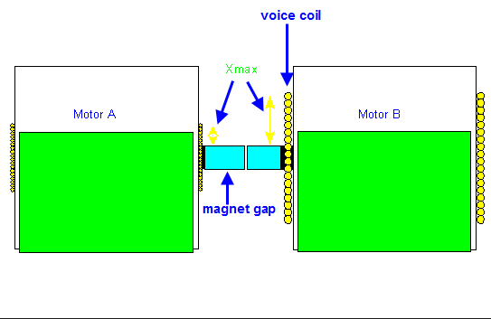

Seems hard to believe that a woofer with such a huge surround and high power handling would have so little Xmax. If true though, then using it in the home will require a sub system to fill in below it, but if you want to try it anyway, then stick it the recommended sealed cab and place it in a corner since there's not enough Xmax to bother with venting a larger cab. Even a very low tuned ~131 L net TH barely makes 105 dB/30 Hz/m in a typical corner.
GM
I didn't under stand what is Xmax you mention is, but seem you tell me this one is hard to do with such enclosure right?
or do you mean the sound bass will be low?
GM said ..x-max is the distance of the voice coil travel around the world! LOL :D Hosam x-max is the distance of the voice coil travel between the magnet gap. when u increase the power feed to the voice coil sometime the voice coil travel out of the gap. 2.7 mm is the low x-max. difficult to design when u want to the high spl level in ur room because the voice coil can travel out of the gap.

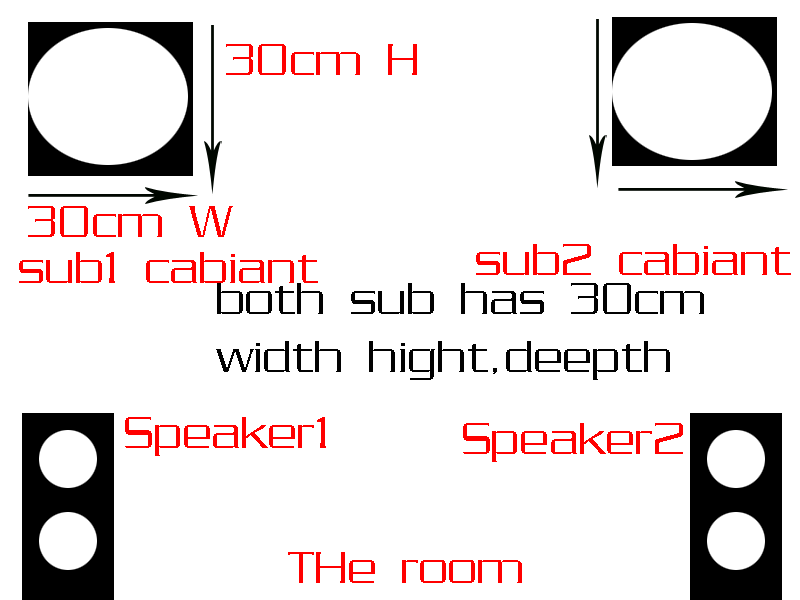

after consider everything before look at this picture and tell me if this could be better or not:
attachment.php
do I need to fix them both in one enclosure or this is ok for this design ?
because I check this dimensions and it give me about 21.04L for space inside do I need more or this is just fine for cabinets and general idea?

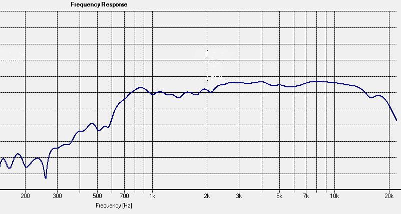

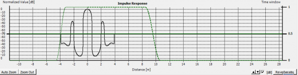

Hosam if u want to measure your sub. u must have the tool. software measurement u can download from here. u can start this threads every members on here will help a lot. it's not difficult to learn.
holmimpulse-measurements-practice
holmimpulse-measuring-frequency-impulse-respond
and u can follow to see this will help all the beginners.

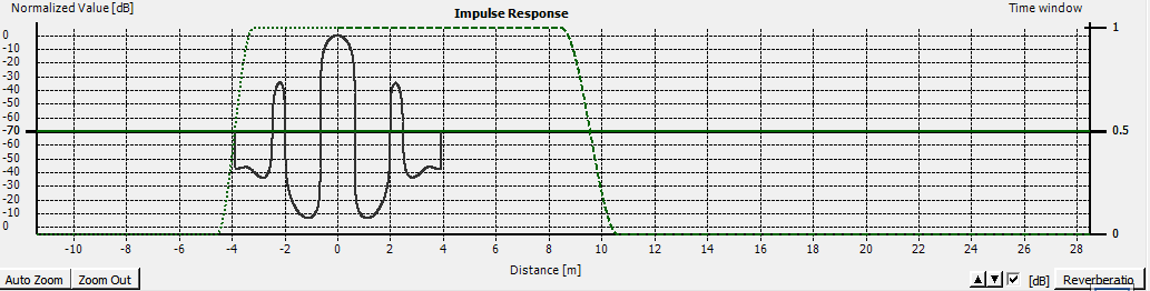

Ilkka tested subwoofer
last year i tested by this software(pic). i feel like this software. it's simple for everyone to use and learn. the other software that i like to test, is rew from hometheatershack but difficult more than holmimpulse.

I suppose for me best choice is to try simple software then get used to it after that when I feel things get simple enough I'll try more measurement software for future test.
this idea is very exciting specially when you know you make things correctly as example these subs boxes and then maybe if I buy some more powerful sub it will be easy to design good cabinet after make measurement.
