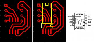

Stream said:My first pcb design...
DIP to SOIC. NE5532 to AD8066.
Wait for you comments.
Nice one, I havent got that far with 'Express' yet. 😉
Have you heard of the Browdog adapter? Its basically what you have drawn there, I think they are way overpriced though if you buy them with the opamp already mounted.

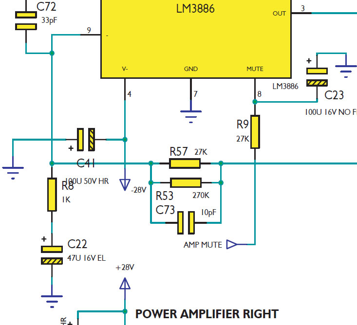

The SE's extra NFB // resistor and cap make no sense to me, shouldn't the 270k and 10pf be in series? As is, it just lowers gain? They might as well have just changed the 27k to a 24k5..
Or have they another purpose?
Just an observation..I'm still learning.
Hi audio1st,
-Chris
27K and 270Kare standard 5% values. 24.5K isn't. It's a cost issue.They might as well have just changed the 27k to a 24k5..

Hi Stream,
Sorry, I didn't realize you wanted me to comment.
Your PCB looks fine. I didn't check it for correctness, but then I assume you did - carefully. This is an adapter from sm to through hole? My guess is that you'll use pins from 0.1" strips to connect the daughter board you made to the original PCB. You might want to make a place for supply decoupling capacitors on your small PCB, just to help prevent oscillation. A pair of ceramic types should be fine. These are delicate to solder as they can crack easily due to temperature differential. Otherwise, use leaded decoupling capacitors.

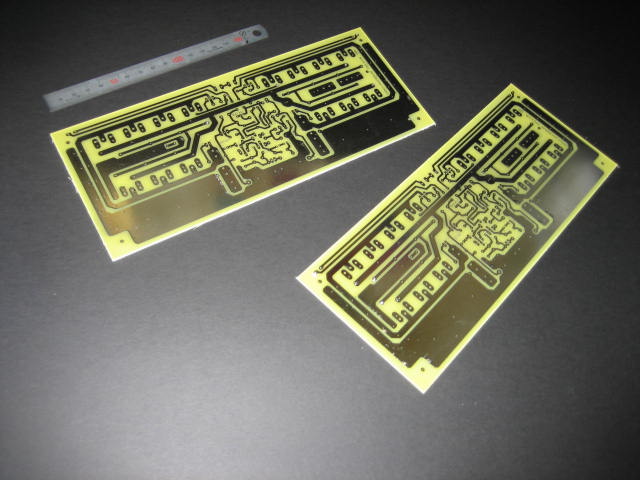

Smile PCB's Made for anyone
Sorry to cross post but:
Hi everyone
I have just made these 2 dhrturbopcb1 pcb's for joka22.
I can make pcb's from pdf files etc etc.
The pcb image is photo plotted at high resolution then fine spray etched onto industry standard fr4 pcb board. Then finally they are roller-tinned to make the board easy to solder too then fully drilled ready to be built up by you.
Very good prices for One offs and low volume amounts and I post worldwide.
No silkscreen No photoresist just high class industry standard pcb boards made from your design finished in roller-tin and pre-drilled
Thanks Ajay

Hi Ajay,
Those PCB's look really beautiful mate, I'm wondering what those examples in the the pictures are for?
Can you produce a PCB from a PDF file?
I know Stream is interested in designing a PCB adapter from DIP to SOIC so he might be interested, have you got a website?
