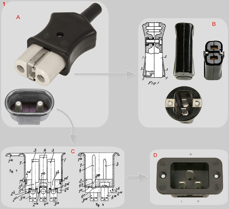

Check out plug 1B in the image below from: https://www.plugsocketmuseum.nl/ApplConn_precursors-IEC60320.html
The shown black connector and matching inlet date back to the 1950s and have been made by the German company Kautt & Bux.
