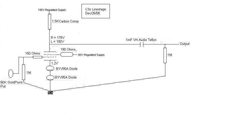

C3m pentode linestage
Hi
I have built and using a C3o linestage, but operating C3o in a pentode mode. C3o is a 6.3V version of C3m.
Somebody else posted a very useful warning, do not remove the tubes after you have turned off, I usually wait for 30 minutes. I lost a few C3m's this way, before I went with C3o. When I had the C3m, I was rectifying it, with C3o, I have a/c filaments.
The power supply uses Hashimoto PT-100, with a Hashimoto Choke for choke input supply. Then I have 4 regulators - one for each plate and one for each screen. These are current sourced -- shunt reg's. I am sorry I cannot post the schematic here, 'cause it is a borrowed schematic and not my own. You can also use Allen Wright's SuperReg - two of them, one for both Plates and one for both Screens.
Please shoot me an email to sridhar.ganti@gmail.com if you have any questions. This is the best linestage I have heard/built.
I also use VH Audio 1mF teflons for the o/p caps and Goldpoint 50K volume control and Goldpoint selector switch.
Chung had posted a copy of this at vt4c.com forum also.
ganti
I will try to attach the schematic in this post
ganti
