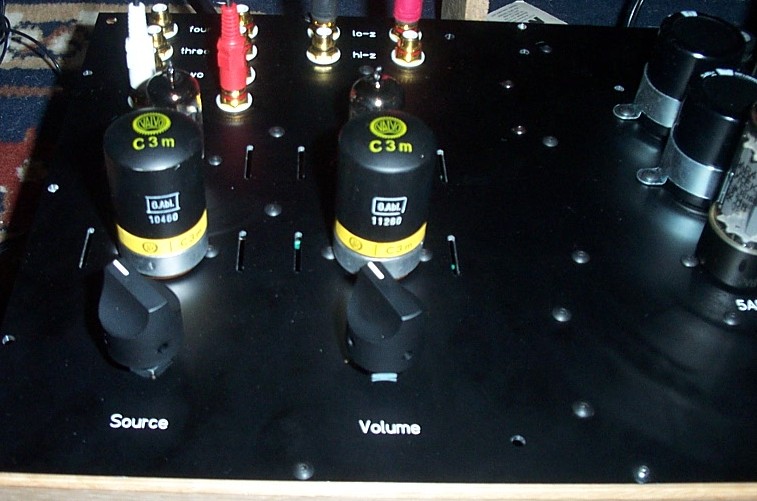

I made an RC coupled triode-connected (whew!) C3m linestage - it sounds very neutral.

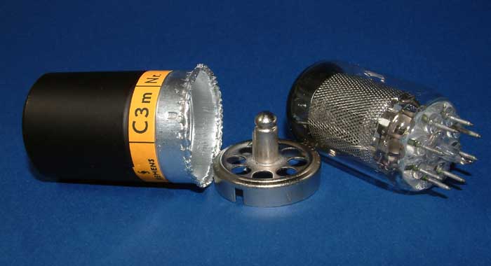

So far I've seen (dismantling Siemens and TFK) two varieties of internal constructions; Siemens with mesh and TFK solid (think it's the second screen).... Also read somewhere that Siemens is the only manufacturer of C3m, so both could be Siemens variations over time... Dunno what's true.
Simon
The mesh is a screen.
http://www.jogis-roehrenbude.de/Roehren-Geschichtliches/Behoerden/Post/C3m/DSCF0006.jpg
Andreas
Andreas
I have Philips, Haltron, Valvo, Siemens and Lorenz C3ms... I would say that the majority of them look to be Siemens made... vintage varied with the Haltron looking the oldest to me. Didn't know that the TFK was had a solid-mesh - interesting. Some of the older EF40s used a solid-mesh and it's also used with some EF86 tubes.
I used b+ 350V
15k plate
430 ohm cathode with bypass
it's DC coupled to a 5687 white cathode follower...
off the top of my head - bias was ~6V
I used DC on the filaments... it was easier for me run a 7820 regulator with transformer I had on hand then buy a 20V unit.
I used b+ 350V
15k plate

The C3m was made by Philips (Valvo), TFK, Siemens and Lorenz; Haltron is only a rebrander
kstagger said:... TFK was had a solid-mesh - interesting. Some of the older EF40s used a solid-mesh and it's also used with some EF86 tubes....
This mesh in the C3m, EF40, EF86, EF806 is the sreen, the anod is solid (analoque 6C6).
Regards Andreas

thanks - I made that preamp to be used for a long long time so I could concentrate on other parts of my stereo. So far I've been very pleased with the sound - but I may be going back to a triode connected EF86 for my next linestage project.

I just used a diode bridge into a capacitor, followed by a 7820 3-pin regulator and some more capacitance. Grounded filament on one side. I probably could have gotten away with AC... but didn't have a suitable transformer on hand.
