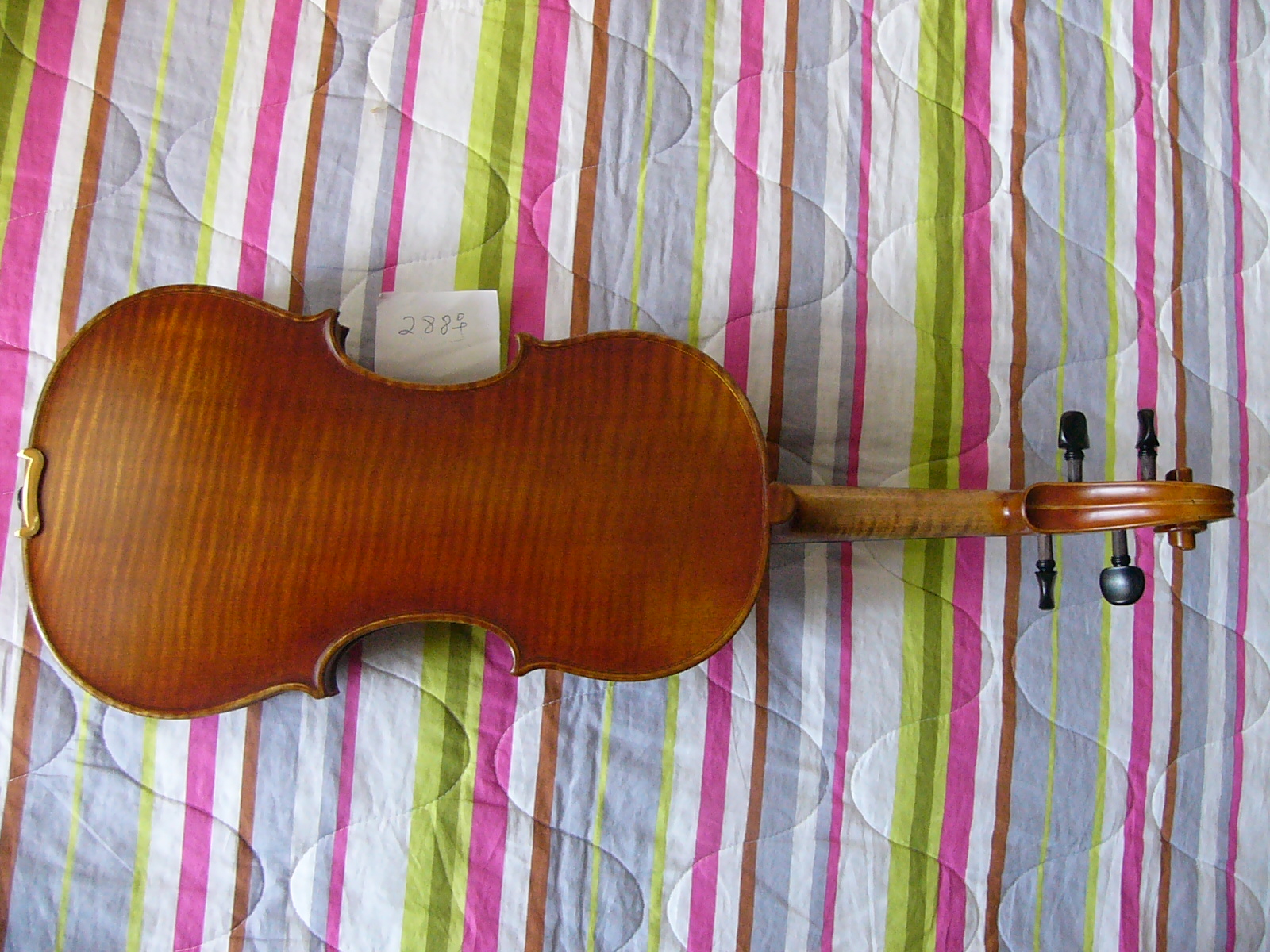

I see there is a lot of dammar usage for cone treatment. Has anybody ever considered using amber varnish for this? I mention this because amber is the strongest natural resin and fairly tough mechanically, so could possibly be a useful alternative, especially when it is desired to add less mass.
Also some musical instrument makers believe in 'ash' varnishes where wood ash is added. Their belief is that the heavier metallic elements in wood ash assist the varnish in its stiffness and damping characteristics. However, not all wood ash is the same here!
The species of tree, whether the wood, bark or leaves are burned, etc. all have strong effects on the exact composition of heavier elements in the ash such as aluminum, calcium, iron, potassium, magnesium, manganese, sodium, phosphorus, tin and silicon. Even the climate, soil and time of year the tree is harvested and what temperature the wood is burned at play a (less important) part.
Interesting stuff. I would be interested in others' thoughts on this.
