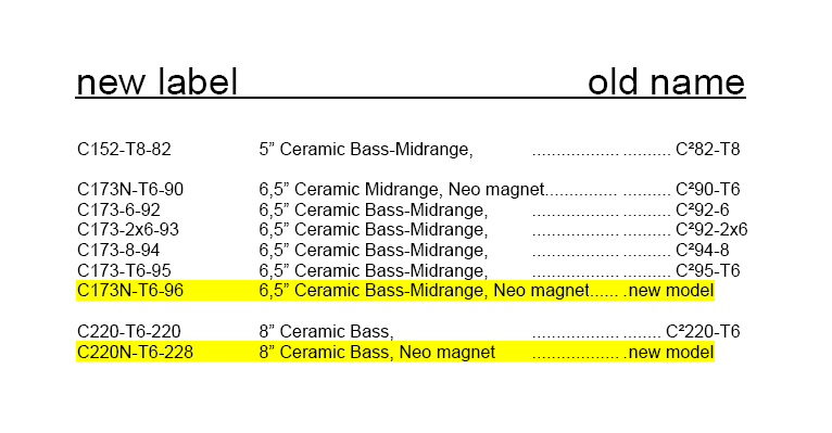

(pic from: http://www.clofis.nl/nl/thiel/Thiel Accuton new and old model numbers 9-2006.pdf )

Look back to a 3-Way Xover by Tinitus. (It all depends on the driver chosen) Add an inductor to the woofer, and place the mid driver in a small closed box. That's a good starting point.I believe that the driver commented on in that thread is a midbass, which is different to the c173 mid driver. The combination of the c95-t6 midbass and the er-4 AMT tweeter in a 2-way could be very nice as well I presume..
