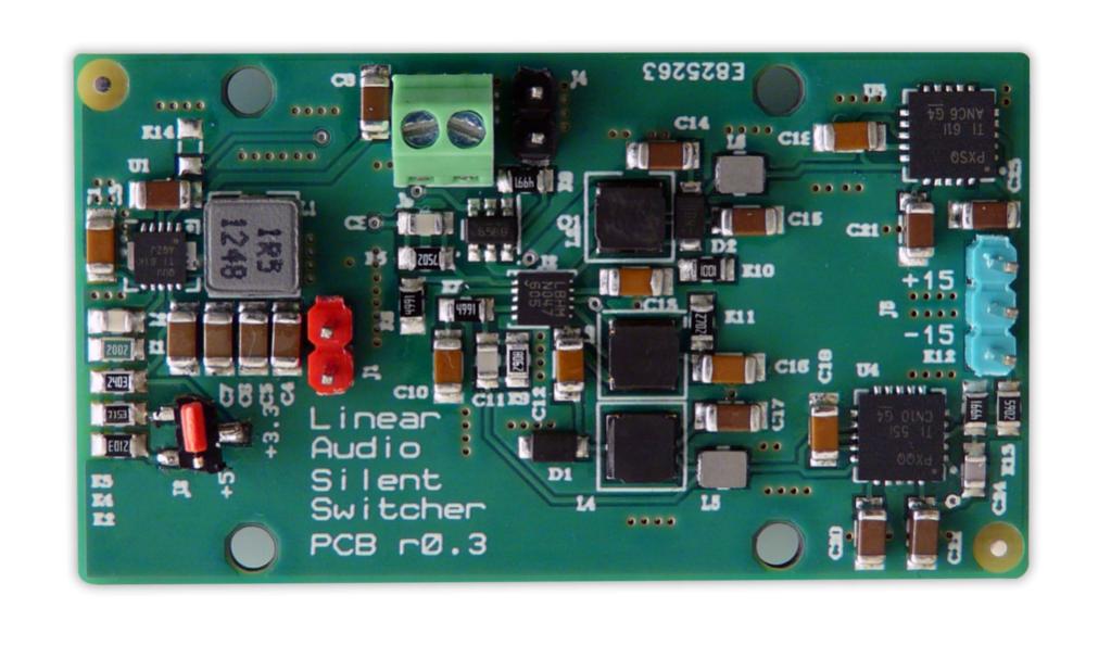

In my SilentSwitcher, which switches at 1.1MHz, I use parallel 20uF COG ceramics. You can see them on the PCB.
Jan
Are does the 1206/3216 size ?In my SilentSwitcher, which switches at 1.1MHz, I use parallel 20uF COG ceramics. You can see them on the PCB.
Jan
You mean X5R or X7R right? A 20uF C0G would be massive.
Hmmm, don't remember. Will check.
Edit Yes, XR5, Mouse 81-GRM31CR61E226KE5L
