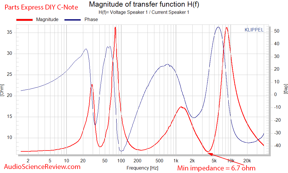

ASR has an impedance curve measurement, I assume w/o the parallel cap - the peak is not quite as high as suggested by @WhiteDragon, but it certainly returns with a rapid dip to the speakers min impedance.
https://www.audiosciencereview.com/...arts-express-diy-c-note-speaker-review.12693/
Combining the impedance above with considerations for the .22 mod - providing a complex reactive load and dropped(?) impedance - the C-Note with a Class D Aiyima amp caused a significant rise in high frequency response - exactly Mister Audio's point!
