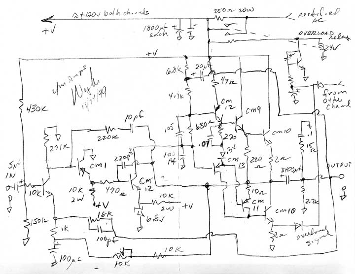

Hi Stephen,
Good you found the problem. As I recall, the diodes have a "R" designation which means that the internal diode is reversed in the package. This is was chosen so that the mounting screw would be the common. Just make sure you compare what is left to the ones you get from Digikey, so they are the same polarity.
The only schematic I have is a sketch I made some time ago, reverse engineering, and what I remember, of the 35D. The original schematics went with the new owners of C/M. If you don't have exactly the same values that is on the schematic, don't worry. It would be close enough, and not significantly alter the performance. The unmarked resistor under the relay contacts is the 1.5k 5w resistor we had been talking about.

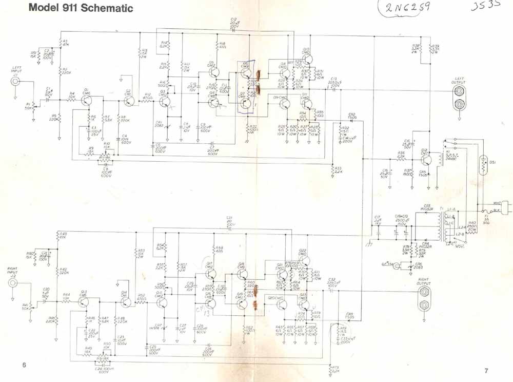

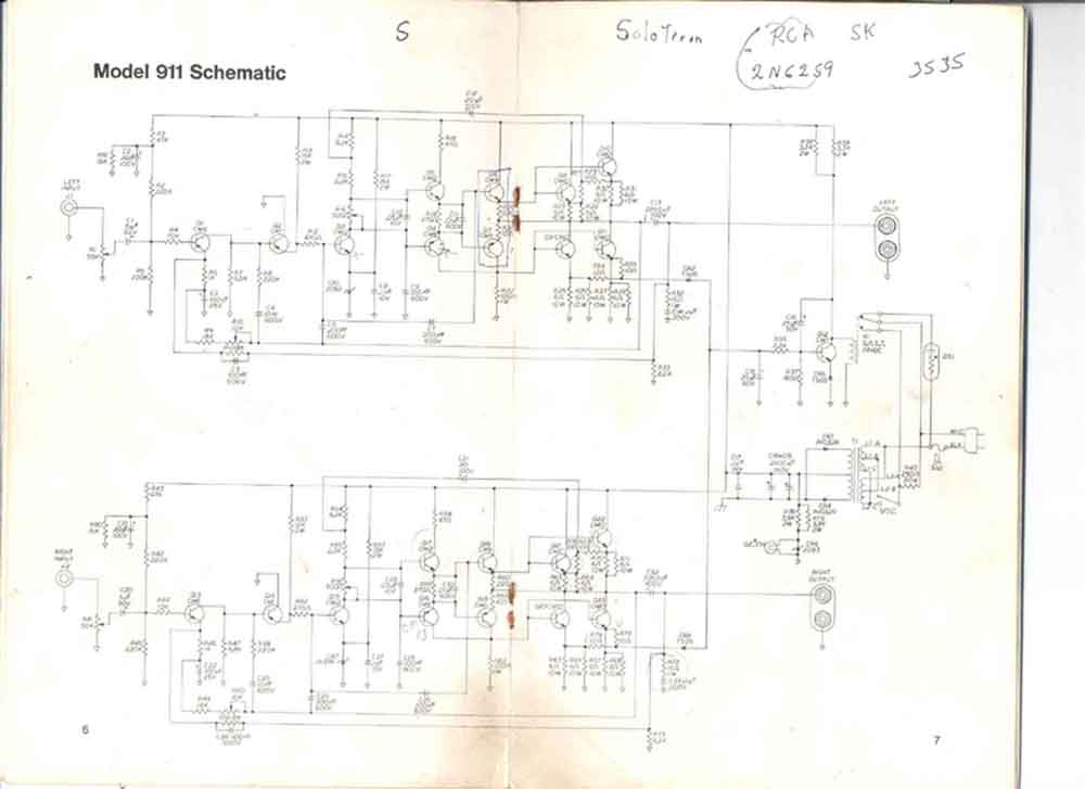

Just bought a CM Labs 911 and would like to know Wayne Chou's recomendations on bringing it up to 2009 specs,schematics,etc.Still very new to forum and need administrators OK to do anythingas far as contact.thanks Stephen
If no one has a schematic handy I can if needed scan mine.
I have a CM Labs 911, it was my first "high power" amp. I bought mine used about 1973 or so.
It has blown up a few times...
Imho there is no way to bring this amp up to modern standards.
It has several problems in that regard. First, it is a single rail supply, and so has a monster cap at the output. Second it is a design that is relatively crude by today's standards.
Otoh, it does sound relatively nice, smooth and has mostly even order harmonic distortion, lots of second.
I'd bypass the output cap with some good film, as large as will fit in the space and leave it at that. Oh maybe improve or bypass any "bypass caps" or other electrolytics on the board as well.
That's my take on it.
_-_-bear
How about the CM 920? I've done a hand-drawn schematic by tracing the PC boards, but a _real_ schematic (or service manual?) with voltages and real part designations would allow me to make my drawings and board layouts consistent with the originals.
By the way, I started an entry on C/M & CM Labs in the vintage audio wiki. If anyone can add to it, please do, since information on C/M is hard to come by.
I just worked on a "newer" CM, not sure if it is the 920 or not, looking will have to wait a few days, and then I have to remember to look.
I had someone send me photocopied blueprint schematics of it, I dumped it into LTSpice to draw it up so that it was legible, but the values and devices are not 100% correct, the topology is. So, your hand drawn version might be better. You might just draw it up in LTSpice or a similar program and put it up?

Bear,

> As for the input and feedback caps,I know nothing about circuit design,I
> attached a copy of a schematic that another audio forum member sent me,as
> I
> have yet to receive the amp to compare values can you verify that this is
> indeed the correct diagram for the amp,based on your files? If so can you
> point out the input and feedback caps,and recommend replacement types.
