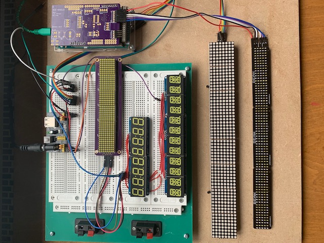

At the moment I test some display types for my DAC case.
As I am trying to learn some more programming I concentrate on the "hardware.side" of things for now.
But would need some C++ code for reading the sampling rate (and print it out),to put in Poni's fine code base. Which I am not capable of writing by myself (for now 🙂 )

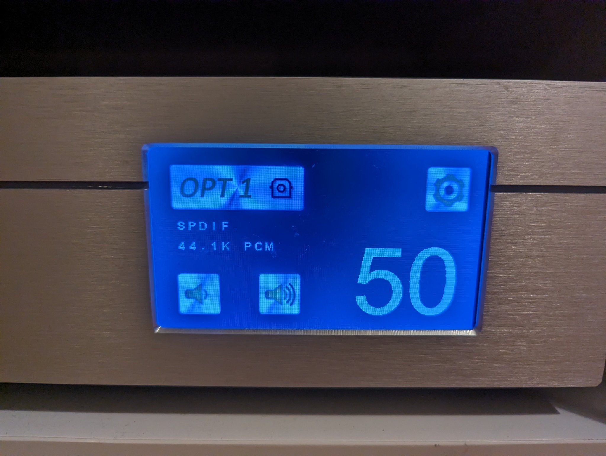

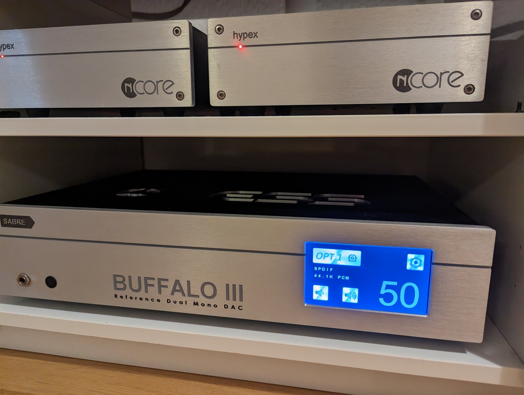

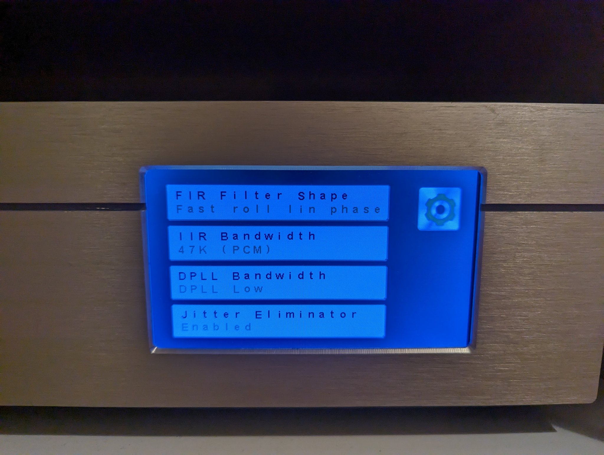

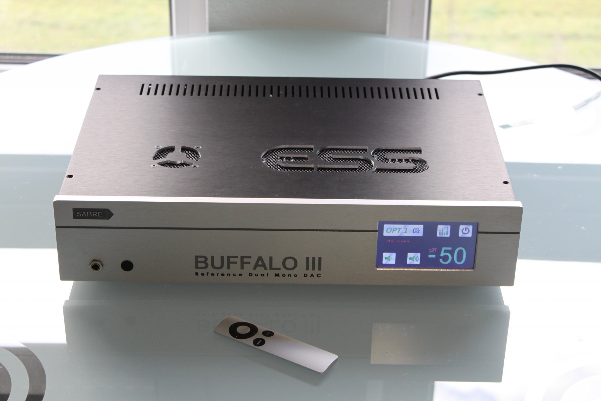

I have updated the Buffalo III ES9038Pro Software, there is new touch page to change settings, lock status and sample rate.
I have modified the sample rate calculation from dimdim.gr, i didnt test it myself but it seems to work.
Every setting displeyed in menu is actually read from register, so after writing register it is read again to confirm change.
The software is available to download on github with all libraries:
https://github.com/poninskit/TPA_Bu...06d576150e6014982185/BIII-ES9038Pro_1_0_9.zip

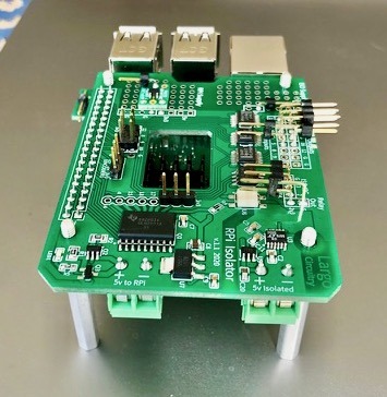

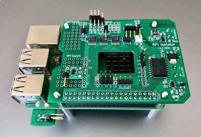

My RPi interface and isolator board is truly general purpose for low speed signals. It can power the RPi if you wish, but 'clean side' power must be separate. It accesses nearly every GPIO pin, 8 of which can supply an 8NPN Darlington IC (or the like) when higher current is required. I used USB output of the audio data from the RPi and convert it to I2S elsewhere (Amanero is one example). I believe Miero made a kernel to output I2S via GPIO on the RPi, but USB is quite flexible and simple. In addition, The RPI interface board from Twisted Pear appears to no longer be available.
Maybe this will give you some ideas... I believe some of the isolators and other composts are still in short supply.

Hi Frank,

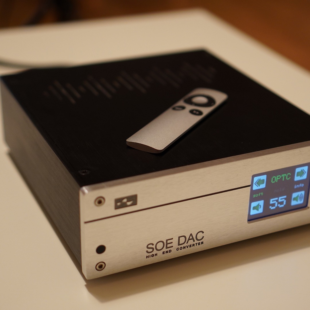

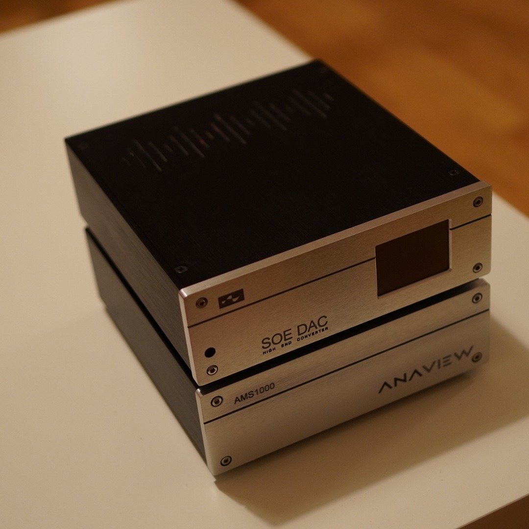

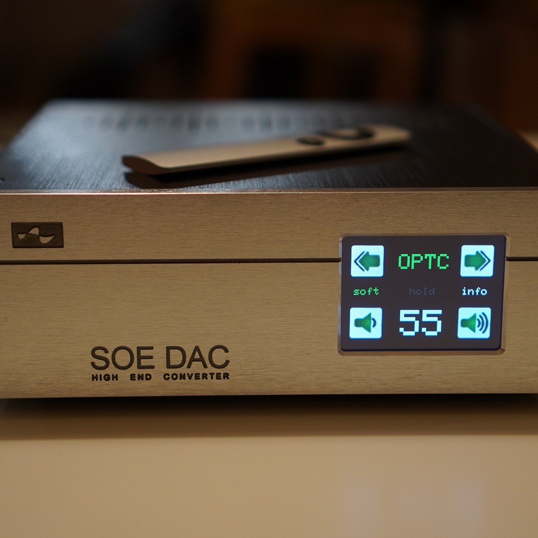

Great job! Looks really nice, but didn't you also isolate I2C, so you don't need GPIOs anymore. You can just write the registers directly on es9038pro. I just put one small isolator for SDA/SCL (I2C) between the microcontroller and the dac and then just write the registers I want.
How do you control volume, do you have digital pot? But anyway, I really like the job.

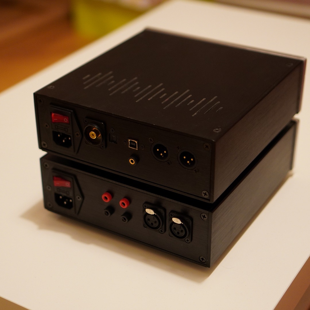

I did something similar with soekris dam dac, i first used the gpios and digital pot, but switched to serial communication, this makes life actually way easier at the end.
Even though the soekris dac + anaview power amp ware supposed to be just the second system it turned really nice at the end... it's fairly simple, and it works with Arduino UNO!
I don't know what was more satisfying, putting the software together or the casework...I'm fairly pleased with result, some ppl can't even say it's DIY.

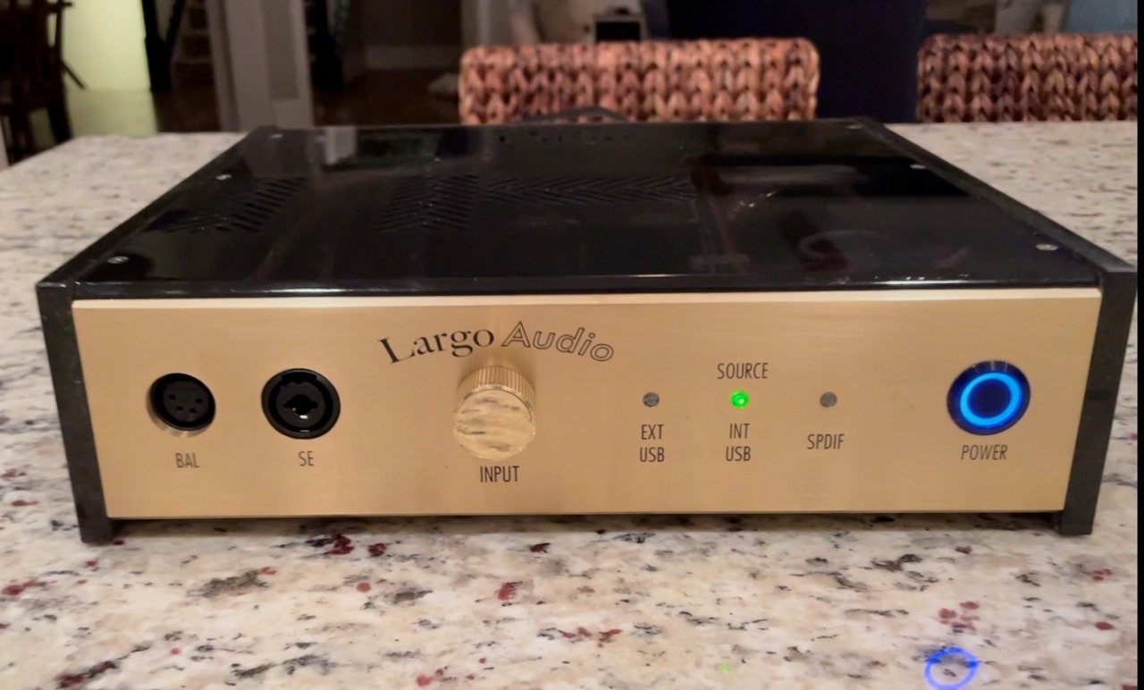

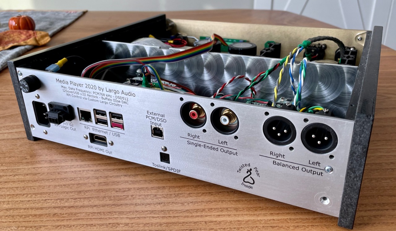

As for your question, there is quite a bit more to controling these rigs than just I2C to the DAC. I'm controling whether to run the DAC synchronously or async, controlling whether the RPi is the signal source or the DAC gets an external source (USB or SPDIF), controlling 115v power to a pair of Yamaha desk monitors, etc. For the interface I just made use of everything the RPi had available in addition to the I2C channels. That explains the little breadboards with ground and 3.3/5v nearby - easy to add something custom like the little board added on the front left on the one shown above. As I said, the original plan - yet to be completed - is full HTML control and in that case the rotary encoder will be used to incrementally adjust 2nd and 3rd harmonics instead of the default volume attenuation. Let the ear decide what it likes and then maybe go back and measure whatever that is! 😊
Here are the boxes that the 4 streamer/DACs went into. All the standoffs thread cleanly into tapped holes in 3/16" base, the fronts are 1/4" brass with custom knobs, the tops are smoked acrylic with laser-cut ventilation and a bit of fun in the pattern, and the backs are 1/8" aluminum. My son takes credit for all of the metal and laser work. The sides are black granite - I did the stone work - laminated to acrylic for assembly. LEDs are momentary switches for simple front panel control.
