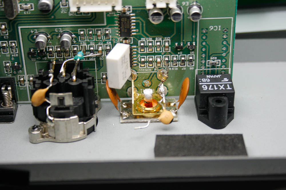

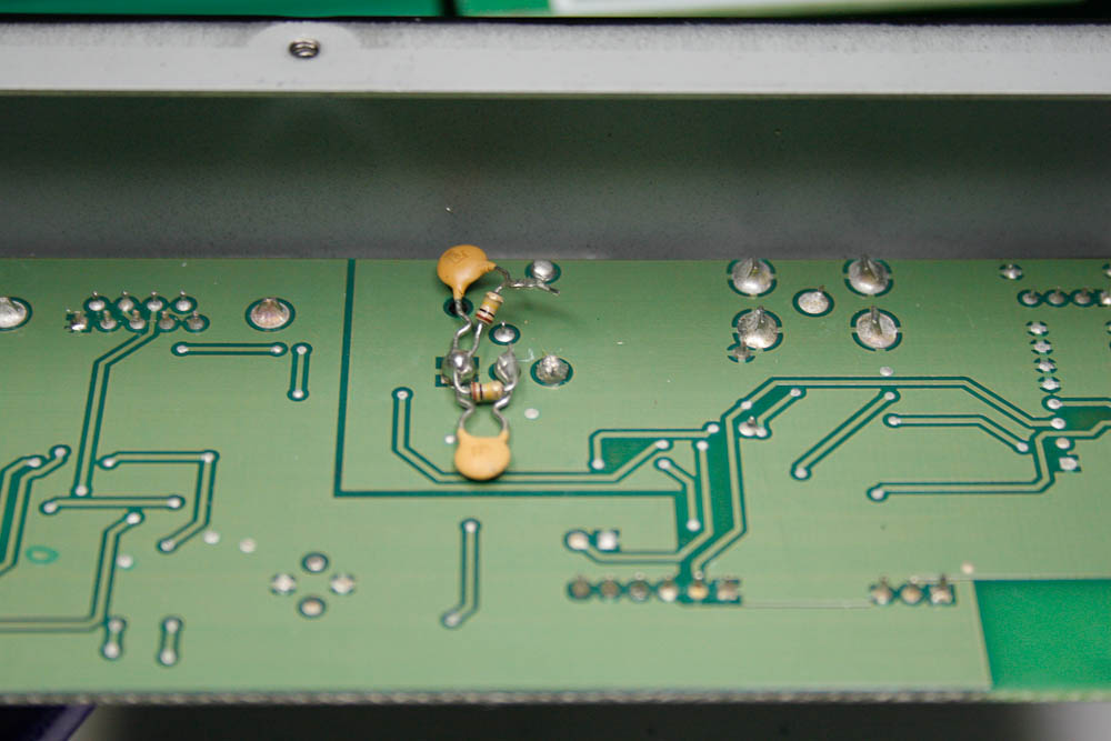

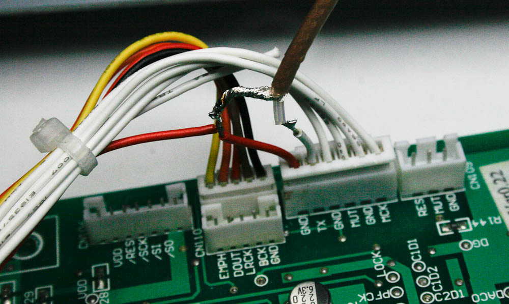

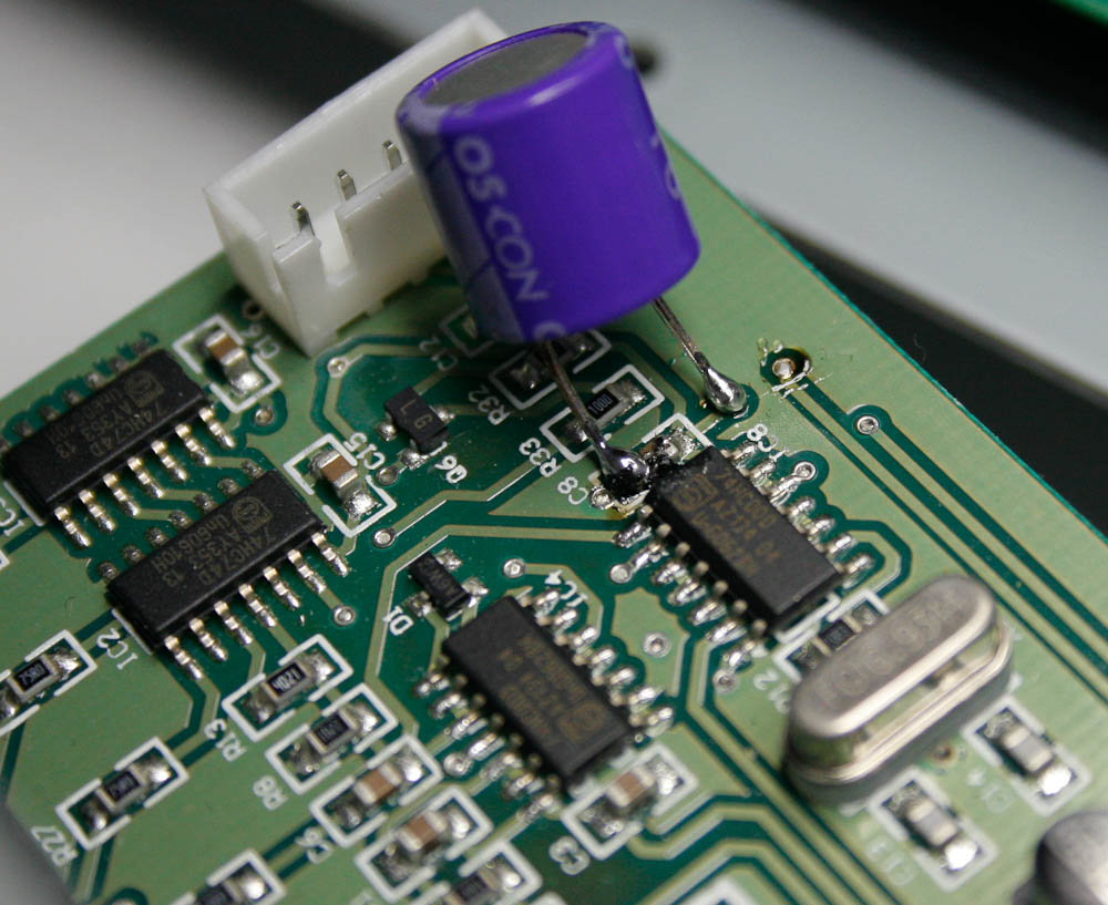

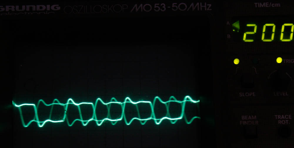

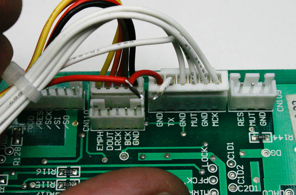

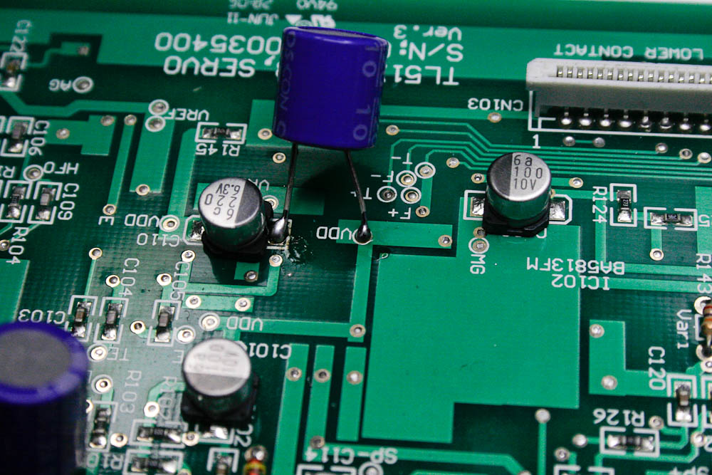

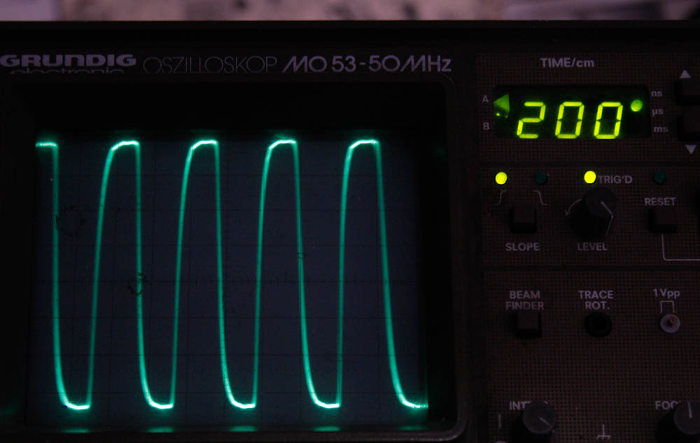

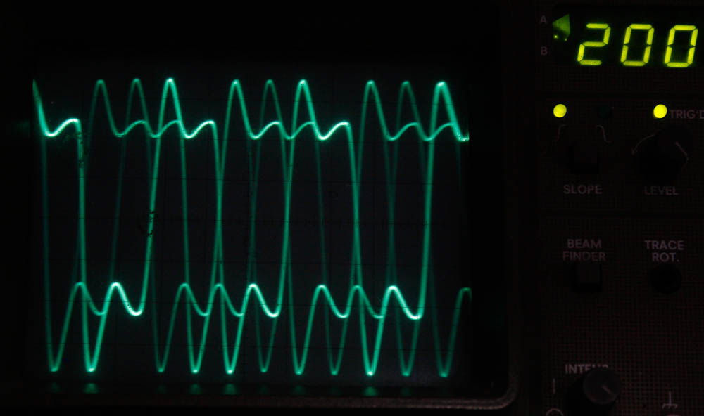

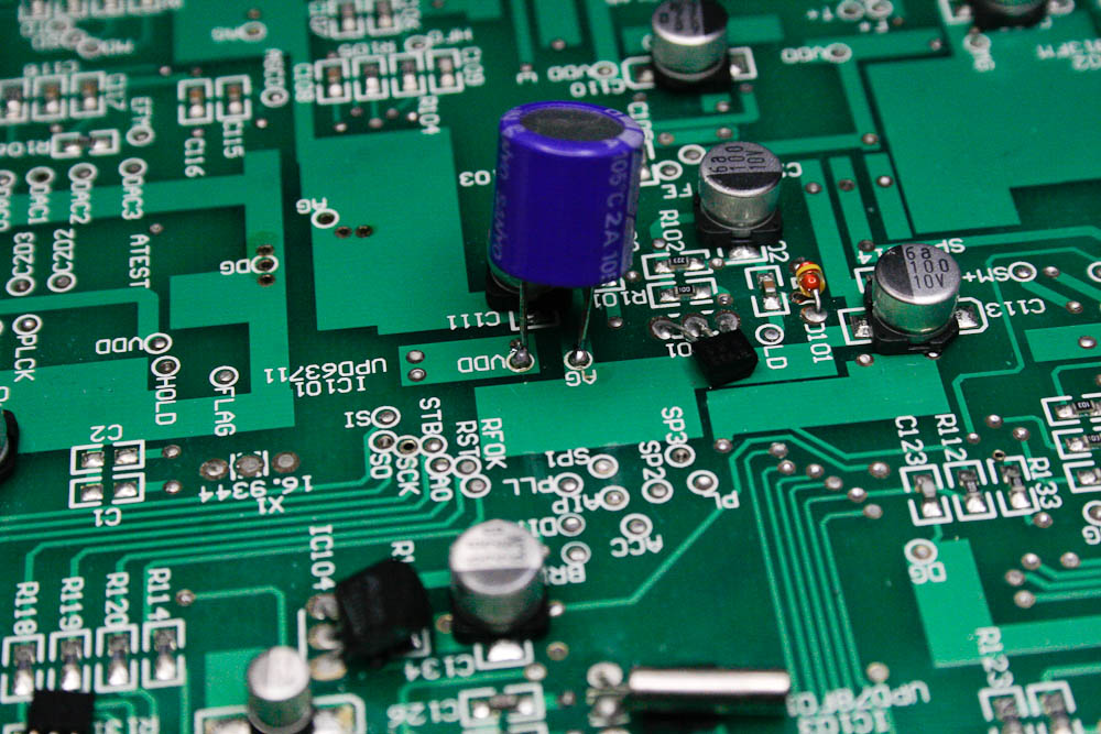

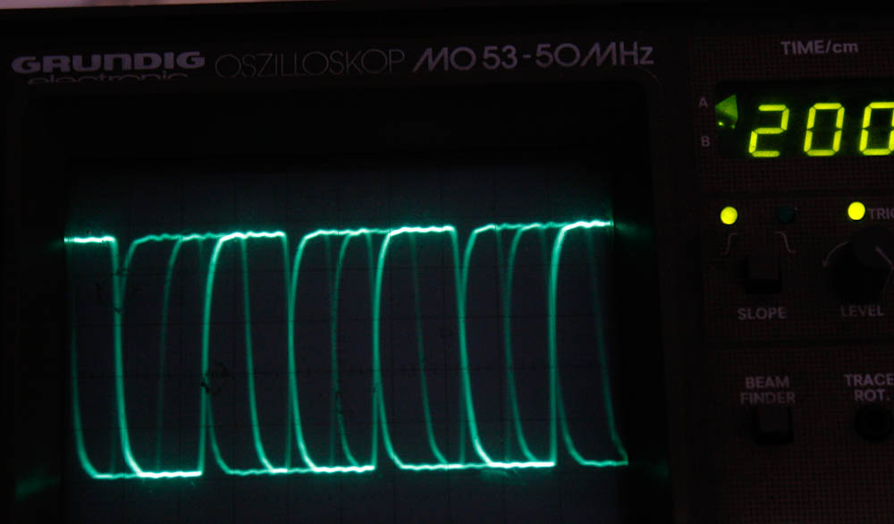

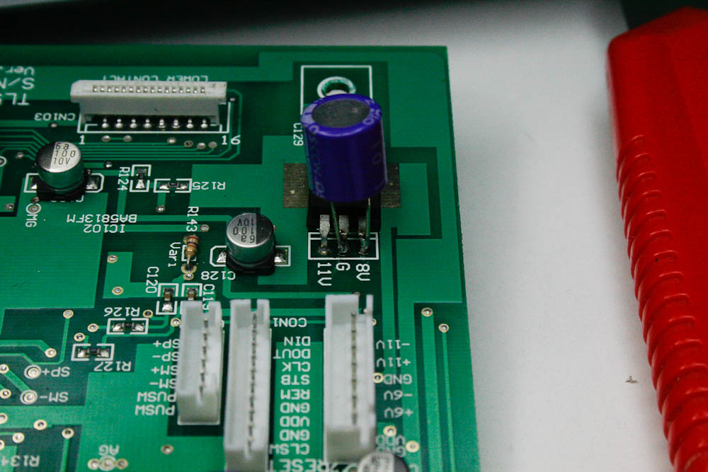

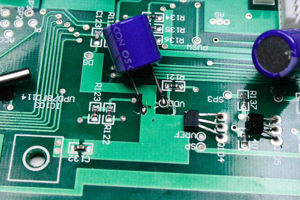

For my first steps i do cectl51x
this is some picture from the web and i will take picture on mine
1. aes / ebu before mods
2. spdif before mods
3. nec chip output
4. after mods
3. nec chip output
4. after mods
Mods suggest was some picture in here, i didnt do digital cable mods only
careful with mods no2, desolder smd caps exchange with oscon or bg maybe
