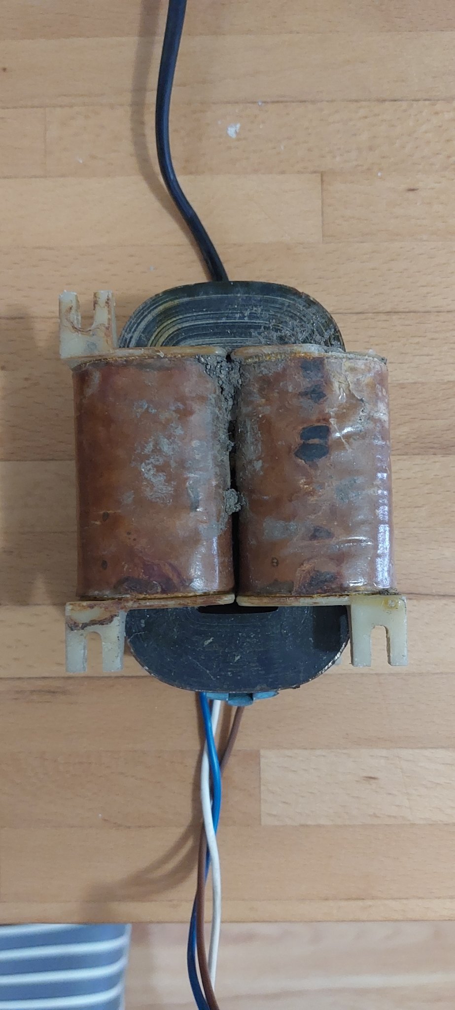

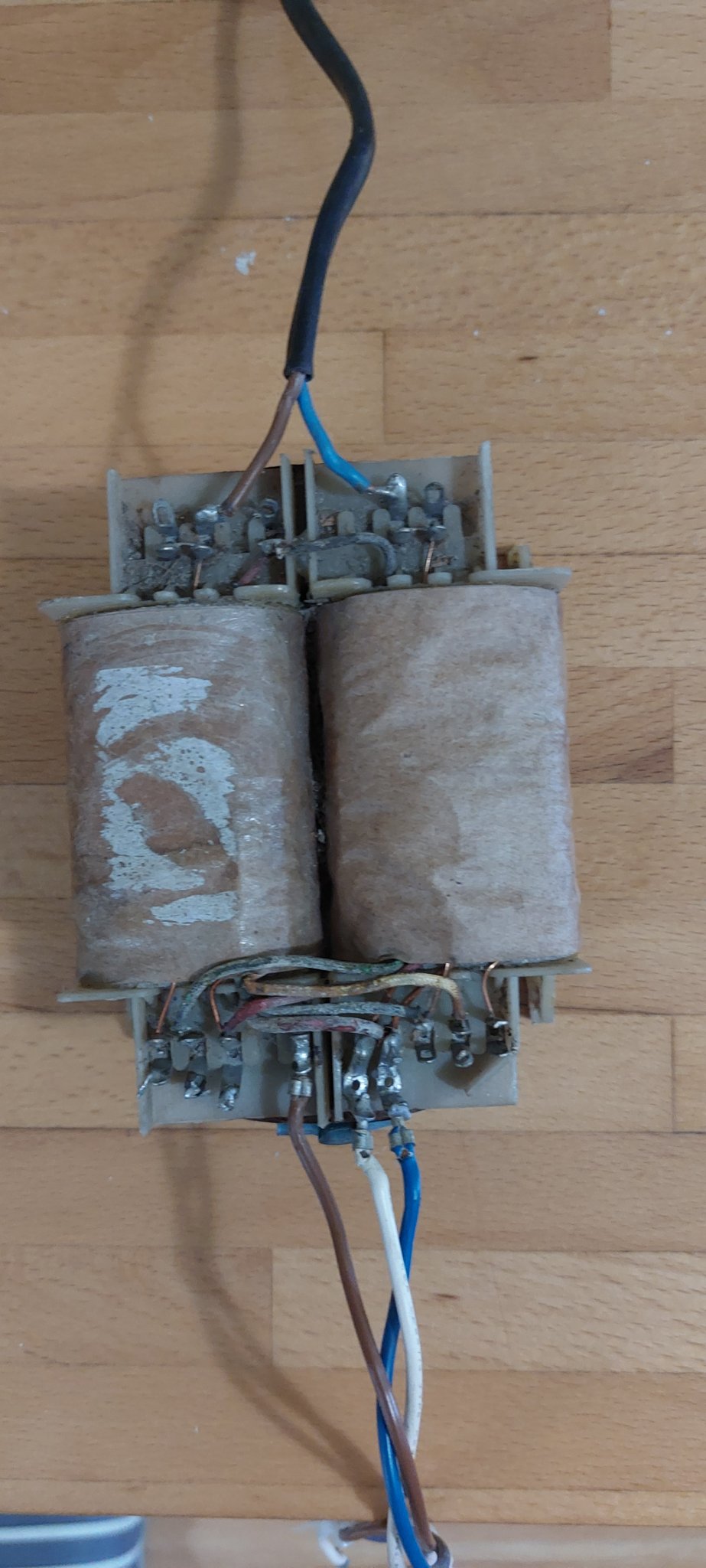

Hi, how to calculate the VA of this transformer, C core.
The section where the windings are is 3x2cm .
3x6x10cm external dimensions.
I don't know if its the same as IE core.
Want to know if it's worth keeping or trow it in the garbage. Depends on VA.

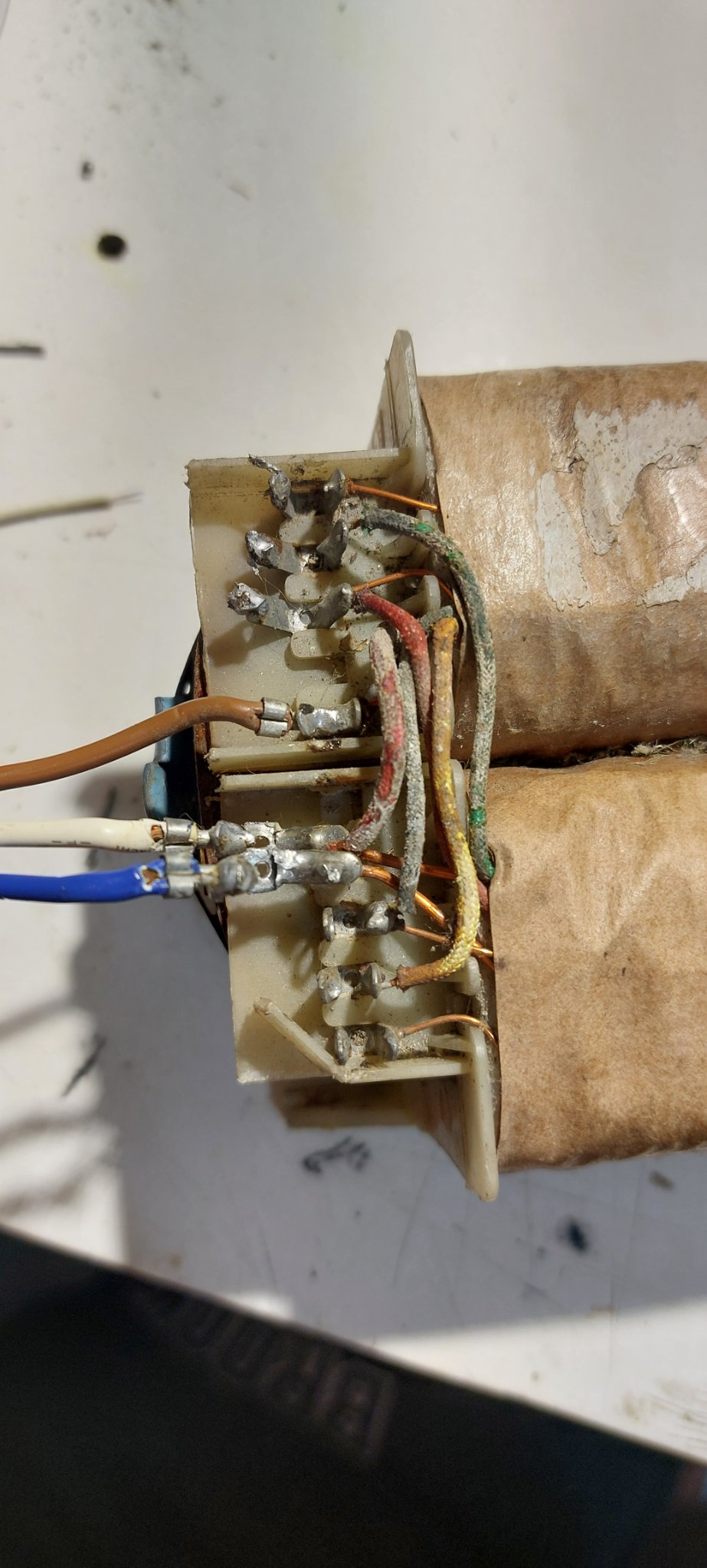

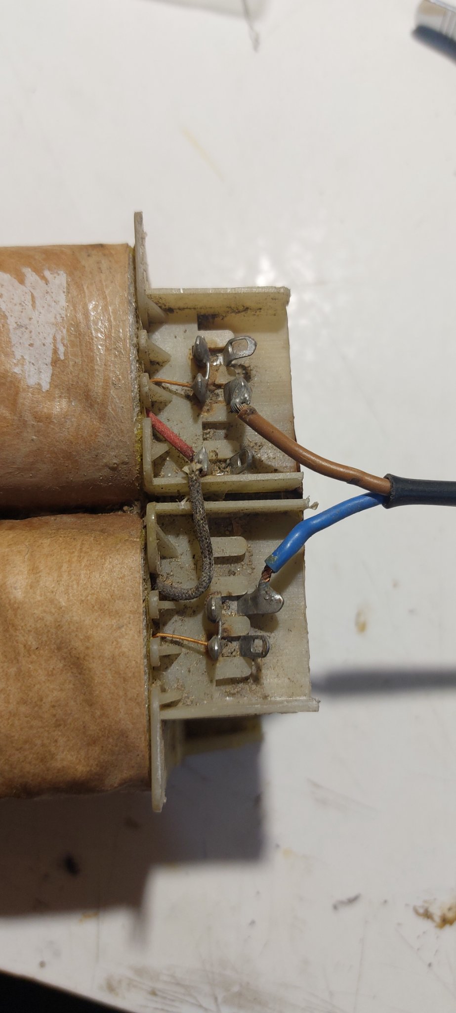

Aso, what about turns ratios among the windings?With all transformers, that depends entirely upon the guage of the windings and the area.
We know the area 3cm x 2cm what is the wire guage ... that is the question.
2x 22Vac the thicker secondariesAso, what about turns ratios among the windings?
220v primary.
Its two windings in series both the primary and secondary.
It has multiple secondaries tho.
Kind of disappointing.Perhaps something between 15 to 30 VA...
Sure looks bigger , like 100va or so. But according to the pdf yea.
