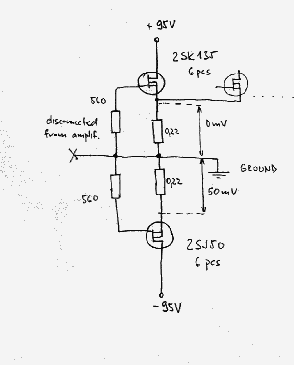

I tried to repair SR 606 and there were blown driver transistor in positive supply and two output mosfets 2sk135 and some zener diodes... I replaced driver transistor and zeners, and disconected bad output mosfets. (I havent spare ones). When output stage is disconected all looks ok... when output is connected negative supply mosfets 2sj50 leak current about 25mA each, all 8pcs about 0,2 Apms together even if gate is shorted to ground. is this sign of some typical mosfet damage?

Hi, if you have the unit running in quiescent state (no signal, no load) and using a DMM set to mV range; measure across each gate resistor in turn. any voltage drop (3mV or above) will indicate a faulty output device.

I will measure voltage on gate resistors today. I have information, that it is often happen that 2SJ50 have this small current even if Ugs=0. Is it true??
I attached schematic of my test circuit - there were voltage on 0,22 resistor on negative side...
