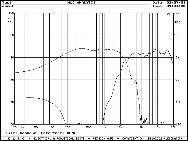

Graph is of my 2way Accuton C95 & C12 with crossover - and I'm very satisfied with the sound. Measured with CLIO at 1m, so please ignore measurement below ca. 300Hz.

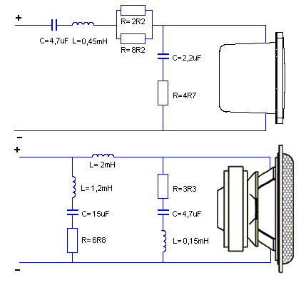

Here is how my xover looks like:
on C95 midbass: parallel 1,2mH/15uF/6R8 before 2mH in series with C95 and series 3R3/4,7uF/0,15mH in parallel with C95
on C12 tweeter: second order with 4,7uF and 0,45mH , 2R2/8R2 attenuation and series 2,2uF/4R7 in parallel with C12
speakers in phase
inductors on bass are <0,35R each (I'm using Mundorf foils)
capacitor on tweeter is Mundorf Supreme and 15uF in midbass' RLC is Mundorf PP
forgive me for not drawing the schematics

Thank you for your cross-over schematic, Vuki. I will keep this in mind if I decide to go 'passive' (although most people I know think I'm passive enough - heh, heh).
