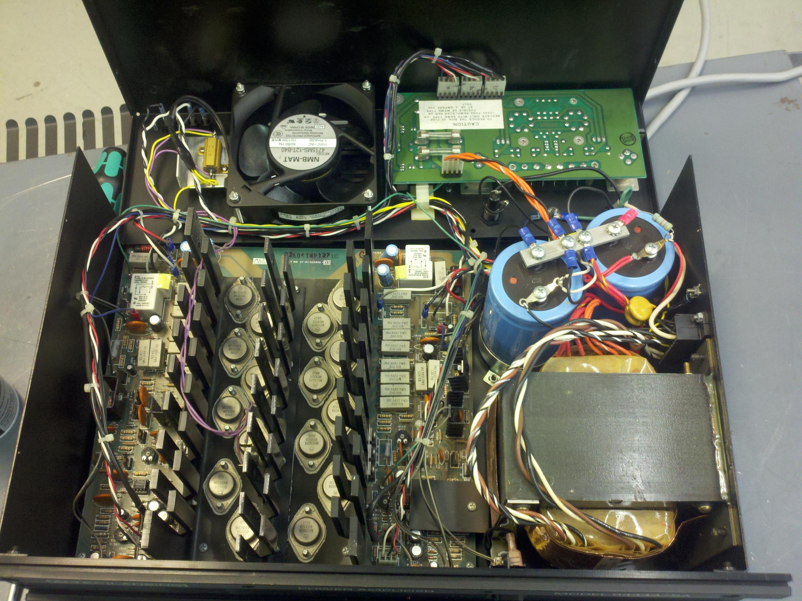

I believe what you are suggesting is what I did - I connected the wiper to the top terminal of the pot. I didn't explain it very well. I see what you are saying about shorting to the output of the op amp to ground. That would result in no output. But if I turn the pot all the way down the volume does not change. That's why I can't figure out what's going on.
If the sound level stays the same when you turn the pot, the wiper could still be connected,
and could short the op amp's output (when the volume knob setting is at full CCW).
If the center (wiper) terminal of the pot is not connected to anything at all, then it should be fine.
If the center (wiper) terminal of the pot is not connected at all, then it should be fine.
Can't do that. The output to the next stage is from the wiper connection. Correct?
You move that wire to the top terminal of the volume control. See post #2.
OK understood. Problem is that the pots are hard to get to but the circuit board is easily accessible. I have attached a photo of the innards of the amp. The input board is the small board toward the top of the photo. If you look to the far right you can see the three circuit board connections of one of the two pots. Its easy just to short two of those circuit board connections with a piece of wire.
Some connectors of that type have a tiny retaining tab that, with a small-enough screwdriver (try your jeweler's screwdriver with the 1 mm blade), can be depressed a little, while pulling gently on the corresponding wire. If you ascertain which is the wiper and which is the full-CW end, remove those and tape them together. Then you haven't done anything that can't be undone.

Good idea. I can try that without removing the board.
