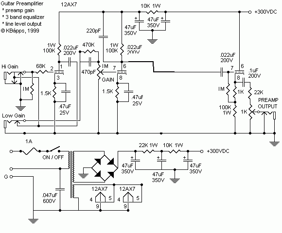

Bypass the tone control
You have a loss of nearly 20:1 through the tonestack.
There is plenty of gain through the amp as indicated by the resistor divider on the output (22K to 1K pot).
I would remove the the gain stage driving the tonestack, remove the tonestack, and connect the output of the second gain stage to the output stage.
Since there is no feedback you can get away with just connecting the 0.022uF cap that went to the treble wiper to the point that would connect to pin 2 grid of the third tube. I would not mess with the RC netword from gain stage 2.
If gain is now insufficient (not likely with two gain adjustment pots) you can decrease the 22K resistor in the output to the 1K pot to increase output drive.
I was going to say "try it like that first", but there's already plenty of gain in that thing 😱
A voltage divider would do the trick, probably best with a small cap in parallel, like the one in front of the third triode, the 470K/470pF-100K arrangement. Perhaps try it with a pot first.
PS I'm not an expert, okay? 😉
Good luck!

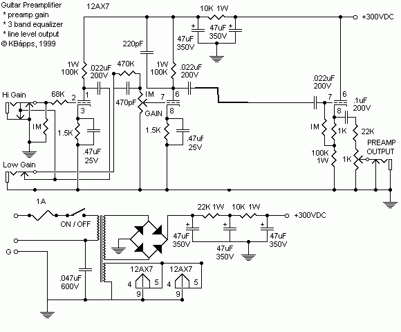

I think the gimp meant like this.
Only use one of the coupling caps. (forgot to delete one.)
