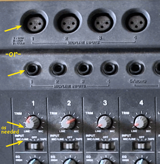

I am wanting to record to cassette. I am thinking about buying a tascam portastudio as they record at double speed. However, I will have my own preamps and don’t want the signal passing through the tascams preamps.
Are there either any portastudios that have this feature, or any known mods to bypass the built in preamps?
Does the sub-in use the built in preamps?
I can’t find any portastudios that have a line in...

You might have a problem Tascam equipment is fully logic controlled and routed and as you know programmable via an app from your computer .
Looking at those digital units "modding them " internally does not look an easy achievement --OR---
are you talking about the Tascam 488 ,now that does have a line input -100mv in the LINE position or 300mv in other LINE inputs.
So if that is your aim don't buy an all singing & dancing digital wonder buy the 488 (MK11 )
