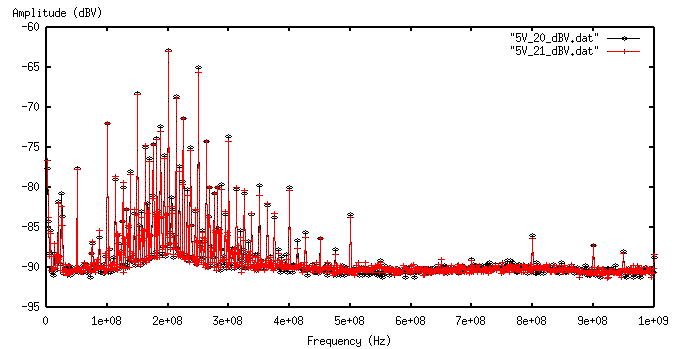

In order to get rid of this stuff, I've made some additional measurements that might interest you 😉.
I started from the last configuration I studied : 100uF/ZA/Rubycon // 33nF/X7R/0612 // 220nF/X7R/0805, this latter still being soldered on solderside. Yes, no Murata here, since it damps everything and particular effect are not easily seen.Then I stacked a 1nF/NPO/0603 on the top of the 0612 cap, just to see...
Curves below show the results without (black) and with (red) this little cap. Spectacular, uh ? As awaited, it doesn't make even a little difference 🙂. I double checked, double measured, just to find the same results. May be the configuration I tested is not optimal to reveal the effects of this cap, and I should have tried leaving the 'lytic and the NPO cap alone. But I didn't find it worth the time.

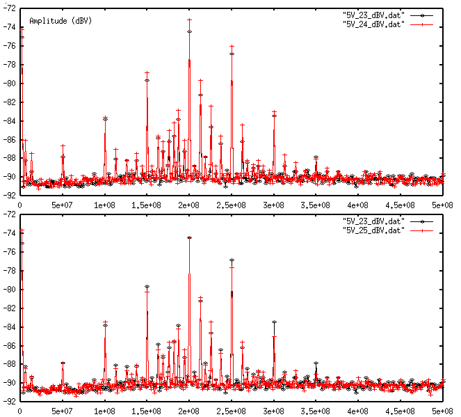

Well, what about the electrolytic itself ?
I restarted from the following config. : Rubycon 100uF/ZA // 100nF/X7R/0612 // 220nF/X7R/0805 // Murata 22uF/1210. Then I removed the Rubycon cap. The top graph of attached pic (black with ZA, red without) shows that the 'lytic doesn't seem to be necessary, a least in this application. Tiroth, you were right asking 🙂. Apparently, the Murata cap does all the necessary job. Too good to be true 😛
Just for completeness, I soldered a 120uF/25V/FC from Panasonic, and compared it with the ZA, all the other caps being the same. Little surprise here : the Panasonic, with all his surrounding friends, seems to do a better job than the Rubycon 😎 Bottom graph shows the ZA in black compared with the FC in red. I zoomed the curves between 0 and 500MHz, since nothing happens above.
Well, good news indeed. We can use a cheap FC, or even remove it ! However, I'd rather keep it : I've no proof that the configuration is not sensitive to the application. The measurements are made for a particular app, with somewhat high frequencies (nothing below 195 kHz), and as Dr. Capslock stated a little above, there may be some cases where the 'lytic is needed.
I still have one measurement to do : replacing the costly and rapidly derating 22uF/10V/1210 ceramic cap with a 4.7uF/16V/1206, which seem to be less derating at 5V, and, most of all, cheaper. But I keep it for the next week 🙂
Hope this helps a little.

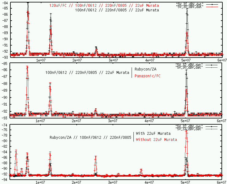

Tomorrow is another day, says the poet. I wanted to take a little rest without caps, but the brand new day found me full of energy, and as I'm almost as curious as you are, and as I had some time to lose, I switched on my favourite spectrum analyzer again.
I narrowed the bandwidth down to 60 MHz, and looked at what was going on. First, having a 120uF/FC // 100nF/0612 // 220nF/0805 // 22uF Murata soldered on the PCB, I measured them and removed the FC cap. Results are on the top graph of attached pic : with the FC (red) and without it (black). Given the amplitude levels (all in dBV), shall we say that the 'lytic has to be there ? I'll leave it to you 🙂
Middle graph compares once more the Panasonic/120uF/FC (red) with the Rubycon/100uF/ZA (black), the other caps still being the same. As I have previously noticed, the Panasonic does a nice job at minimum cost 🙂
Lastly, keeping the Rubycon/ZA, the 100nF/0612 and the 220nF/0805, I removed the 22uF Murata. Bottom graph shows the results, with (black) and without (red). No comments 🙂 This little cap won't end amazing me...

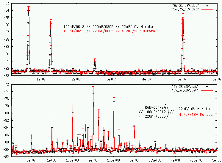

What about saving a few bucks ?
In the meantime (mealtime more exactly), I had received some Murata 4.7uF/16V/1206/Y5V. I couldn't resist to test'em 🙂 Results as usual on the attached pic. Top graph is the LF comparison of the 22uF/10V/1210 (black) with the newcomer (red). Logically, the 22uF is better than the 4.7uF, but only by a small amount. Widening the frequency range (< 500MHz, but absolutely no difference above), bottom graph shows the same behavior.
Well, I might say that if cost is not an issue, you could go with the 22uF 😉 But is the global result worth the price ? Personally, I will use the cheaper 4.7uF without any mental inhibition.
Just to sum up, the absolute cost/quality winner of my contest is:
Panasonic 120uF/25V/FC // 100nF/X7R/0612 // 220nF/X7R/0805 // Murata 4.7uF/16V/Y5V/1206
And thanks to all the people who have made the clever suggestions to improve quality and reduce costs 😉
