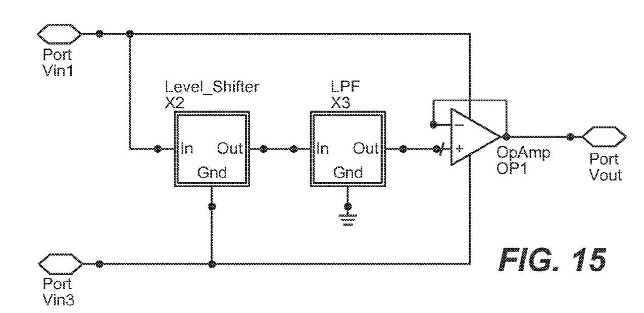

Consider a voltage source with a finite output impedance. If you want to reduce the impedance seen by what comes next there are two options: add a shunt impedance to ground, or add a series negative impedance. A combination of the two is possible. If this circuit reduces Z then that is how it does it.
If the patent is 7521990, then the embodiment for DC rail filtering appears to be this:
So basically take the rail voltage, run it through a filter, and buffer that reference voltage to a follower. Haven't guys been doing this for 40+ years already? (BTW, X2 is resistor divider or resistor-zener, and X3 is RC network.)
Maybe the AC embodiments of the patent are novel. I'm not clear what's new here.

Hi All,
After looking around for the old article, I found it hiding here with it's creator(s). See the article: Reducing Regulator Noise, or "Finesse Voltage Regulator Noise!" (as I have it here). The host is Wenzel Associates, Inc. Very kind to post some of their work for everyone.
This circuit is real, it works. You'll notice that the first implementation with a single transistor claims a noise reduction in the same ballpark as Bybee claims.
The big question now is, did Mr. Bybee rip off Wenzel, or have they come up with the same idea on their own and failed to research properly. This may sink any patent claims - depending on what it is exactly. Another point could be made that now the invention has patent protection, and plenty of cash to enforce it, the schematic could be published without fear of infringement. Fears of the Far East copying it are null as soon as the first one is sold. After all, it's less trouble to copy a working, produced unit than it is to create from a schematic.
