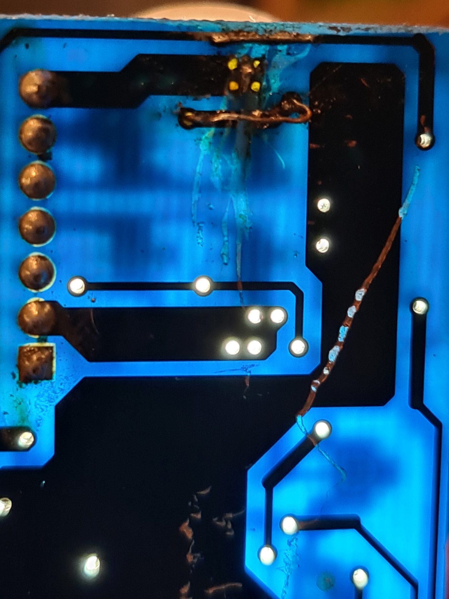

Checking the oscillation board I found that someone had intentionally cut some jumpers, I repaired these cutted jumpers and when I turned on the amplifier I already had a good square signal in the 4 banks and the mosfet irf9640 no longer got hot, I thought that at that moment, I had repaired it since I injected signal from 40 hz audio and had a clean signal at the output.

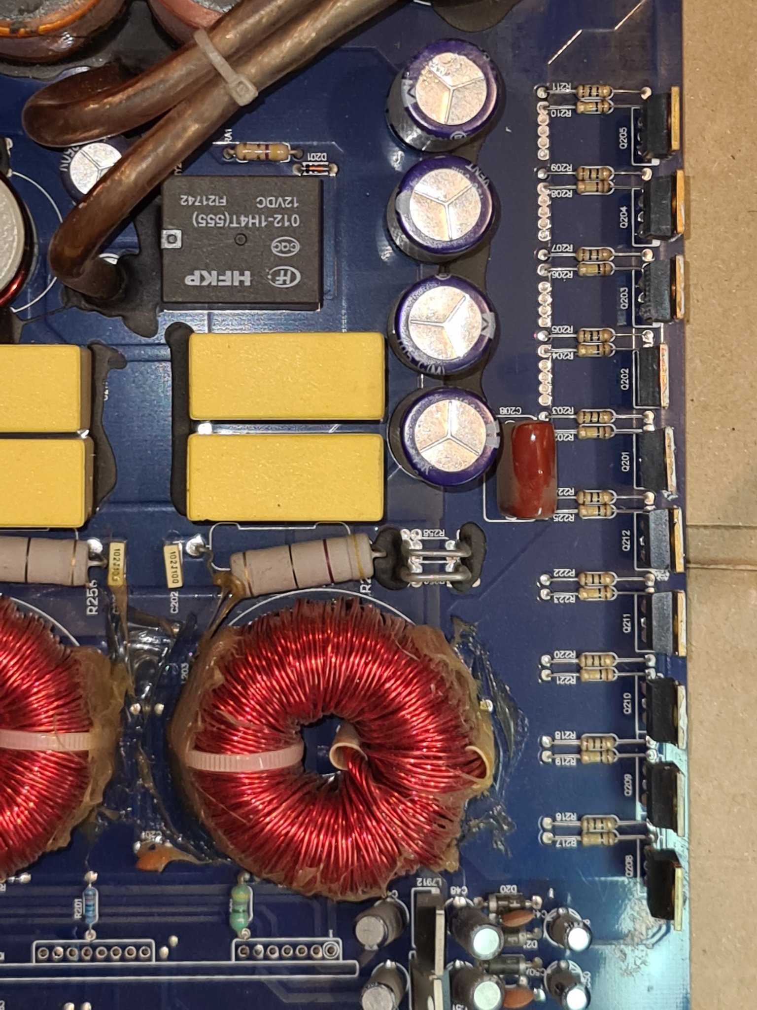

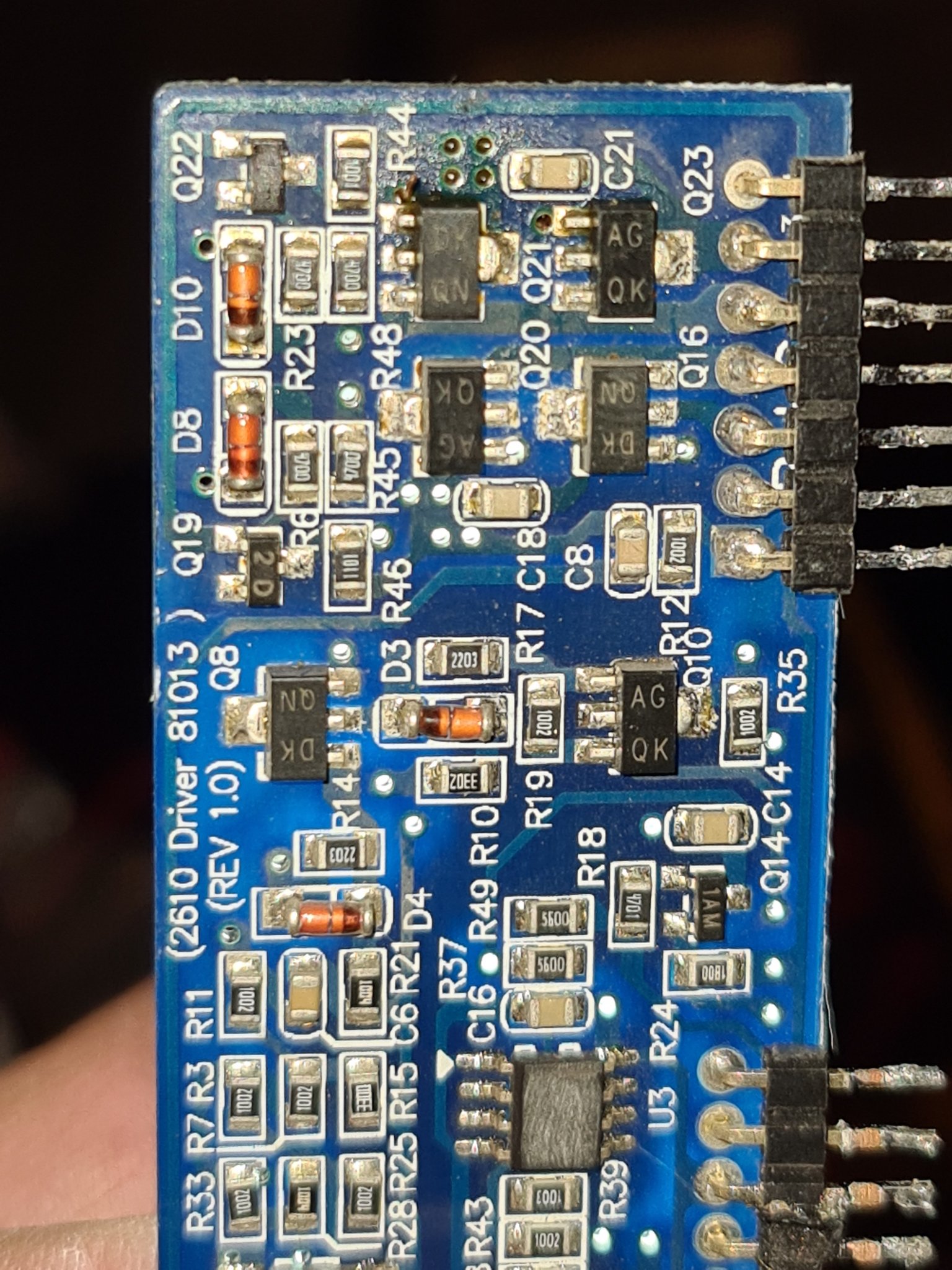

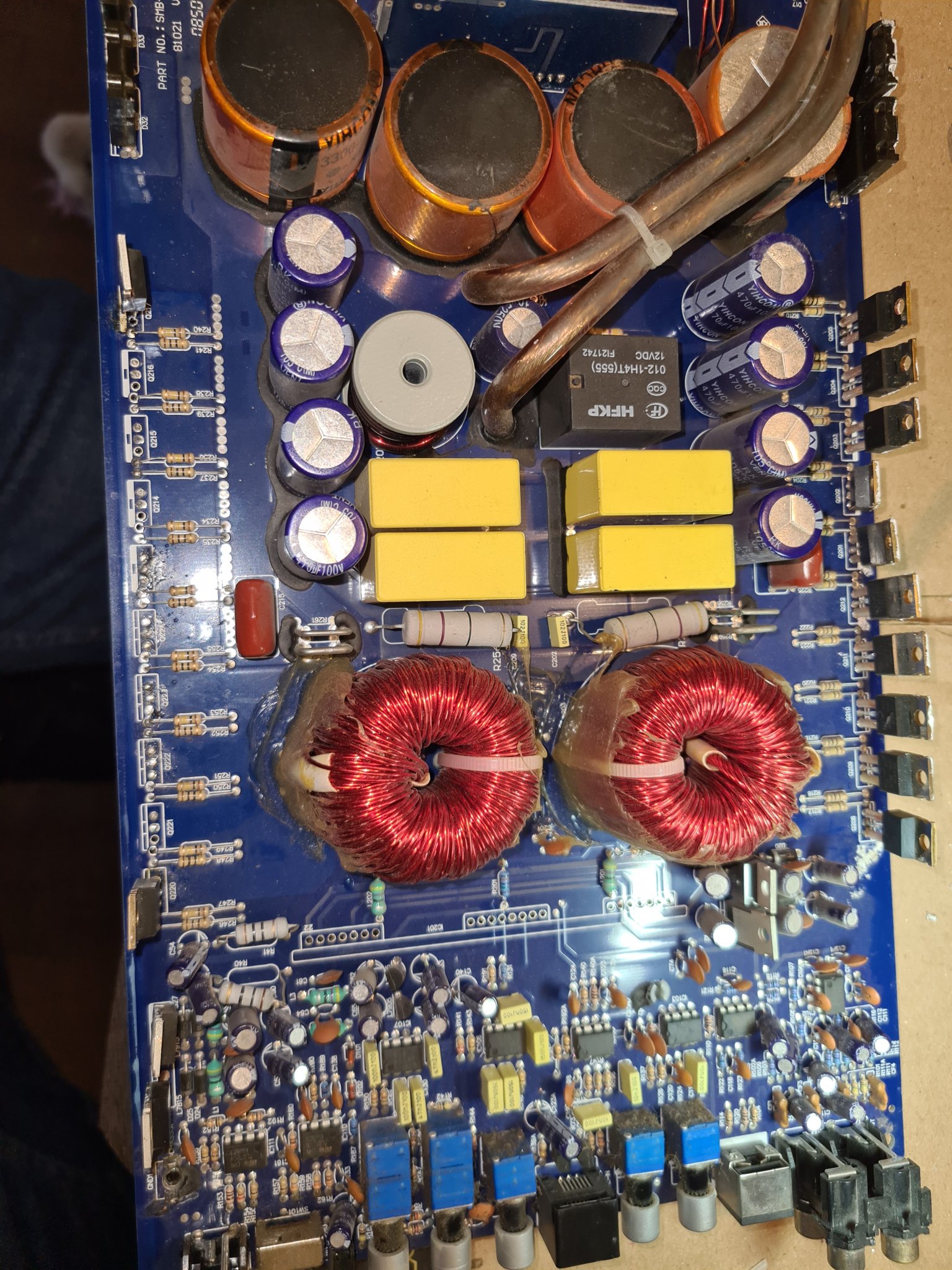

but strangely sometimes when turning on the amplifier, the original failing bank gave a bad oscillation signal again, while checking if any repaired jumper had been false, I accidentally touched the scope ground with the mosfet metal case (drain) after that the Amplifier was in protection, 🙁 when measuring with the oscilloscope in the gates, the amp tries to oscillate, it does not succeed, I know that something was damaged with that short circuit but I'm already lost, I checked the p irf9460 mosfet that was where it touched ground and it is in good condition state, check the PSU signal and mosfets of the source signal and they are working correctly, I have already removed the oscilation board , based on the short l that I am telling you, will you have any suggestions on which component could have been damaged, I already have the board disassembled, in the images you can see the paths i repaired, i think i could posible damage q20,q21,q16 or q23 .

I checked again and i detected n channel irf640 damaged, same side of the p channel bank i accidentally shorted with ground 🙁
I Will install a New fet and continúe with testings, i have the board oscillating audio board out of the Maine board, some test to this board before i reinstall it?? Thank you in avance.
Since the N-channel and P-channel Drains of an output are typically connected together, even a momentary short to Ground of either would likely damage either or both.
What useful test are you thinking of, that can be performed without the 'oscillating board'?😕
Thank you Rick, i was tryng to ask about measuring some specific values of transistors , caps or resistors for this specific oscilation little board, maybe some one tha has reapaired this board model could suggest some specific measures, like q20,q21 etc.
There is something not working correct, in the part that drives one ofvthe irf9640 bank because somethimes when i turn on the amp i get nice square wave in gates, and sometimes i get a semi square signal, with a high peak but falling in aprox 20% of duration of the cycle,
Maybe a false soldier joint a bad transistor that can not hold the loado.

Thank you Perry the board looked like it was never been remoded before, i,m going to make some test of continuity between traces and pins as you suggested.

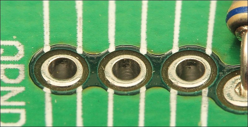

The traces aren't what's likely to be the cause of an intermittent problem. It's the copper vias that are important. You should see perfect tinned cylinders through the full depth of the board.
For your amp, you need to follow the signal back to the driver components on the driver board to see where the signal is deteriorating.
